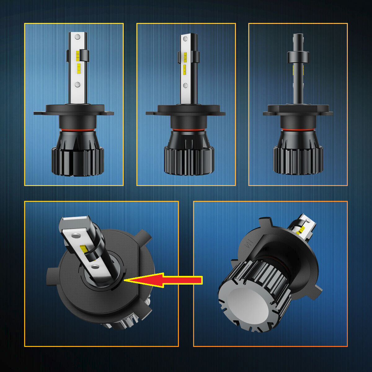

The video is only 1 year old. This June, purchased another set of LED's for our 03 Honda Odyssey. It came with a detachable base for ease of installation. After installing the base you slide the bulb / body in and twist lock. You can't turn to adjust them like the older bulbs. The industry may have self regulated in order not to produce LED's that blind or not illuminate the road.
