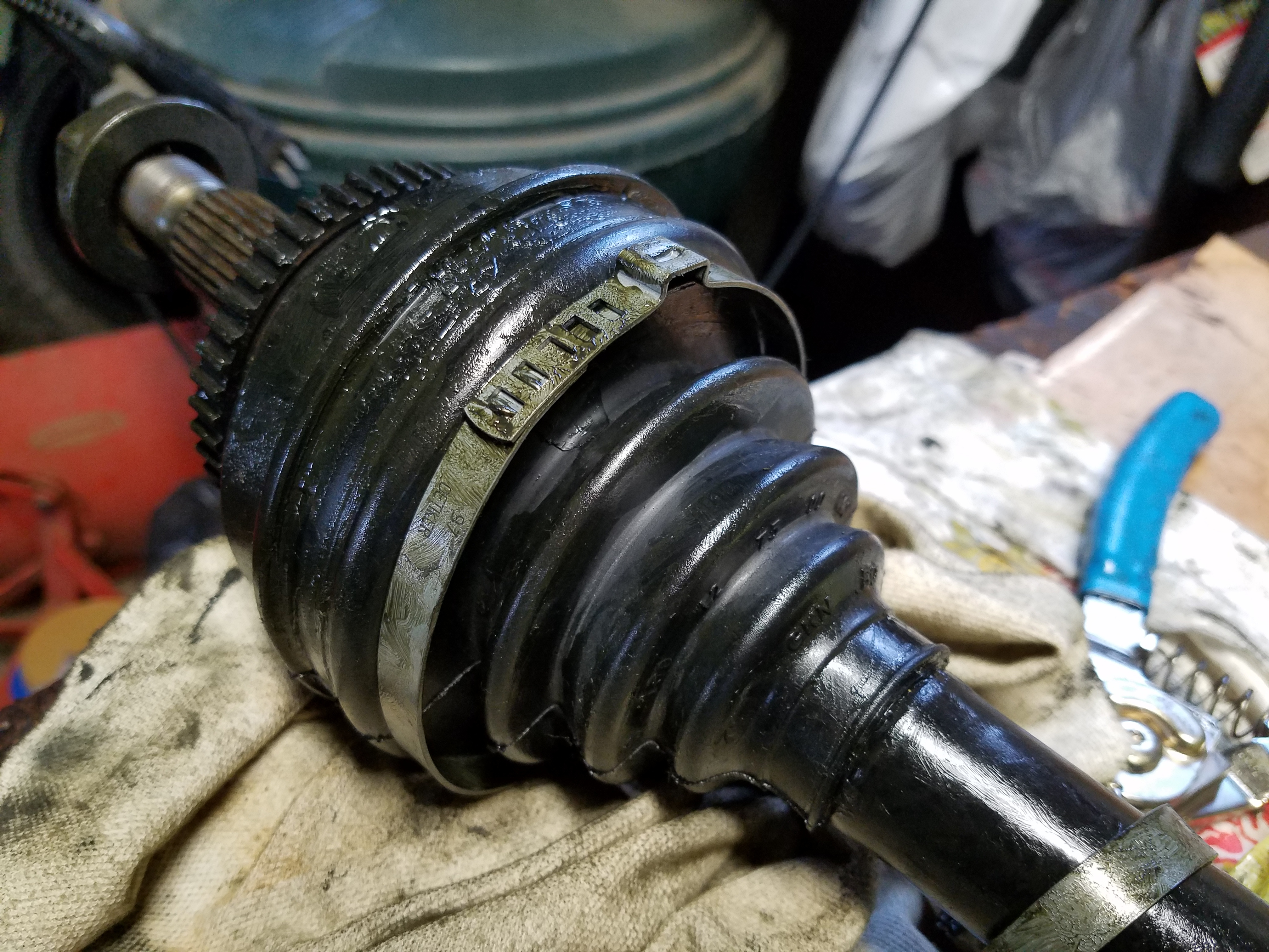

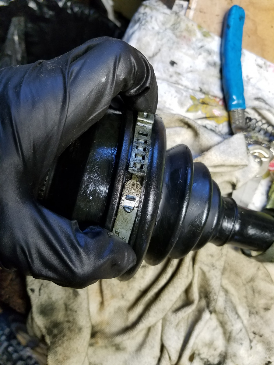

Here is another dumb question..
I bought the GKN loebro boot from fcp, went to slide the larger clamp on.
It didn't want to slide over the bump, So I release the hook and went to put it on that way and it's short? I have no idea how a person is supposed to clamp this on.
The smaller clamp appears like it will fit just fine, I haven't attempted to tighten it yet though. But I can probably pull a hook one more slot over on it. Unlike the larger clamp.
