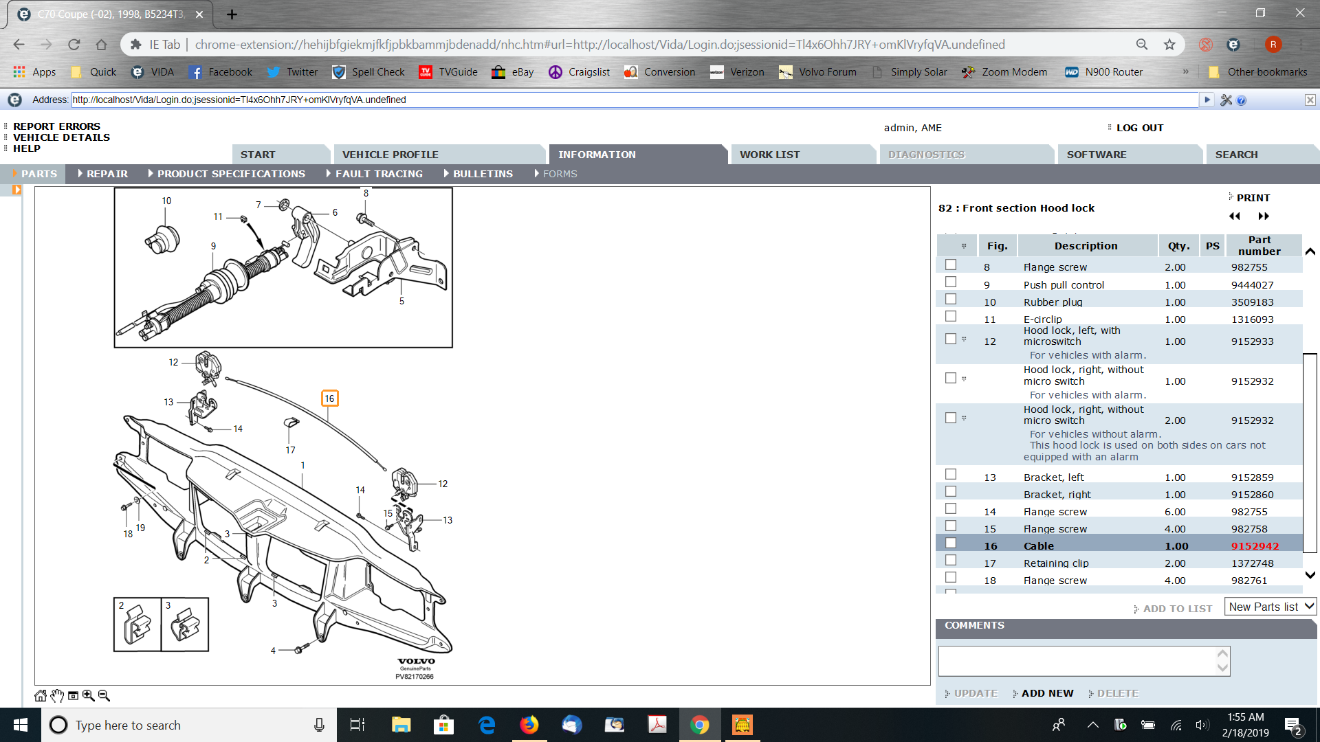

Post by erikv11 »

Is there a thread on how to lube the cable? Do you run it down from the hood latch or the dash end?

abscate wrote: 17 Feb 2019, 18:32 Is there a thread on how to lube the cable? Do you run it down from the hood latch or the dash end?
I'd go from the dash end - push out any contamination rather than pushing it further up the cable assembly...
