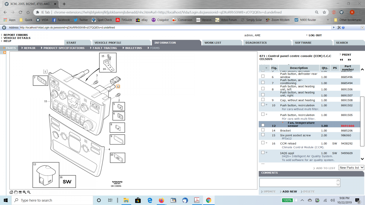

When was the last time #12 was cleaned out? Dirt and other debris gets sucked in through the vent on the climate control panel. There in a small fan in the sensor that pulls air through the sensor. If the air flow is restricted or the thermistor is dirty, the sensor will not read the temperature correctly.
Be careful the fine wires to the thermistor inside #12 are easily damaged. I suggest you remove the sensor, blow it out with your lungs and a straw then clean with MAF cleaner.
Click picture to zoom in.

RickHaleParker wrote: 22 Oct 2019, 20:21 When was the last time #12 was cleaned out?
Thank you RickHaleParker for your reply. I cleaned this sensor and I have no luck. The problem is still happening. Do you have any other suggestions?
