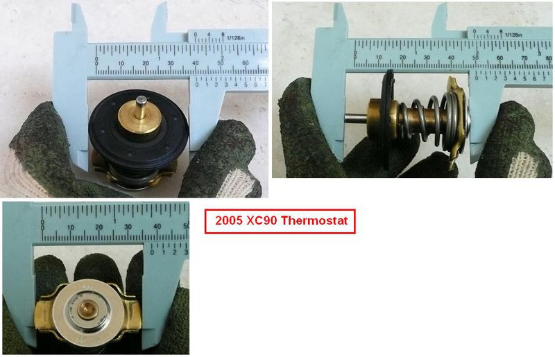

- Volvo does not sell Tstat alone (some forums say it may be Gates TH35991 which may require modification before install), instead you have to buy the whole tstat assembly which includes: lower housing, upper housing, tstat itself, and ECT sensor.

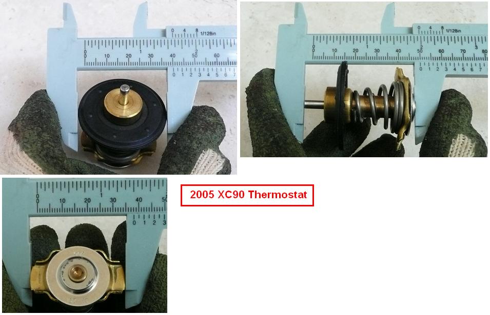

- I also took photos of the tstat itself in case anyone finds this item sold separately, please post for the sake of humanity!

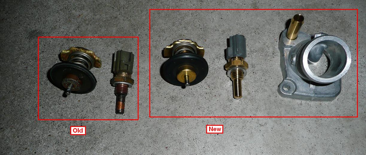

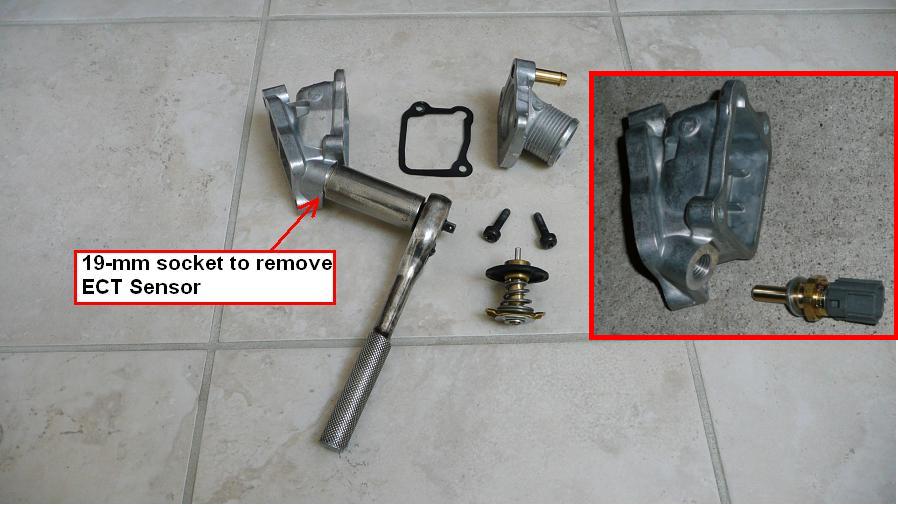

- All you have to do is replace: Upper Housing, Tstat itself and ECT (which is a good practice b/c most ECT fails around 100K-120K or so).

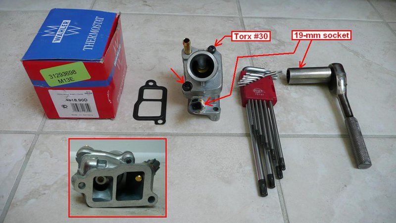

PARTS/TOOLS:
- Volvo PN 31293698: online Wahler is $100 or so, Volvo dealer is $110 or so.
- A small clamp for the small hose as it is Oetiker type and will be damaged during removal.

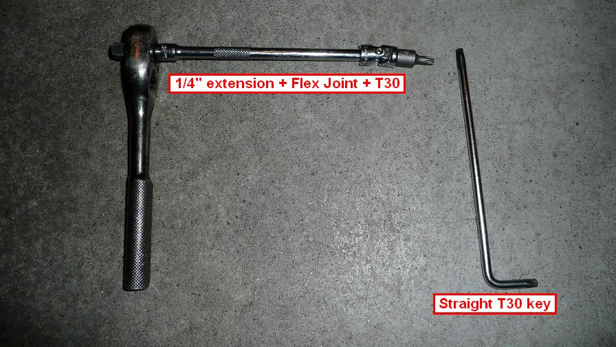

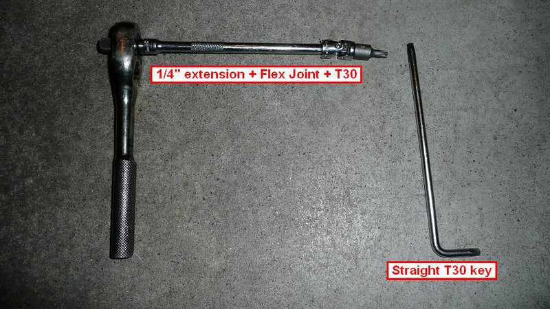

- Torx 30 key for Upper Bolt; 1/4" extension + flex joint + T30 socket for Lower Bolt.
- One 19-mm socket.
- About 1/2 gallon of Prestone 50-50 coolant.
- Telescopic magnet b/c chances are you will drop something!
- Antiseize
- Dental Floss

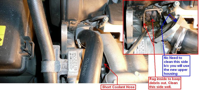

2. Spray the Bolts ahead of time with PB Blaster, then remove them.
Trick: Place a rag below to catch any bolts that fall off.
3. Once the bolts come off, stuff a rag inside so during cleaning of mating surface, debris does not get inside the housing. If you decide the re-use the Upper Housing, then clean it with fine sand paper. If you replace the Upper Housing, then undo the Oetiker clamp on the small hose. Whatever you do, these hoses form a bond and you need to slowly pry them off without damaging them. GO SLOW!

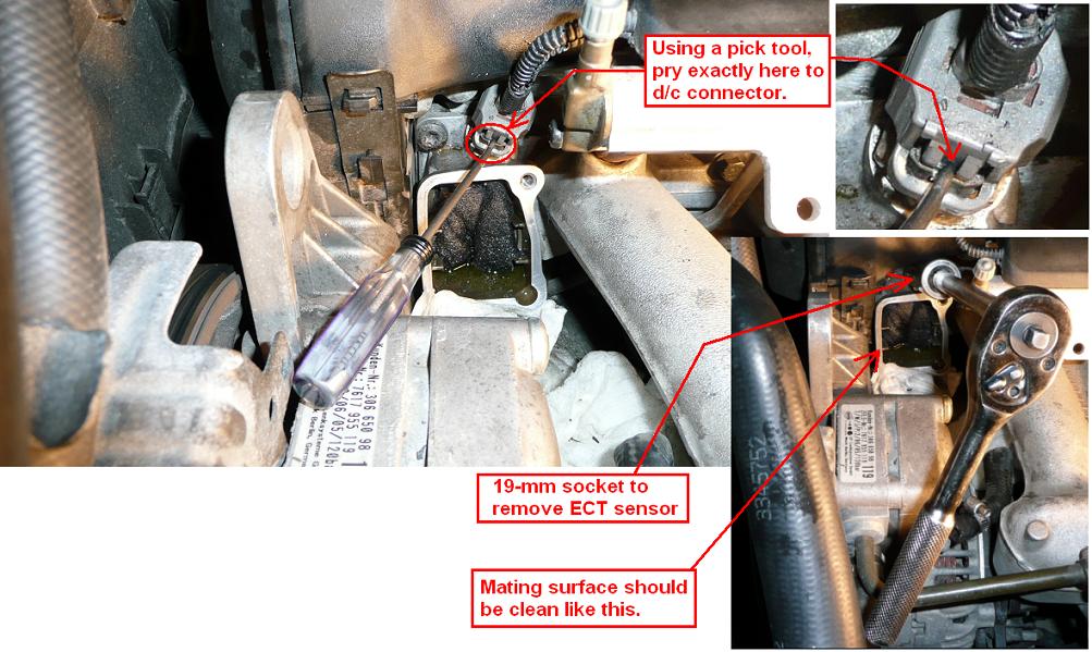

4. To replace the ECT: use a Pick tool and pry as shown (look at the new ECT sensor as a guide), then use 19-mm socket to remove it. Make sure you remove the old washer! I use antiseize on the ECT threads as well as the T30 bolts.

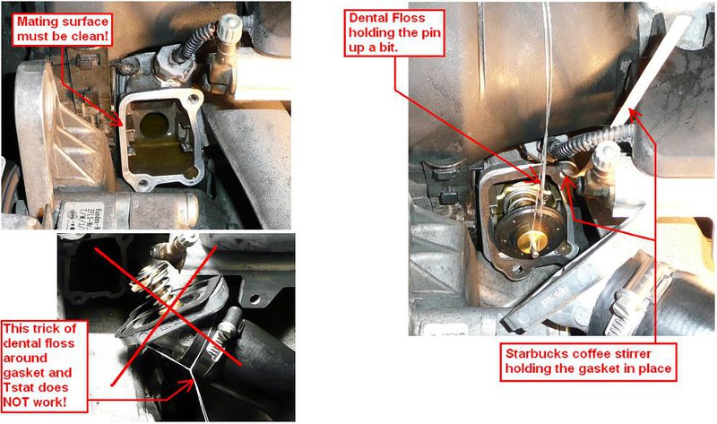

5. During install, it is VERY TRICKY b/c of the tight space but you can do it!
- Play with the new tstat and dry-fit it: you will see that even if everything fits correctly, there is a gap of 5mm between the housings. Don’t panic, it is normal: the two (2) T30 bolts will tighten it down. So, again play with the new assembly and you will see what I mean.
- First I tried dental floss around the gasket + tstat to help hold them in place: FAILED attempt (see photo)!
- Then I improvised and this worked great:
* Place tstat in Lower Housing.
* Starbucks bamboo coffee stirrer to temporarily hold the gasket in place.
* Dental Floss helps holding the tstat pin horizontal, once the Upper Housing goes in nicely with a gap of 5mm, keep pressure on the Upper Housing, then remove dental floss.
- Install the two (2) bolts, making sure the gasket sits properly.
Anyway, you will find this very last step #5 challenging but you can do it.

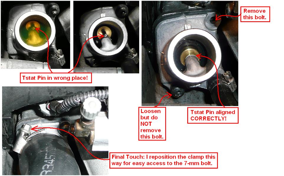

UPDATE: Test drive revealed no heat in the cabin...LOL.
Then I remember:
- I pulled on the dental floss a tad too high.
- During re-installation, I had the upper radiator hose attached (I was "lazy" and attached the hose to the new upper housing ahead of time!), so I didn't have a clear view how it came together.
No worry, easy fix:
1. If you replace the tstat this way (w/o removing PS Pump), make sure you leave the upper radiator hose UNATTACHED during re-installation so you have a clear view of what is going on.
Always play with the new parts to have an idea how it fits together.
2. For me the fix was easy: to minimize coolant loss, I used a rag and vise-grip and GENTLY clamp the hose from reservoir. Then 7-mm wrench to release the clamp.
3. Once the upper radiator hose is out, it is obvious that the tstat pin was in the wrong place!
- I loosened the LOWER bolt a few turns, but do NOT remove it.
- Remove the UPPER bolt.
- Adjust so the pin is dead center.
- Check to be sure gasket is still in correct place.
- Re-install bolts, then remove rag + vise-grip and refill with coolant.
Test drive the car.
So, if you leave the upper rad hose unattached during re-installation, it is a very very easy job!

Re mixing new parts and old parts: no worry!
I also have a 1998 Volvo S70 GLT with 185K miles: The setup is similar: Upper and Lower Tstat Housings. The only thing new in that car is thermostat every 70K miles and the ECT was replaced at 110K. Other than those 2 items, the Upper and Lower Tstat Housings are still stock at 19y/185K later.
Absolutely no leak.
BTW, I keep the remaining parts (Lower Housing and the metal gasket for the 2005 XC90), just in case I need it later, but I doubt I will ever need to use these parts. The experience with the Volvo 850, S70 showed that the Lower Housing and the metal gasket lasted some 300K miles.
If I have it my way, I'd rather buy the thermostat and ECT separately, but that is not an option for the 2.5T engine, unless someone comes up with an alternative. This is why I bought the whole assembly by Wahler and used ONLY what I needed.
