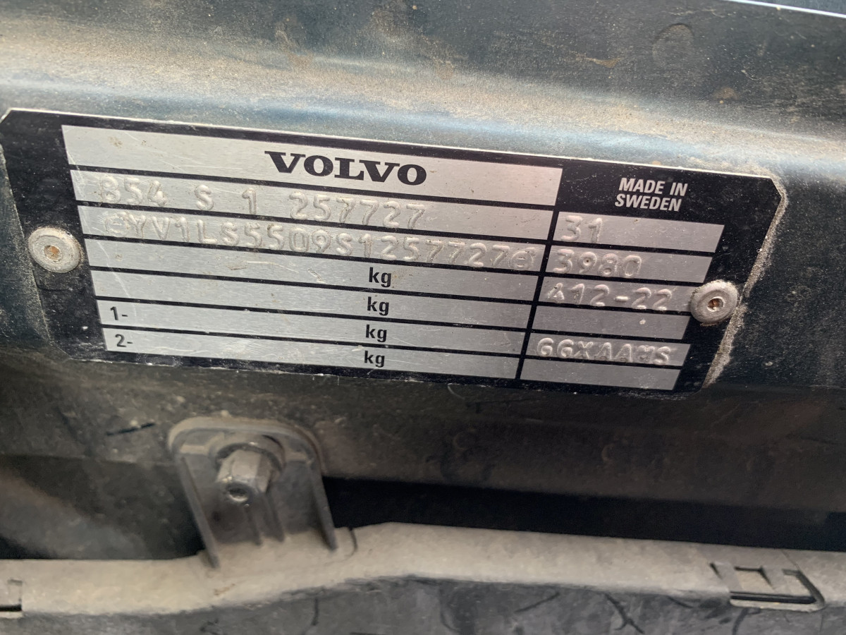

viper69 wrote: 04 Nov 2019, 16:46 How could I learn the color code?
Product ID plate: Second column, third line down, #9 in the image below.
Get the numbers and post them here.
My guess is 422 Turquoise pearl.

RickHaleParker wrote: 05 Nov 2019, 04:05
I took a look. The color code is 412-22
The 4 looks like a triangle more than a 4 though
See attached

Turqouise pearl is completely different, it is a blue that no one with color vision will mistake for a green.
412 is tropic green metallic. The link I gave you also includes all of the paint colors.

Now that you know the paint code and name. You can head to the local PPG dealer and have them mix you a rattle can of
Volvo 412 Verdigris / Tropic Green metallic and then repaint your mirrors.
The Interior code is the number right above the paint code.
You have 3980 which is Oak.

RickHaleParker wrote: 05 Nov 2019, 14:09 Now that you know the paint code and name. You can head to the local PPG dealer and have them mix you a rattle can of
Oak? Odd because the leather is almost the color of the body paint- always has been. Definitely not any shade of tan or brown etc

viper69 wrote: 05 Nov 2019, 15:50 Oak? Odd because the leather is almost the color of the body paint- always has been. Definitely not any shade of tan or brown etc
Somebody may of swapped interiors. How about a picture of the interior.
PS: Found the 850 interior code breakdown. 3980 breaks down as
850, Leather, Light Gray, standard.
Volvo 850 upholstery code.
First digit: Car model, in case of the 850 it’s always a 3.
Second digit: Upholstery:
2 – tricot & plush
3 – tricot
5 – plush (with vinyl sides)
6 – velours
7 – plush & leather
8 – leather & suede (alcantara)
9 – leather
Third digit: Color:
3 – blue
4 – red
5 – beige
6 – light beige
7 – gray & dark gray
8 – light gray
Fourth digit: Serial number or variation number. In most cases it’s a 0. Special versions of the upholstery can have an other number here.
