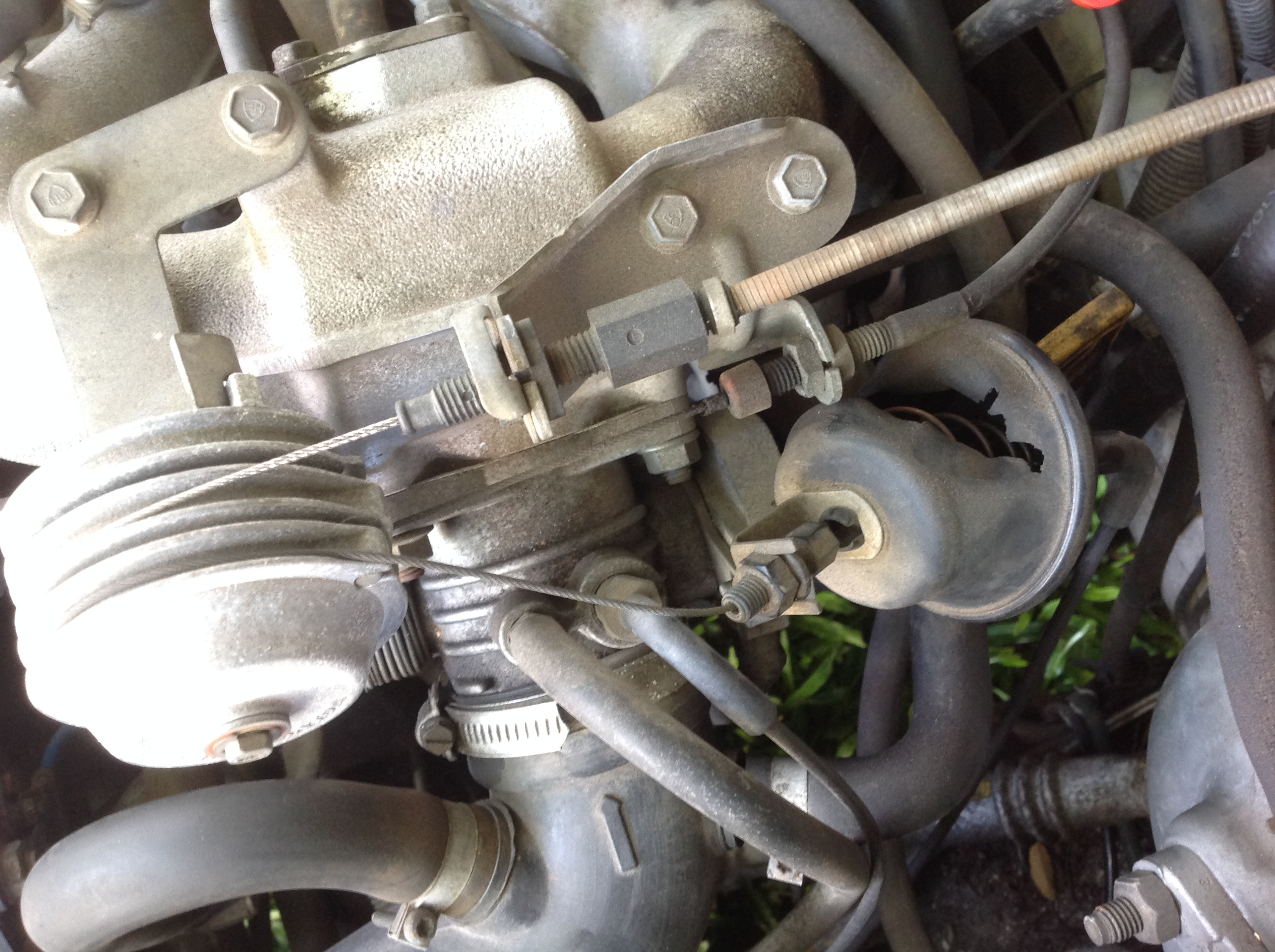

I can't seem to find any info on this part which I recently noticed had torn.
Can anyone tell what it is, what it does, how it works?
I think Ill just remove it so the spring doesnt fall out.
What is this thing on a 940?

Looks like part of a cruise control. June

Here's a diagram that might help:
Vacuum Unit - Volvo (1273227)
https://www.volvooempartsdirect.com/oem ... wtbDYtZ2Fz

Cruise Control Actuator - Volvo part number 1273227.
