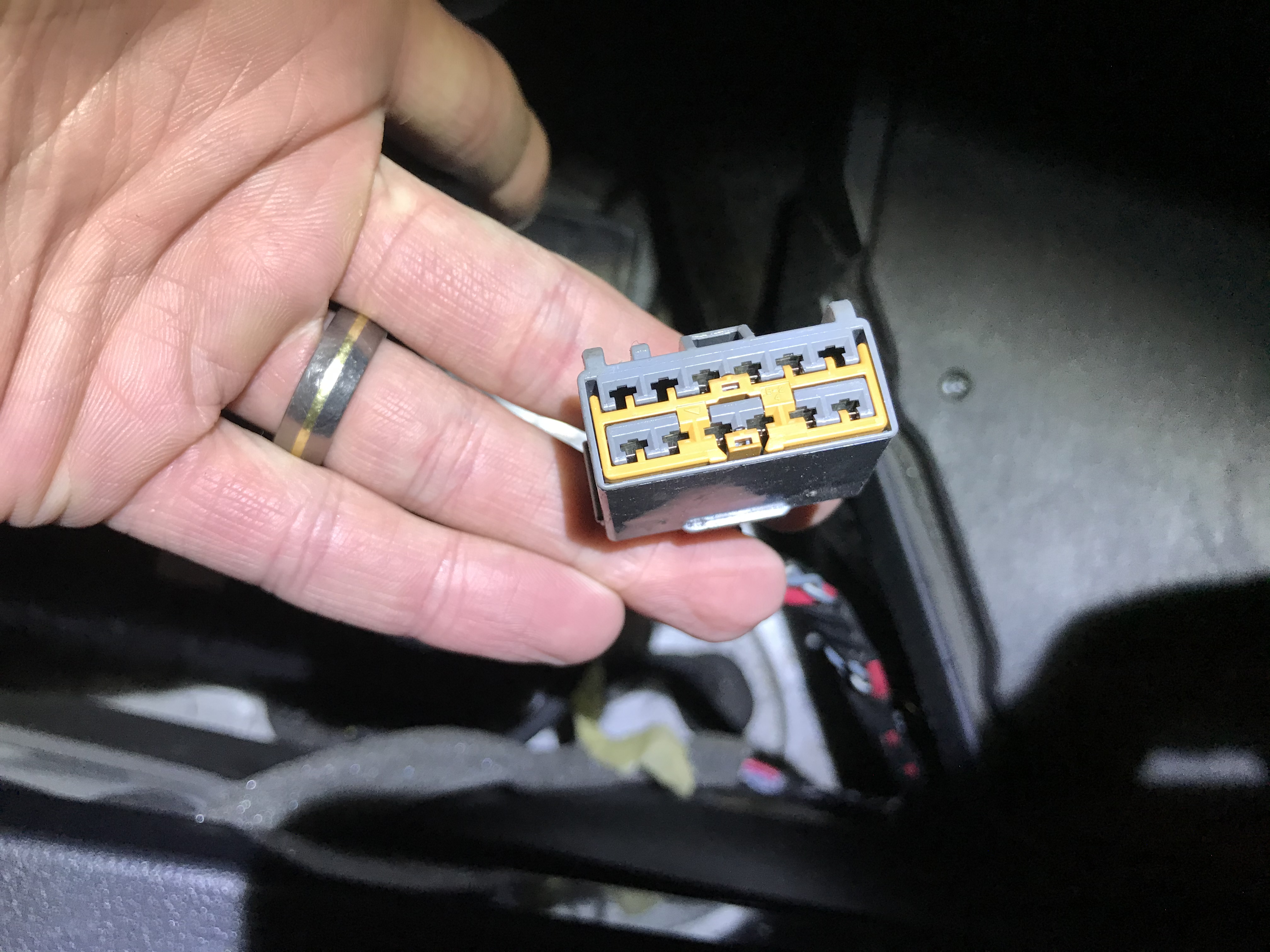

If not, look in your boot under the floor boards. Supposedly (some (and by some, I'm guessing non-3rd row variants)) 01-04's came prewired for the factory subwoofer Volvo offered. I checked our non-3rd row 06 XC70 before I sold it & it had no prewiring. This parallels what I've read for 05-07's. 01-04's, some had it, some didn't. But 3rd row vehicles couldn't accommodate the factory sub.
My assumption is that the 01-04 non-3rd row wagons came pre-wired, as they could accommodate the amp/subwoofer/enclosure.
I can post a terrible picture of the plug to help you figure out if your vehicle is prewired for a sub.

thank you for the info, yeah, unfortunatlly i cant find that in my 2004 xc70 trunk.- Pete - wrote: ↑15 Nov 2019, 23:04 Do you have 3rd row seating?
