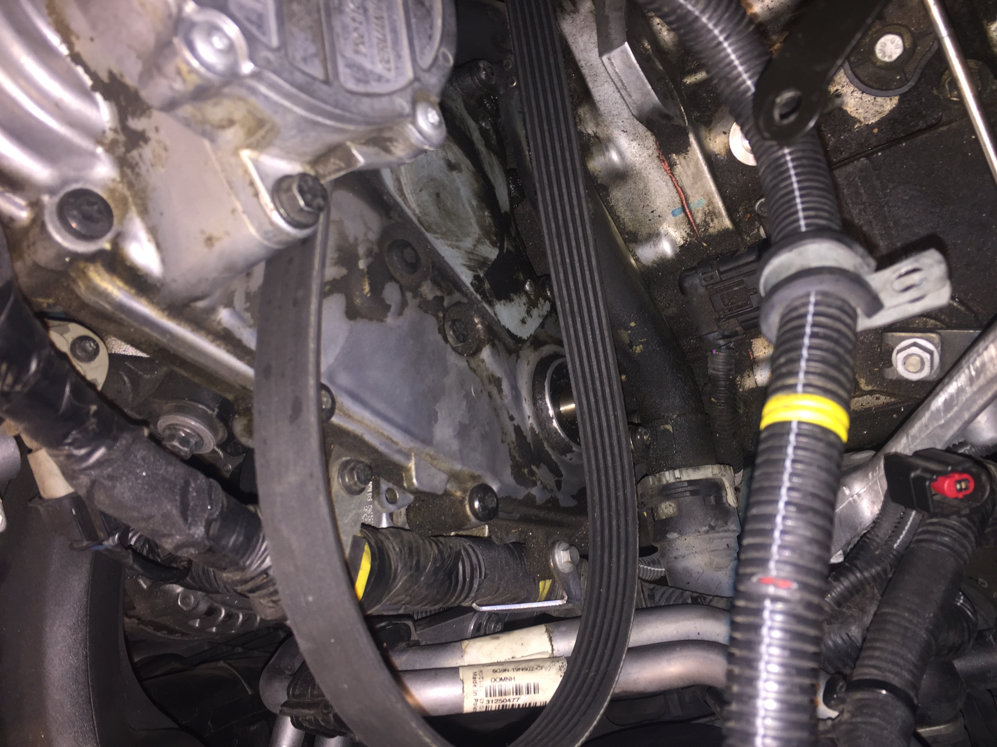

At the same time that I replaced the compressor I also replaced the overdrive pulley.
I did this because the old overdrive pulley wasn't allowing the one way clutch action.
It was frozen in both directions.
After putting everything back together I did notice that the belt now moves easily in one direction (engine off) and it doesn't move in the other direction.

The view from the engine bay with everything removed
