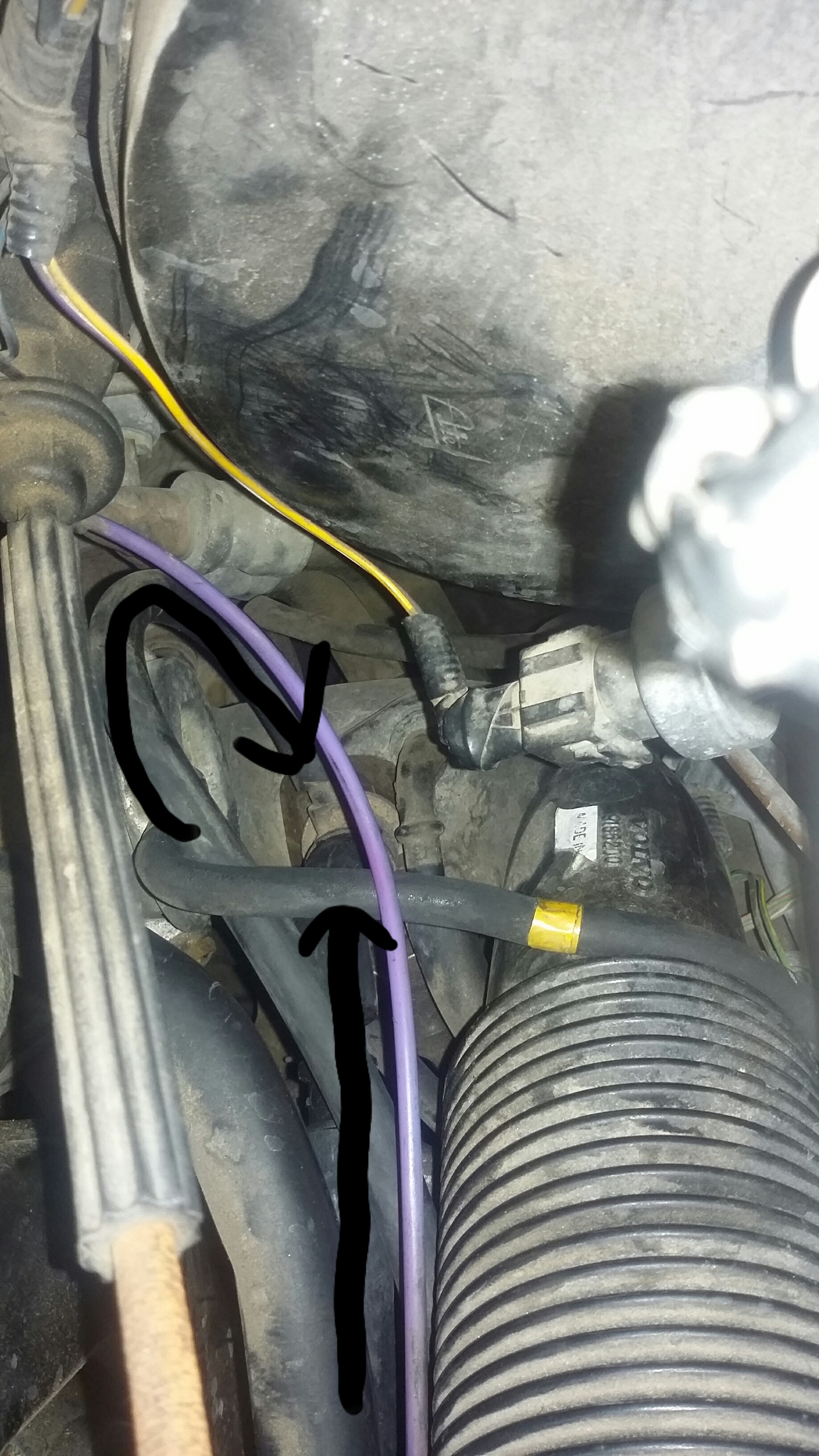

Ok! I finally have that hose hooked up correctly to the vacuum tree. Next I have a pic of 2 loose hoses. The first one is the curved one by the turbo that I have sitting by the throttle body. Does this one go to the IM on passenger side? The second one I found under the air box.erikv11 wrote: 17 Nov 2019, 15:47 Hose on passenger side of the intake manifold goes to the PTC nipple down by the turbo.

One of those hoses (pics seem out of order compared to your description)
is connected on the back end of the TCV (turbo control valve). It goes to a nipple the fresh air intake hose. It is hard to see but it is also in the thread we keep pointing to viewtopic.php?t=63615, in this pic left side top right corner
Here is another pic, it is the blue hose
There is a place on the corner of the airbox to hook in the TCV, so it isn't buried underneath there.

Yes, the other one goes to the nipple on the passenger side of the intake manifold, you can see that in the thread we keep pointing to viewtopic.php?t=63615

1. I need clarification on this because there are 2 hoses parallel/valves next to each other. In pic #1, is arrow #1 or #2 the ptc? I'm pretty sure Robert DIY on YouTube would say #1 is ptc. He mentioned to clean the ptc valve that the PCV hose goes to.erikv11 wrote: 17 Nov 2019, 18:33 Yes, the other one goes to the nipple on the passenger side of the intake manifold, you can see that in the thread we keep pointing to viewtopic.php?t=63615
2. In pic #2, arrow #2.1 goes to hose on arrow #2 in pic #1. I recognized hose on arrow #2.1 because I pulled that off of the pass side of IM. But the section from IM to the other end broke, and that's where I think I lost it and didn't know where the other end was at.
Now I remember I pulled off that hose (the one I marked with curved arrow) from two posts ago from the front of IM.
#3. As you can see in pic #2, there is a hose connected to the fresh air intake nipple. I can't find another place that the stray TCV hose goes to. There are already 2 hooked up down by the turbo.
