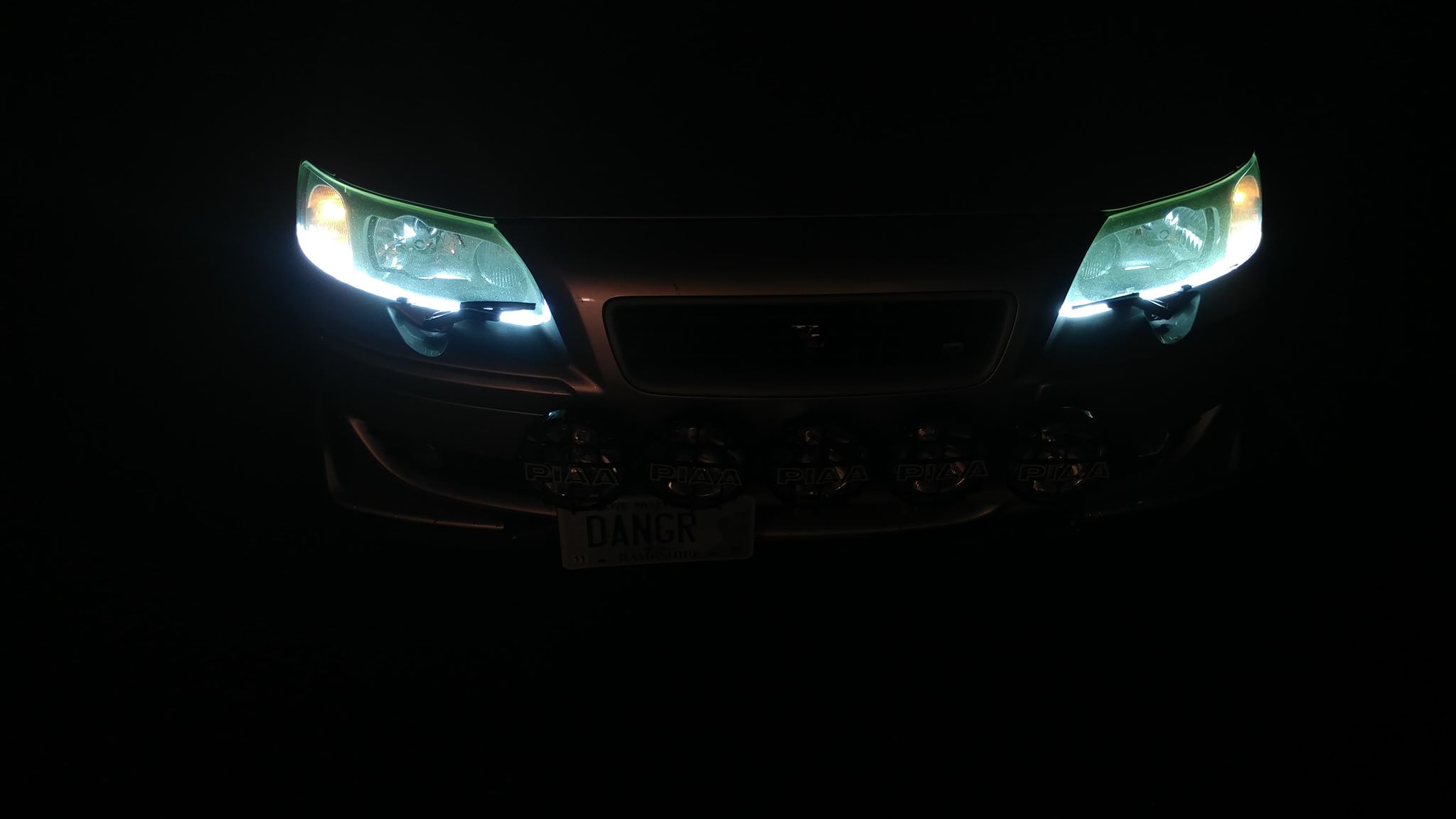

I have done my headlights in a similar fashion. It's an R, and I did not feel like cracking open the headlights. I mounted an LED strip below the headlights to get an interesting effect, and they also turn to sweeping amber with my blinkers. I had to cut the position lights, and blinkers, as it's 3 wires going to them, figure out what one was what, then resolder and heatshrink them with this in line, as the wire for the LED strip was too small for a splice connector.Mountainman45 wrote: 16 Nov 2019, 14:09 Will this work on headlights as I'm DYING to do this to my V70XC
I used these for the effect
https://www.amazon.com/gp/product/B07PJ ... UTF8&psc=1
