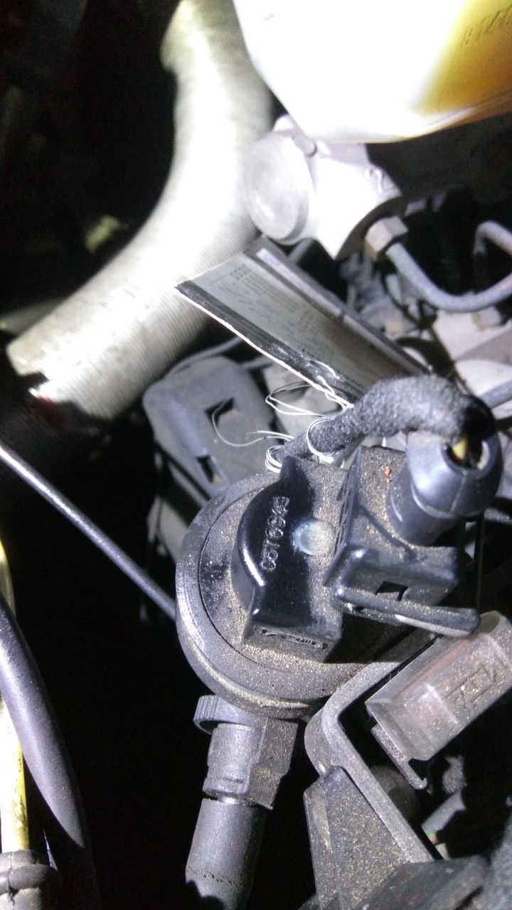

I've found a hose which is not connected that's coming from this part:

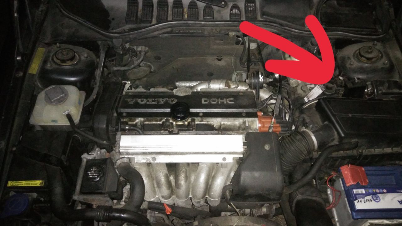

Unfortunately the part number is worn and not readable. I also couldn't find a detailed overview of the parts in the engine bay, where it would be mentioned.

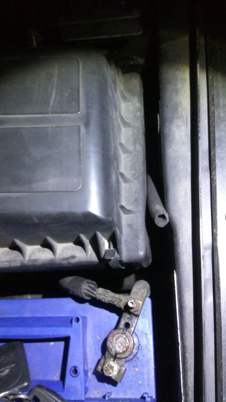

The hose ends at the right side the air filter box.
Can someone tell me what this part is and where the hose is supposed to go normally?
It's a 1996 Volvo 850, 2.5L 10V 106kW.
Thanks in advance.
Unknown part with disconnected hose

It looks like one of the air box hoses that control the hot air flapper.
Look for two fittings on the rear of the air filter box and see if one is open without a hose
There are also cruise control hoses in that area, those go under the air box , I believe

+1 for hose coming round that side of box being cruise vacuum motor line...
Or
From the bottom nipple of air box flap control just been tucked out of the way...
Or

I was able to find out what it is now. It's neither for the hot air flapper nor the cruise control, but for a cold running regulator which did not come with the car but was added afterwards to achieve a better emissions class (Euro2) so the car costs less in taxes.
The vacuum hose that connects to nothing actually connects to nothing, it once had a small air filter piece on the other end, where it pulled in the air that this valve lets through while the motor is cold. There are also variants that use the air filter of the car but there's no hole drilled in for this one.
