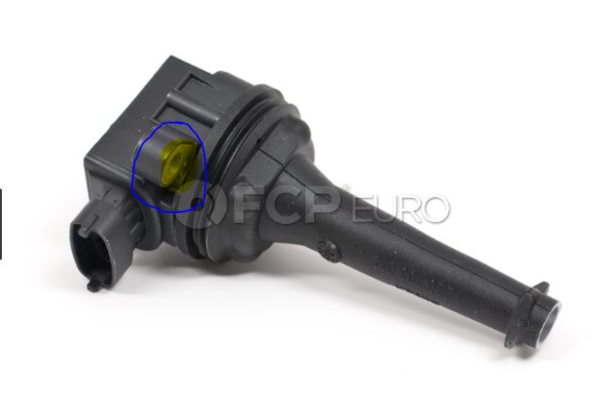

Leave coil hooked up - think it's a 4 or 5 pin connector... Then place a ground wire to the spot circled in blue, and also place one to the outside of the spark plug to ground. When cranking, you should see a bright spark. Don't run one to the X marked location - center electrode or you'll never get a spark.

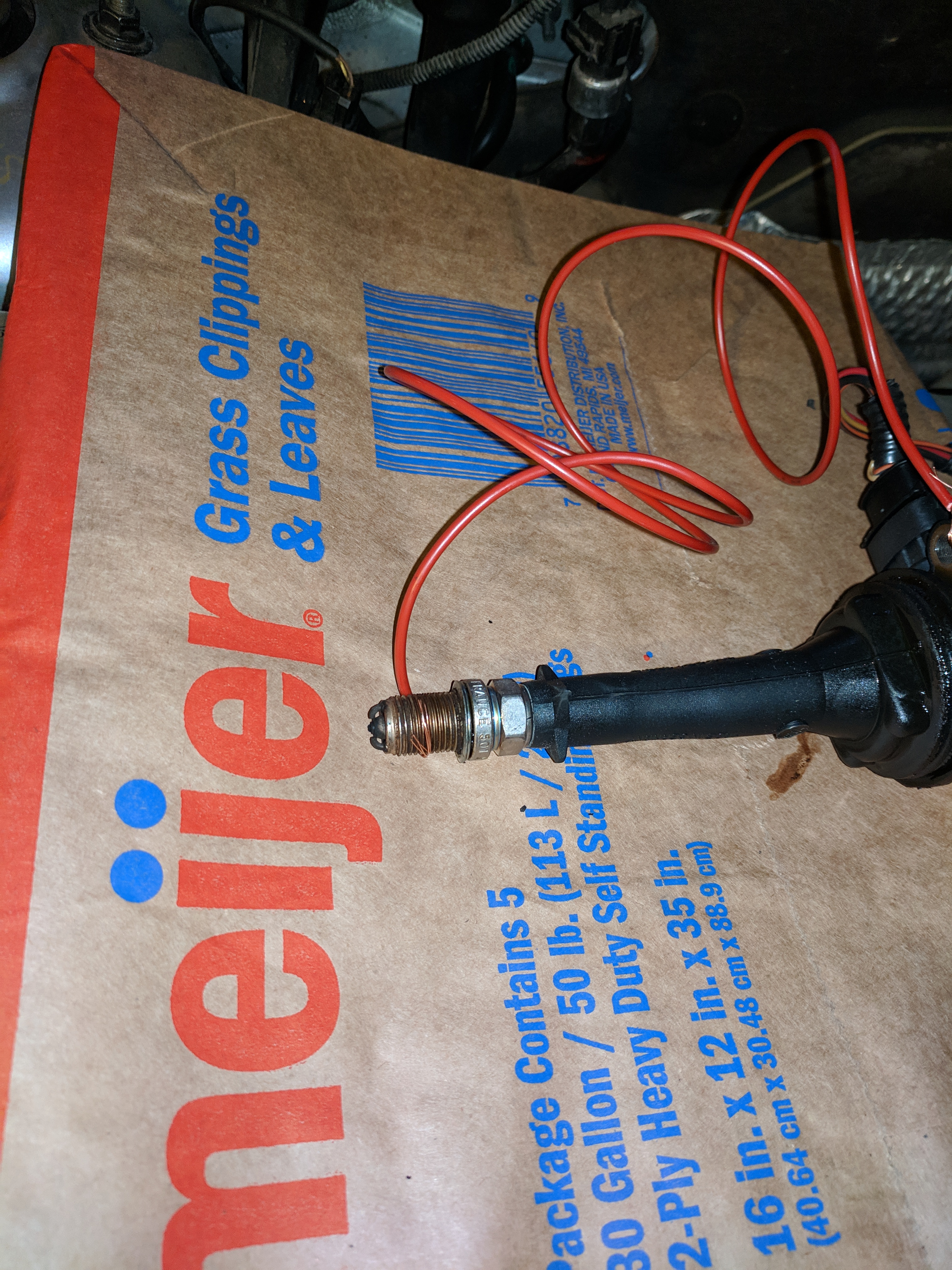

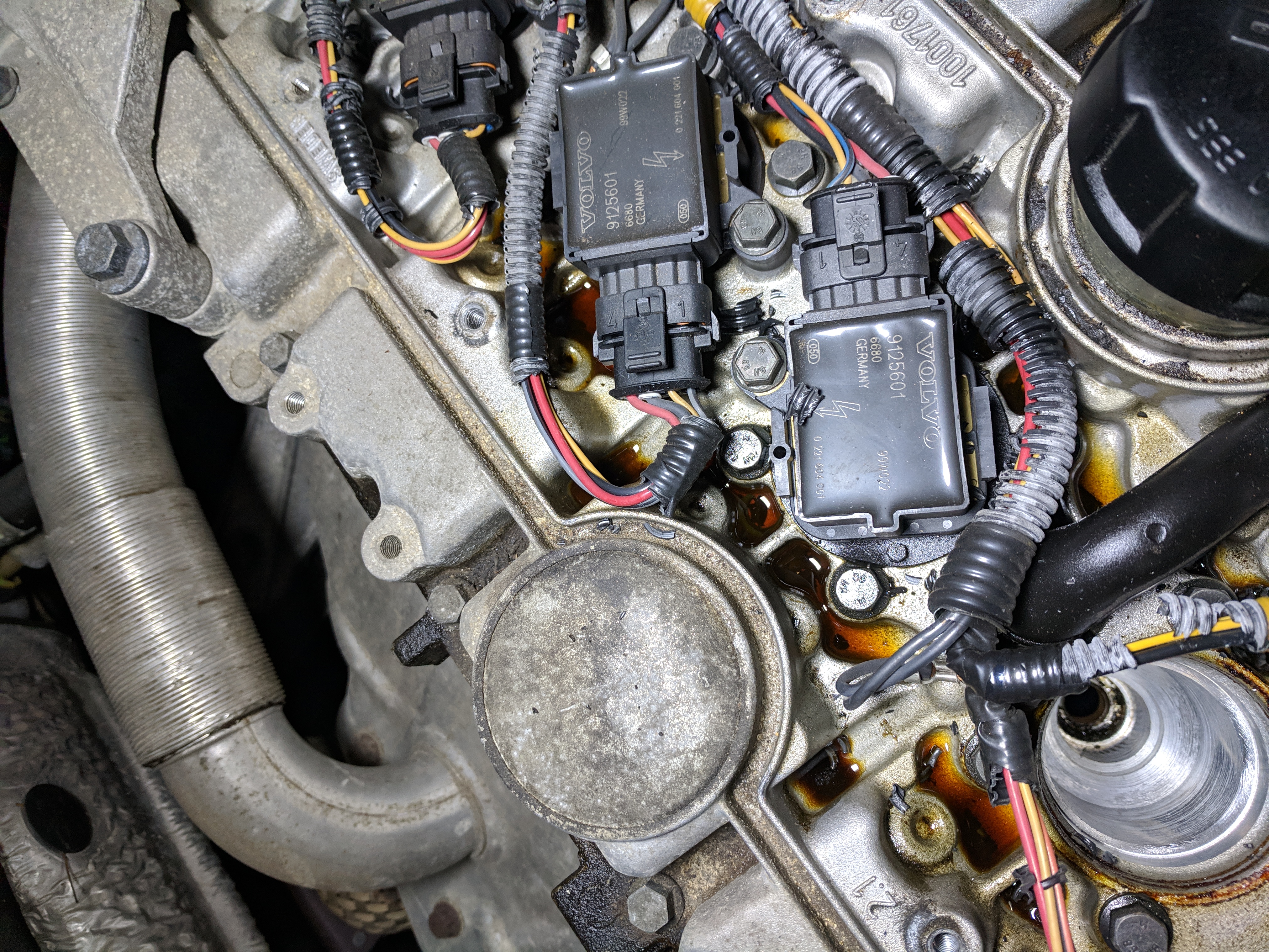

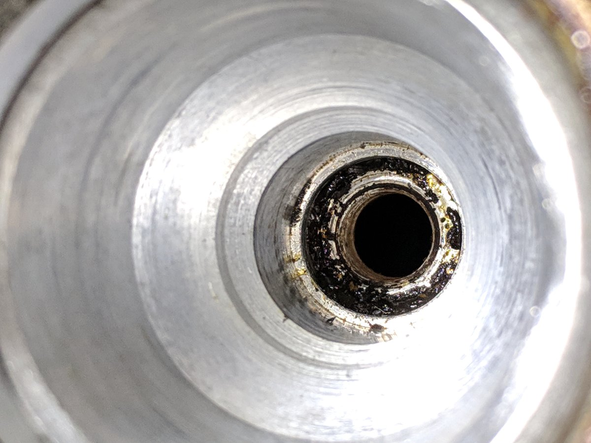

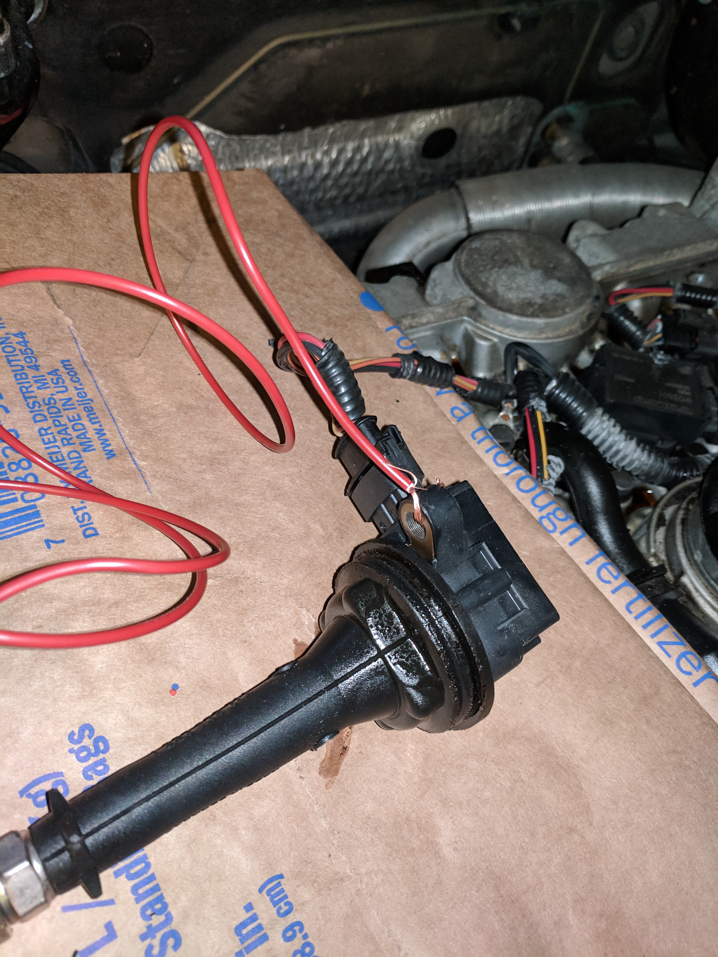

Below are the pictures of how I hooked it up, let me know if that looks right or completely wrong, haha. When I cranked it on two separate times I couldn't see a spark. Also, when I removed the engine cover I noticed a noticeable amount of oil. Not sure if it's from a bad oil cap seal or something else. I also noticed some build up where I took the spark plug out. Does that look normal for an older car? Or could that be a sign of something worse?

Make sure the other end of that wire is clipped to a good ground on the car, such as a metal piece of the head. Then give it a go. If you get no spark, my first thought would be the immobilizer - others with far more experience may know more.

Looks like small oil leak on top of head, no big deal. Odds are the seal in the oil cap is dying or the PCV needs servicing - wouldn't worry about either at this point.

Yeah , you have grounded your spark plug to the coil ground. That ground has to be attached to the engine block somewhere
