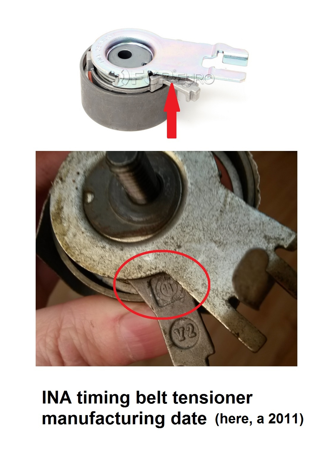

For the tb tensioner, the INA ones actually have the manufacturing date stamped behind the small temperature needle. Of course, the tensioner needs to be removed from the car to see the date, but this is not that hard - if you can find a bud to keep the tension on the belt near the tensioner while you pull the tensioner out, you can remove it and place it back (and adjust it of course). I've actually did this alone and it worked fine (swapped the tensioner without removing the belt) - only really careful not to let the belt slack or it drops off the crank pulley teeth and then it has to be put back in place (lift the car, remove wheel, cover, etc)
As cn90 says, you can also take a peek at the belt by tossing the left upper cover - actually, just undo the front metal clip and push the cover to the left, with flash light you can see the belt
