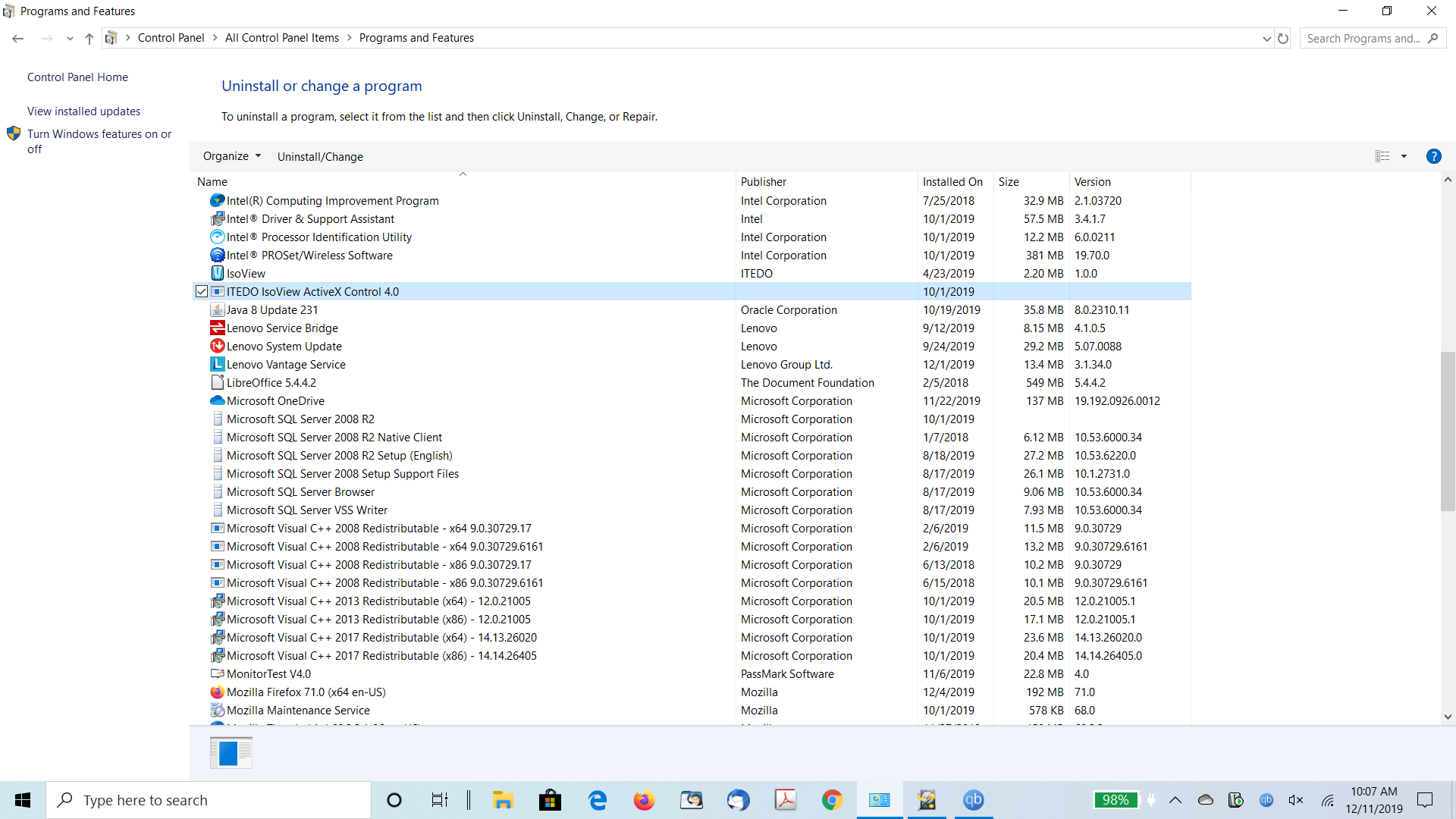

Unless you have a device related missing driver, can you post a screenshot of Control Panel > Program and Features?prefuse07 wrote: ↑08 Dec 2019, 12:10

xHeart wrote: ↑09 Dec 2019, 07:58Unless you have a device related missing driver, can you post a screenshot of Control Panel > Program and Features?prefuse07 wrote: ↑08 Dec 2019, 12:10
I reinstalled over it, and it seems to install good -- I actually got to see VIDA monitor go from yellow to green. Did as per Rick's original instructions including waiting for the java update (which last time didn't happen).
Went to scan the car -- unfortunately, still get that '0' exception error, and this time, when I clicked on Diagnostics, it didn't even try to communicate with the car.
Any thoughts?
At this point, I think I am going to return my DiCE unit, and just give up, unless you guys have any other suggestions?
Here you go:

^^ Missing ITEDO IsoView ActiveX Control 4.0. ^^

Vida Media:\3PP\Products\isoview\
