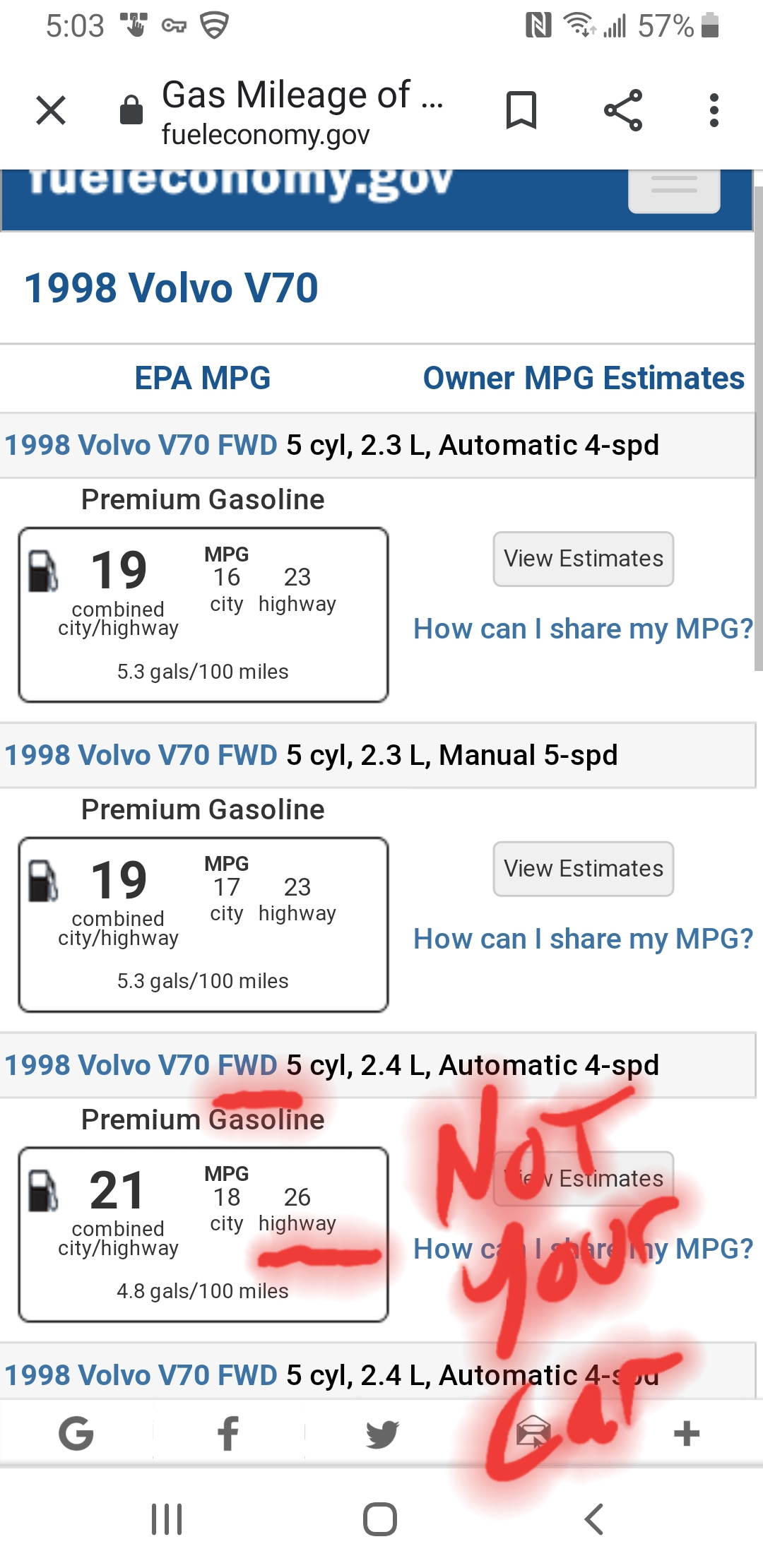

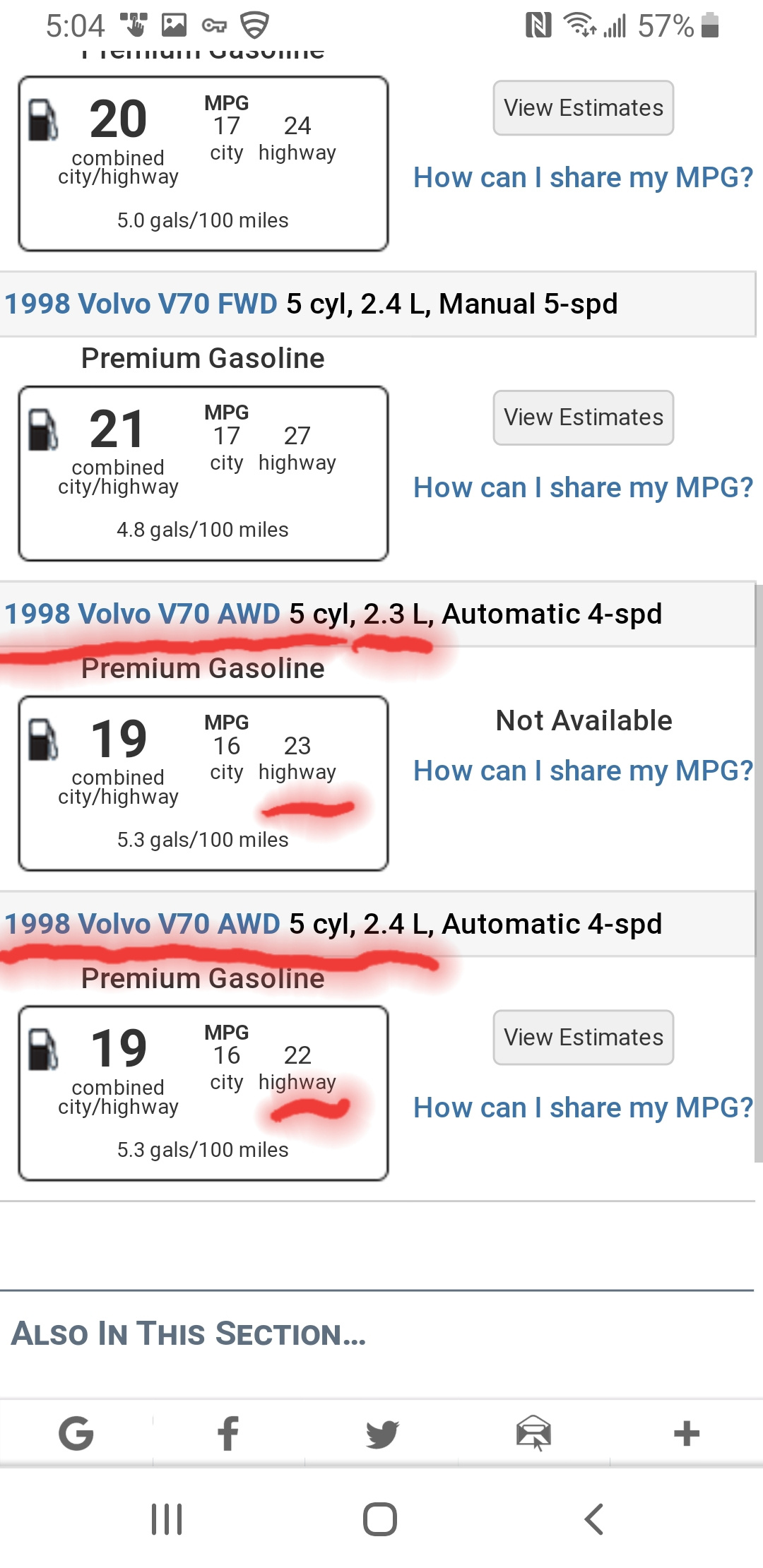

Your car is not rated 17/26 mpg that is for a front wheel drive 2.4L equipped car. Here are some screenshots of the EPA gas mileage for the 2.4 FWD which is not your car and the 2.3 and 2.4 AWD of which one is your car. I owned a new 98 V70 XC 2.3L and it was no gas miser. That was never the point of the car. Also notice Premium fuel is stipulated as used by the EPA during testing. If you use regular and run heavy oil that alone will make the couple mpg difference from what you are getting and what the actual original mpg rating is. June
