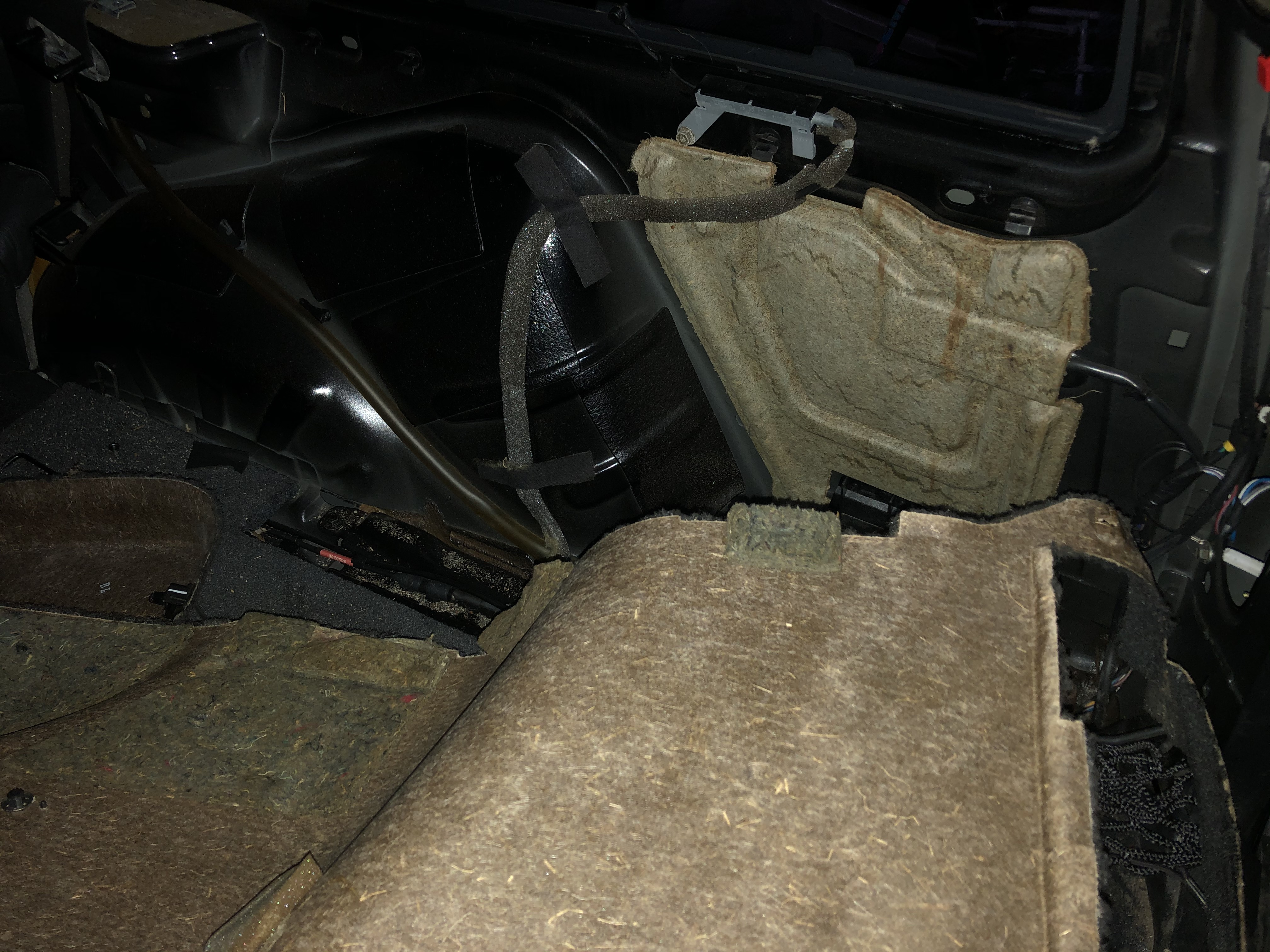

I pulled off all the rear passenger trim on the car and cannot locate any actuator. I have also pulled off the trim that goes to the rear passenger side tail light assembly.
Does anyone know the EXACT location of the actuator (if it has one) on this particular model? If someone could attach an image that would be great!

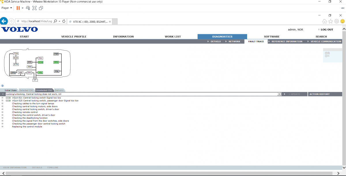

I was able to remove the actuator and followed SiRobbs video on cleaning and lubricating the unit, however this did not help. I recently ran a scan of the vehicle and received a couple faults from the VGLA (see attached pic). Any advice on where to go from here? It seems like the VGLA is not supplying enough voltage to the various components of the central locking system.
