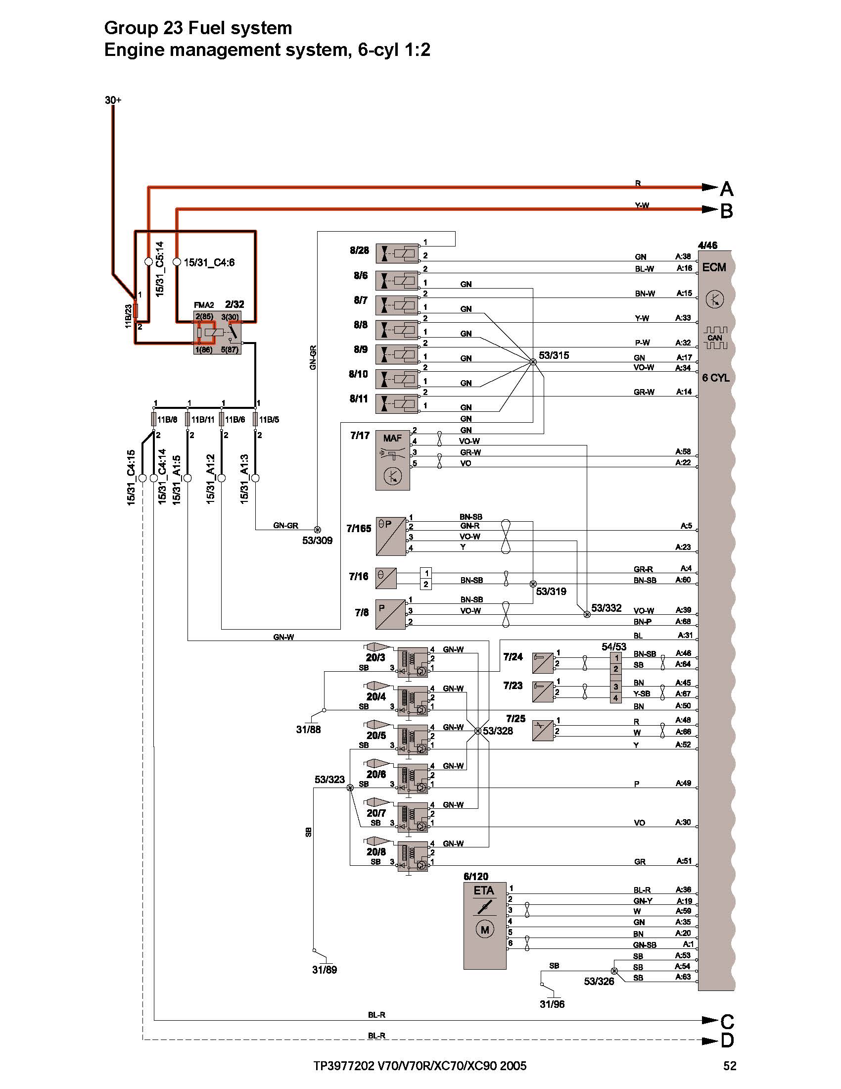

Check the battery health then check wiring and connectors going to the coil packs. Keep in mind that the bolt holding down the coil pack is one of the grounds, the metal under the bolt must be clean so that it will get good electrical contact.

20/3 - 20/8 are the Coil Packs.

- mrbrian200
- Posts: 1554
- Joined: 20 Jan 2016, 08:47
- Has thanked: 7 times
- Been thanked: 84 times
Codes for multiple coil packs at the same time: The first thing I'd check would be the chassis ground wires for the secondaries. 31/88 and 31/89 in the diagram. They're rings that attach to the cylinder head with small bolts right in the area of the coil packs. These are copper wires crimped into ring terminals. They can become contaminated by engine oil from a leaky oil filler cap, and/or by moisture. I recommend fluxing and soldering them. Use tinning paste flux (I use oatey #95 for this available at any decent hardware), gob it on at the wire crimp, heat it, repeat until you don't see any more black gunk coming out with subsequent applications, then finish if off with lead free silver bearing solder. Wire brush the ring terminals and the attachment points on the cylinder head then reattach.
You'll need at least a 60w soldering iron or small butane soldering torch to get these hot enough to activate the cleaning flux and melt solder. Careful: if you get it too hot you'll oxidize the copper wires and make more of a problem than you started with. Practice on 'spare wire' before doing this on the car.
Also check your engine to chassis grounds for voltage drop. As a quick test attach a jumper cable between the block and chassis.
You should also probably check for proper voltage at the green/white wires that supply battery voltage to the coil packs. The ground is completed through the coil packs to the ECM, and is 'momentary switching' by nature, thus can be difficult to gauge with a digital voltmeter. You'll want to dig out the old school analog meter with a needle (ideally you'd probe this with a scope), probe between one of the green-white wires at any of the coil packs to ground and look to see if the needle swings back and fourth or dips in a fast cyclic manner. Any more than about 0.1-.2v swing on the analog needle (note mechanical needles don't respond well to fast momentary dips in voltage, the actual drop is likely to be much greater than what the needle appears to indicate) may indicate a problem either in the wiring or inside the engine control relay which is 2/32 on the diagram (labeled FMA2 in the fuse/relay center under the hood). Alternately you can try bypassing the wiring and relay and just supply power through a temporary wire to this circuit direct from B+. Just be aware anytime you break the insulation around any of these wires you potentially introduce a point where moisture can invade the copper wires to instigate corrosion over time as we see in the heavy cables that run between the battery to engine compartment where the ends of the wires aren't sealed off--moisture wicks up into the copper wire and the cables rot from the inside out over time.
