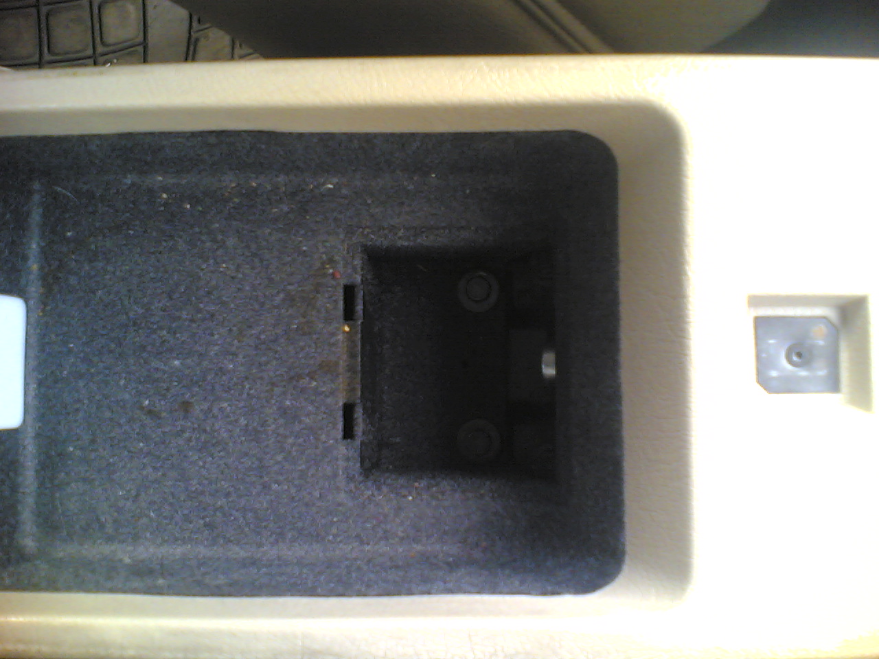

Well all done I have my nice stick light working . Dead easy job like I said before .
Open armrest and Pull up the flap . Remove the two 8mm bolts .

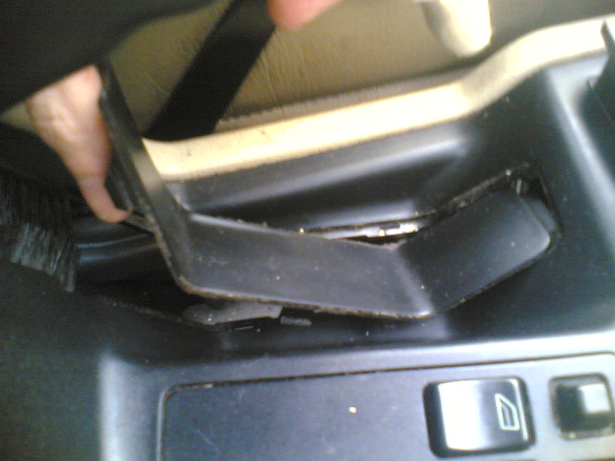

Hook your finger behind the handbrake cover and pull towards the front of the console .

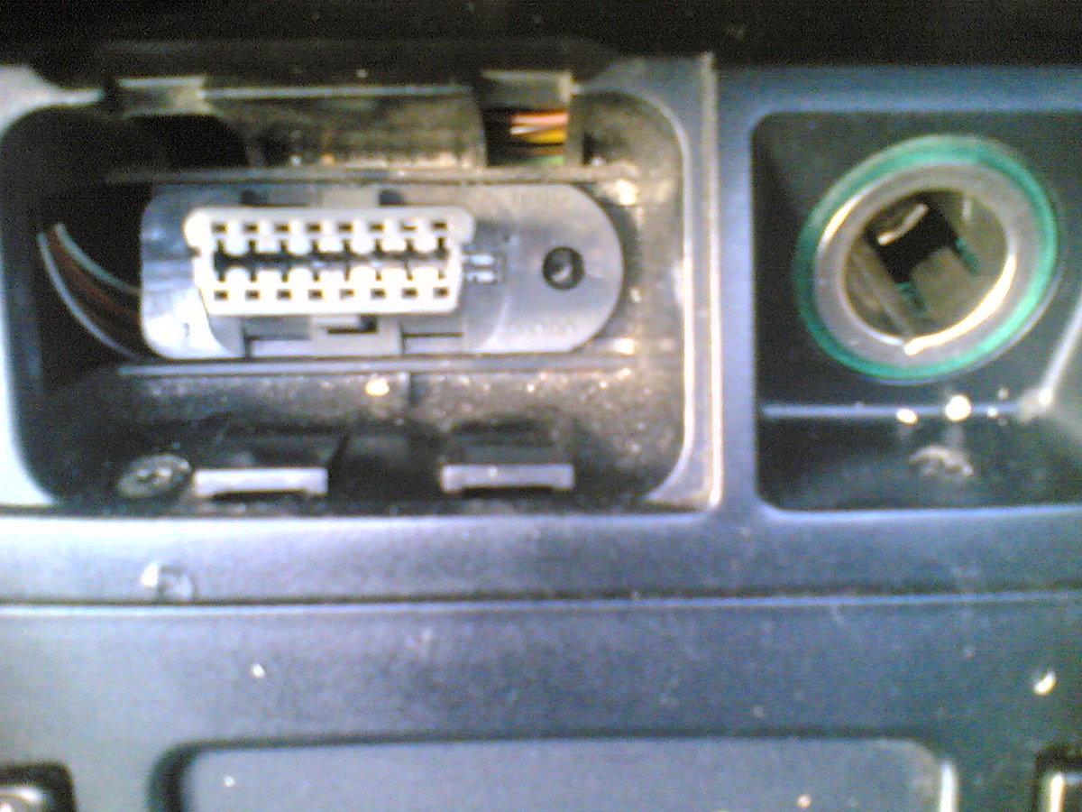

Now remove the ODBII cover/cointray . Remove the 2 screws you will need a torx kit to remove these screws easily . You may find a flat head will suffice but torx drivers are your best bet .

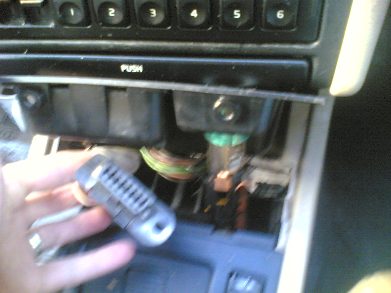

Lift the entire cointray assembly up and slide the ODBII connector from the side of the tray . Next remove the leads from the cig lighter . With the leads out of the way pull the whole assembly toward you and it will disengage from the console .

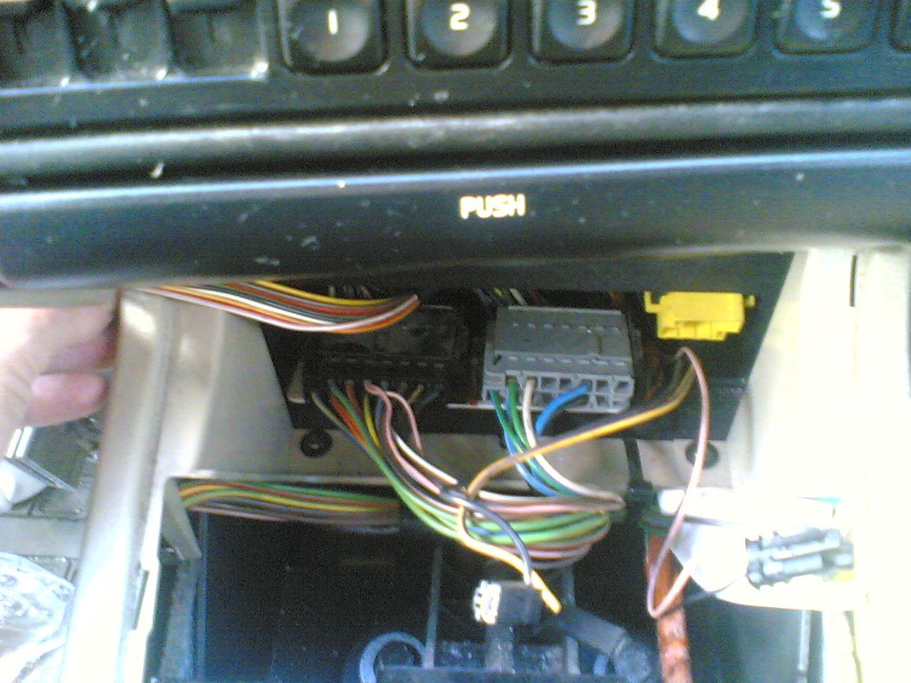

Now remove both the large connectors and unscrew the final 2 torx screws from the console . Make sure you move the ODBII and cig lighter cables out of the way before you move to the next step .

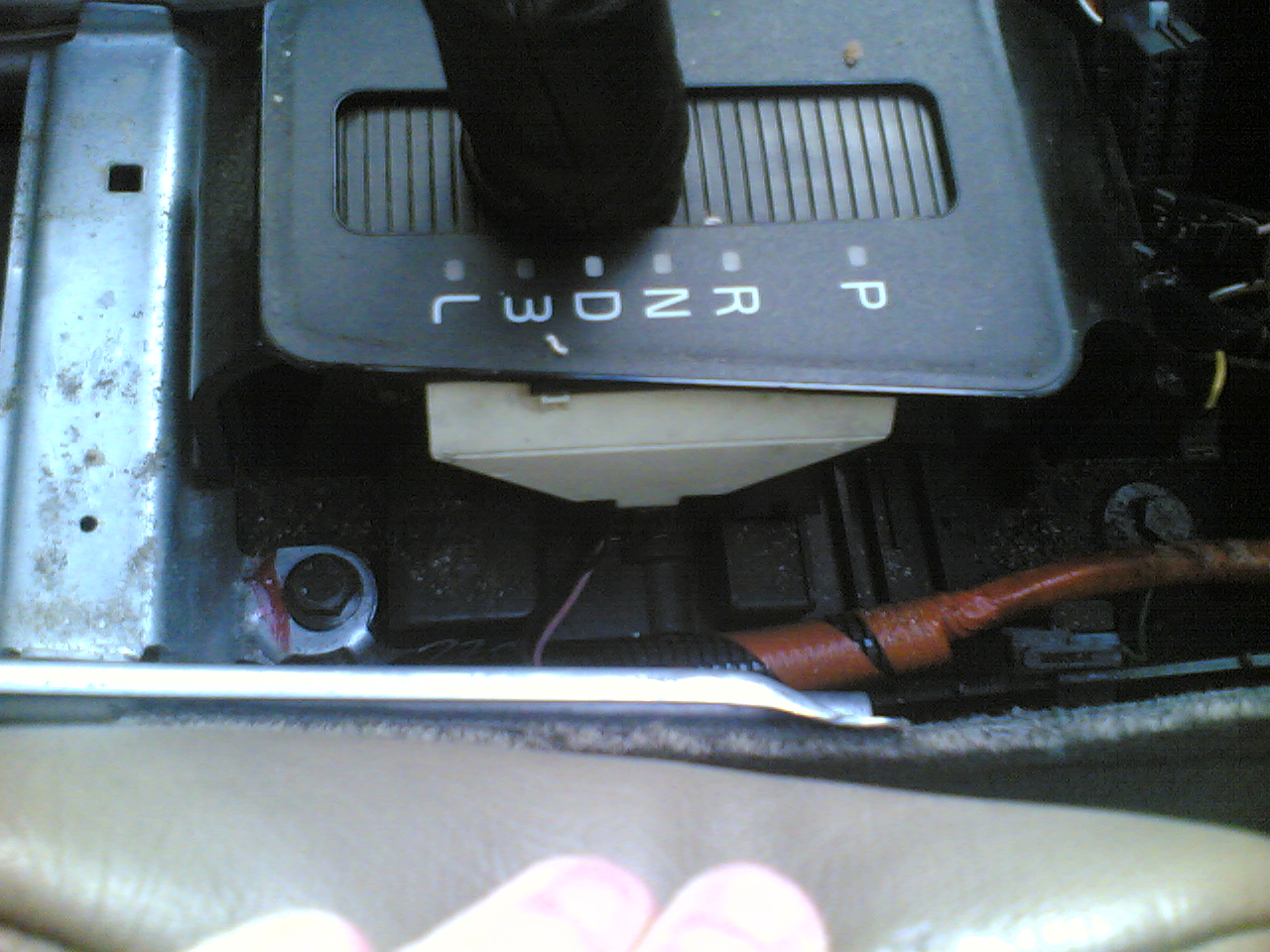

Shift box to L . Take hold of the console at the rear and pull it up and towards the rear screen making sure it doesnt foul the cables and it will come up and away from the stick and handbrake .
You should now be able to see the white plastic shroud at the side of the box . Its probably reversed on us models. Grab the bulb holder and pull it down , It may need a wiggle to free it as its a bit too tall to come out vertically .
Pull the bulb from the holder using the black body not the bulb itself .
Insert the replacement and reverse the removal instructions .
