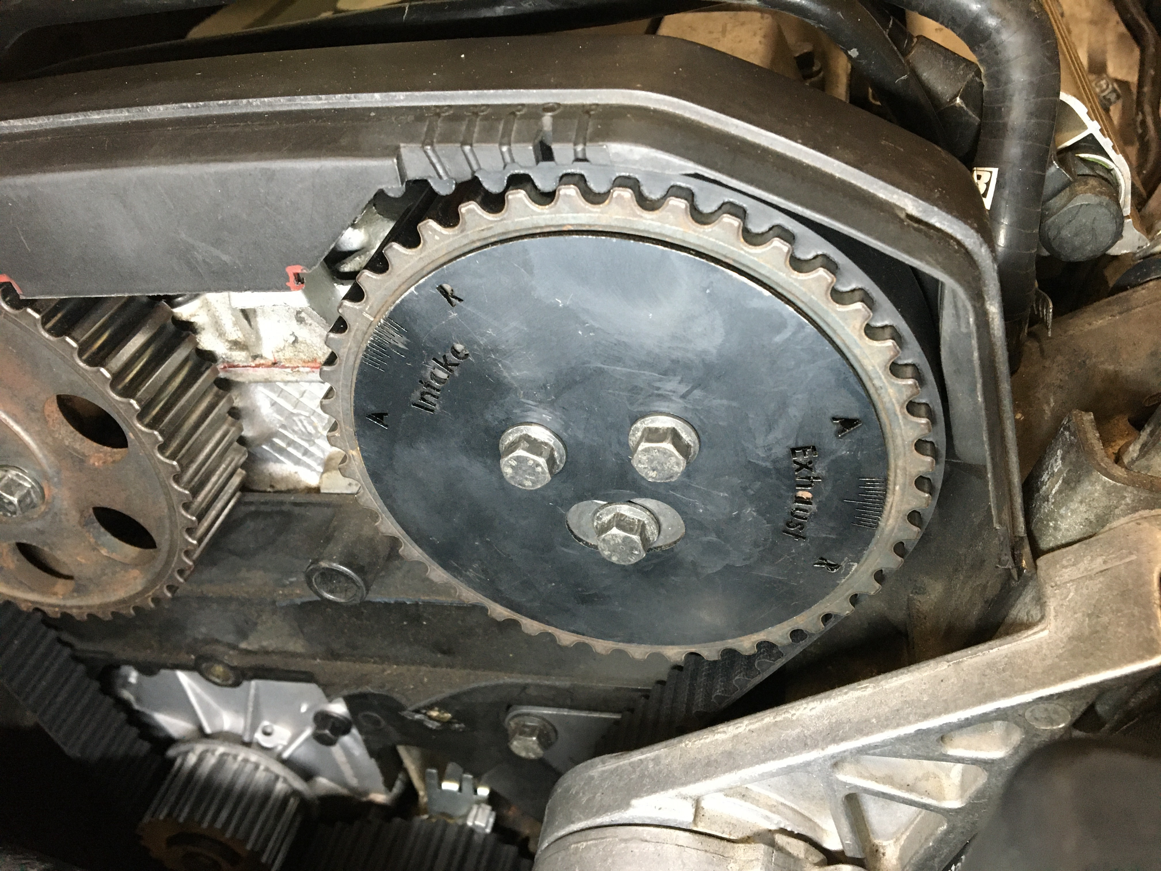

Here are some random pics... iPd cam tool is fiddly to use, just make sure you align everything with the cam locker from the rear, make sure you know where the iPd tool has to be positioned to be at the 0 mark, and make adjustments carefully. It's REALLY easy to knock the pulley out of alignment, so be very careful. It also didn't help that the cheapo timing belt tensioner was giving me hell... I ended up having to pull an INA tensioner off one of the motors in my garage to use instead. Set up nicely the first time, way easier than the ECCPP junk! Please, DO NOT USE CHEAP TIMING COMPONENTS! This is one of those crucial areas where you do NOT want to cheap out. Don't be tempted by the savings... think to yourself... $60 savings today, or $2,000 savings in 6 months? Cylinder heads aren't cheap to rebuild. Believe me, it's not worth it.

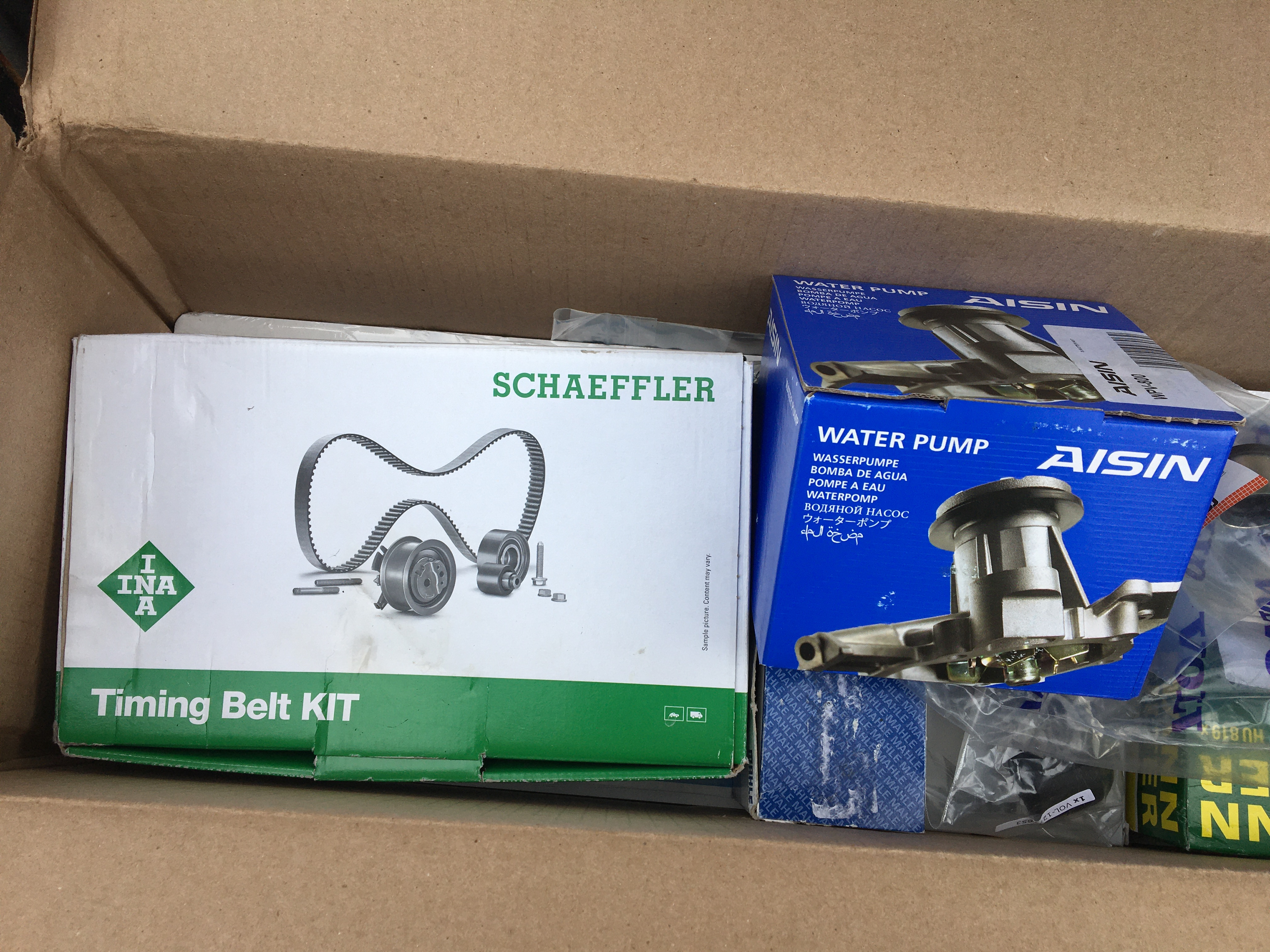

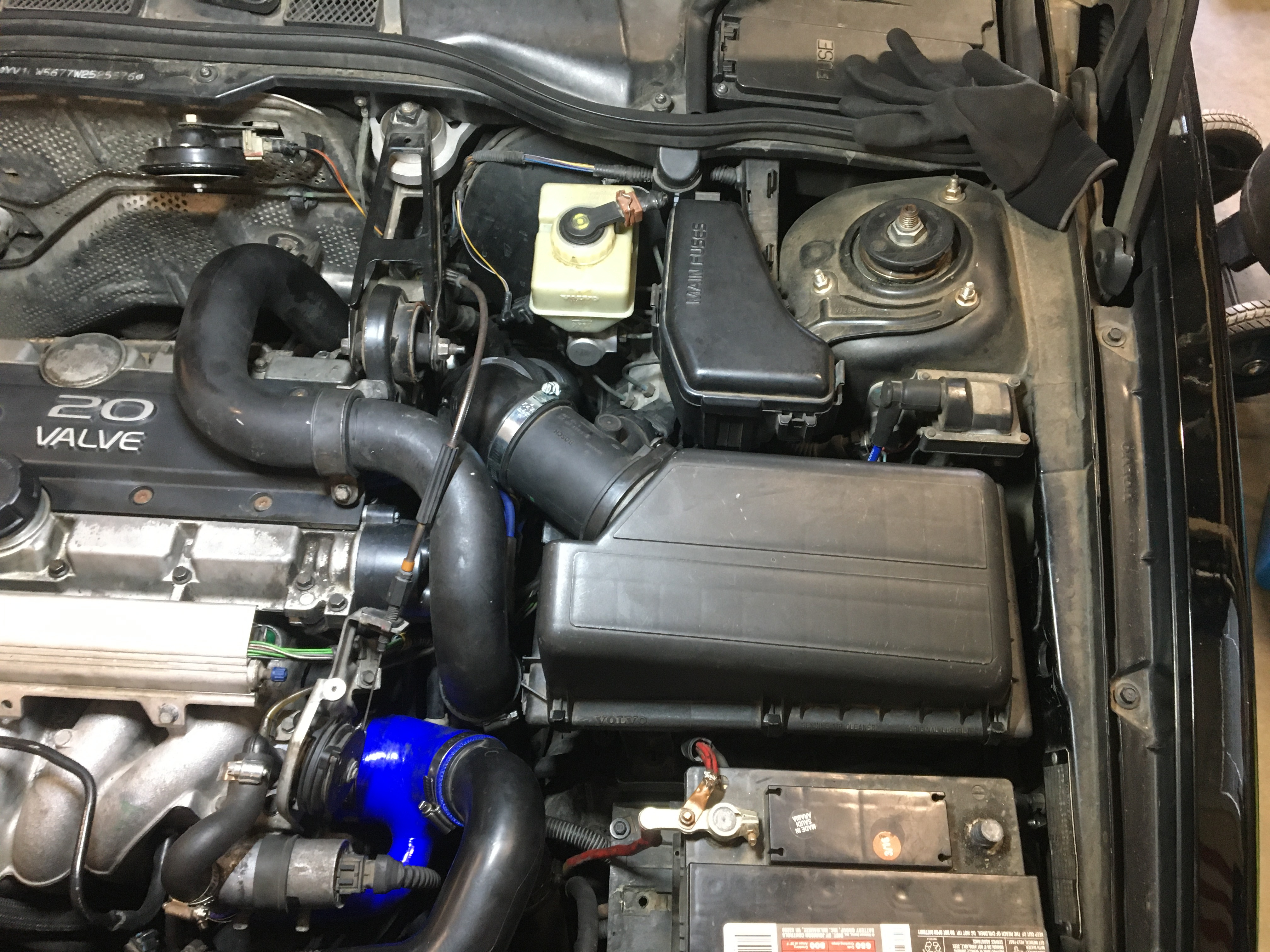

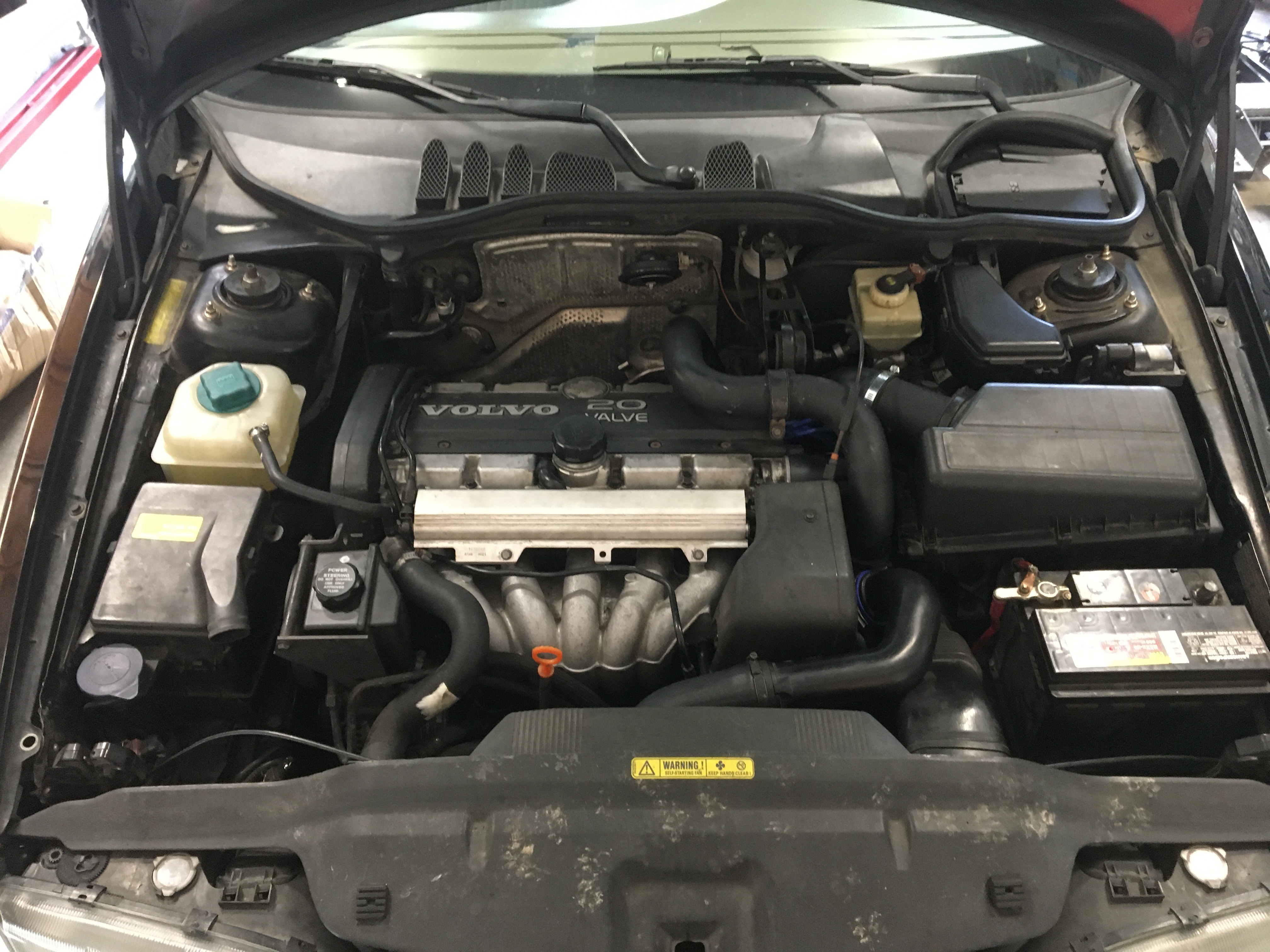

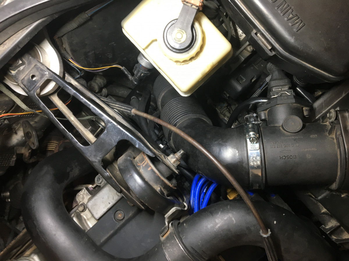

The parts here in this pic (which are for my 2000 S70 GLT, I may post a little thread on that) are the only ones you should be using. Continental or Gates Racing belts are good substitutes, but the INA pulleys and Aisin water pump are the only ones I would use. S90 MAF in place with ME7 intake elbow. All that was missing in the full engine pic was the ECU intake hose... which needs to be replaced.

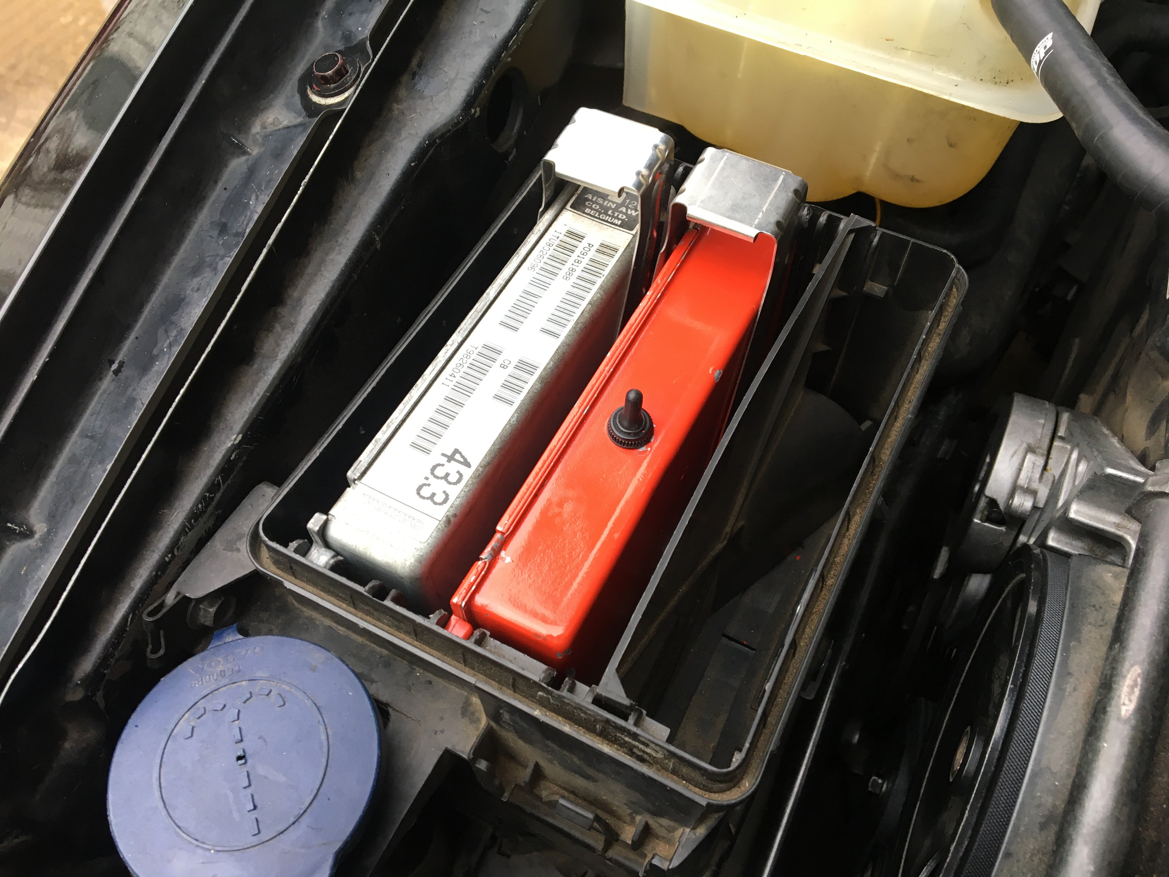

And the fancy red Sovvagn Motorwerks ECU!

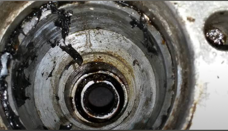

Also... since I couldn't find this info anywhere... if you delete your SAS and want to go beyond the basic diode (why "delete" something and keep useless components there?) and delete the physical secondary air injection components, you will have a hole in your stock downpipe. I removed EVERYTHING... the pump, check valve, solenoid, and hoses. Connectors just got zip tied out of the way, no need to remove the wiring completely since it's out of sight anyway. (Plus that gets out of control fast.... I did this on my V70R with all the auto trans wiring)
Anyway, the solution to this is a 5/8"-18 bolt. I tried various drain plugs from the auto store, but I eventually needed to bring the broken check valve pipe fitting to the hardware store and see what I could find. I went to plumbing first, but it was surprisingly easy to find the right pitch bolt once I realized I needed to be looking in hardware.
I used a 1 1/2" bolt since that's the shortest they had, but I had to cut it down quite a bit to clear the straight flange downpipe.
You'd think it would be a metric size, but it's not. SAE sizes are foreign to me... I typically only work on European and Japanese cars.

I’m afraid to ask what the little button is for. Does someone I don’t know get an engine code if I push it?
