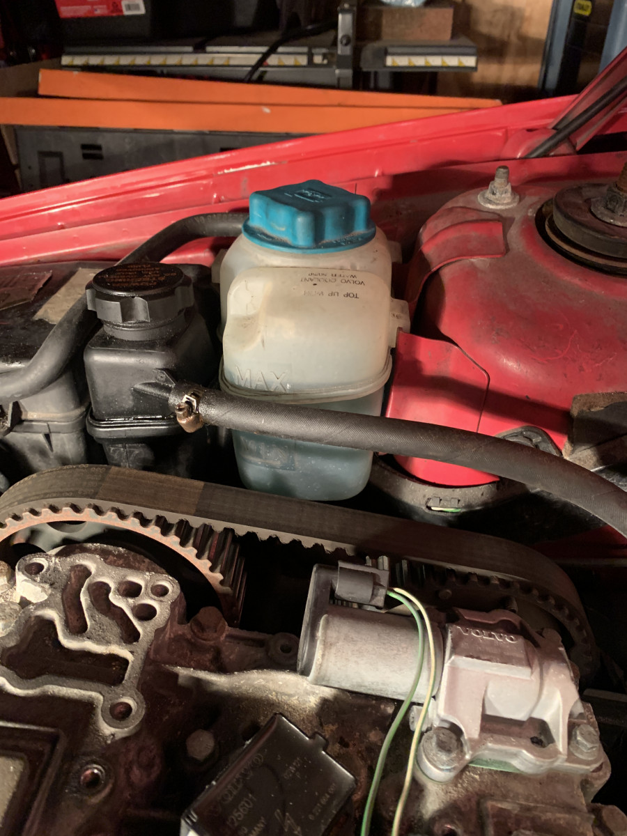

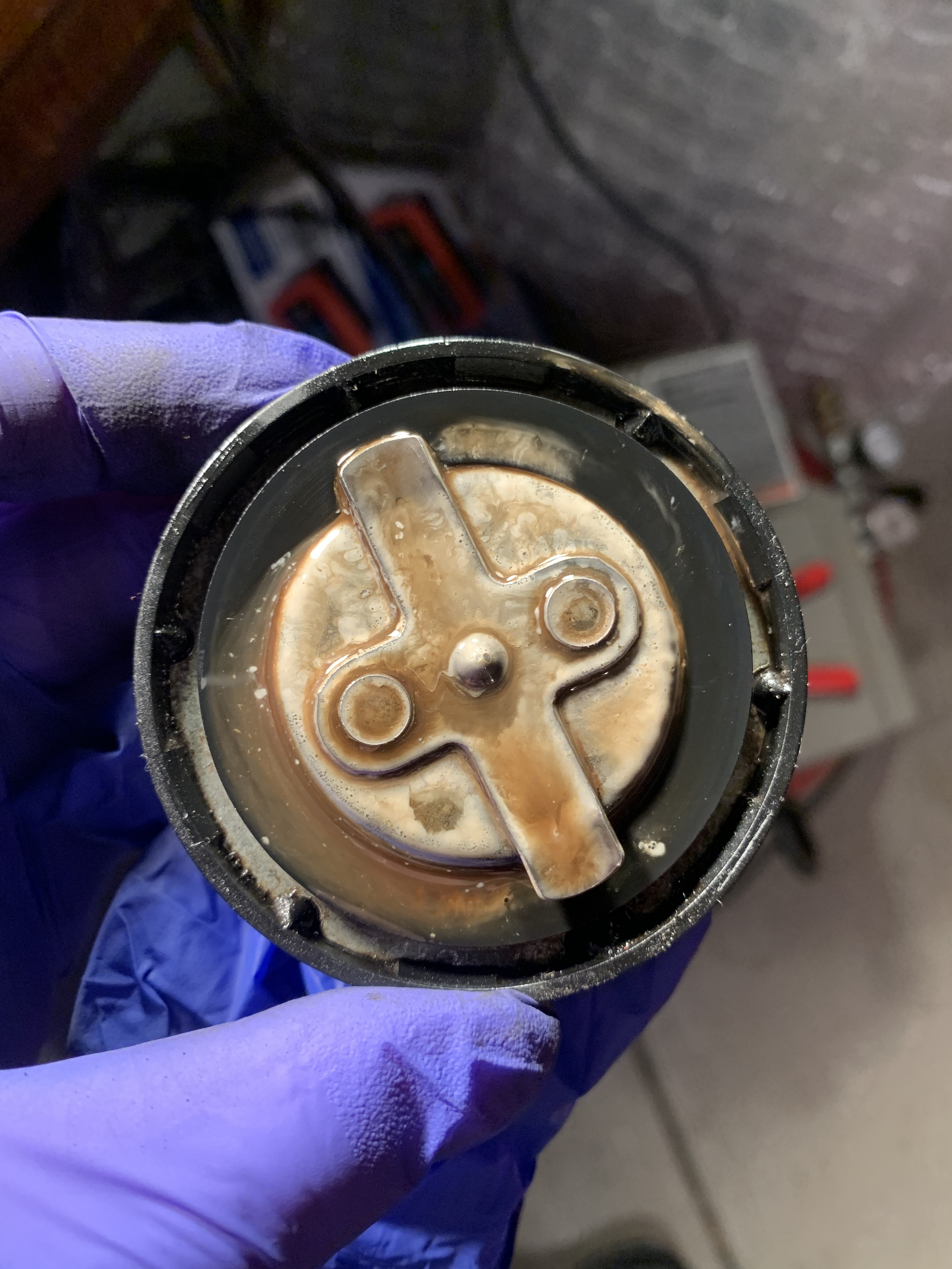

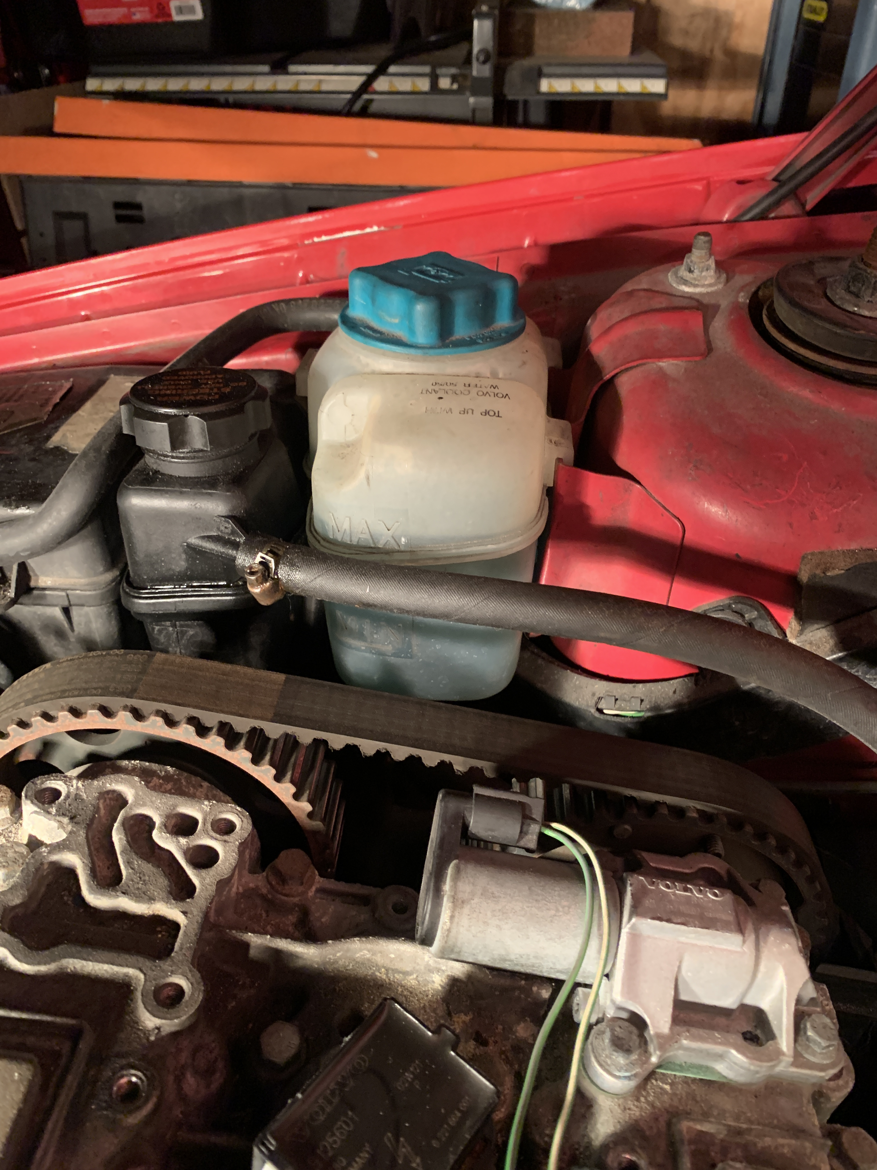

Update: I fired up the car tonight and seems like coolant is in the oil. Take a look at the photo. Am I correct? Or is it some kind of condensation since car ran for few minutes in cold weather. Also seems like coolant level raised when engine got worm. When engine was cold the level was between MIN and MAX. Is it worth spending my time on it or find an another engine?
- Posts: 35267
- Has thanked: 1497 times
- Been thanked: 3809 times
That looks like cold running condensate , not coolant
Pull the dipstick and look for chocolate milkshake vs brown or black oil.
