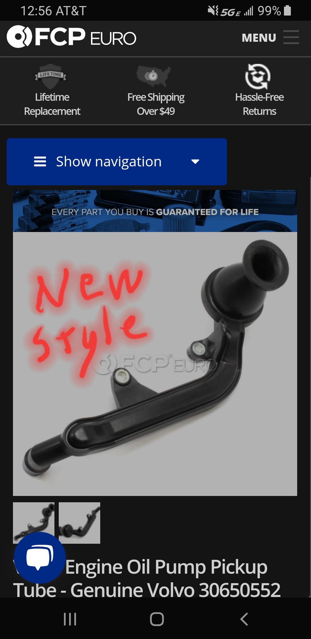

Don't forget to replace the oil pickup tube. The old style is prone to clogging with sludge. June
