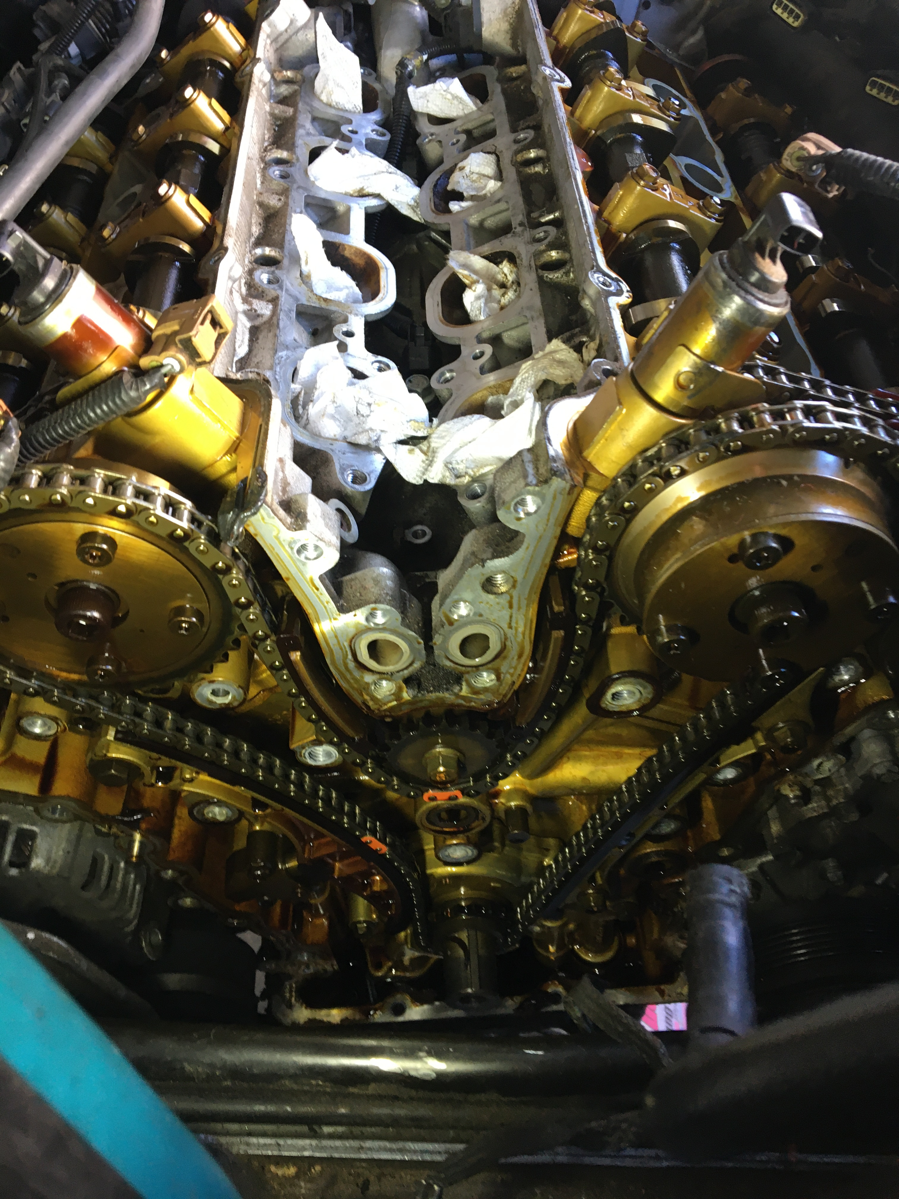

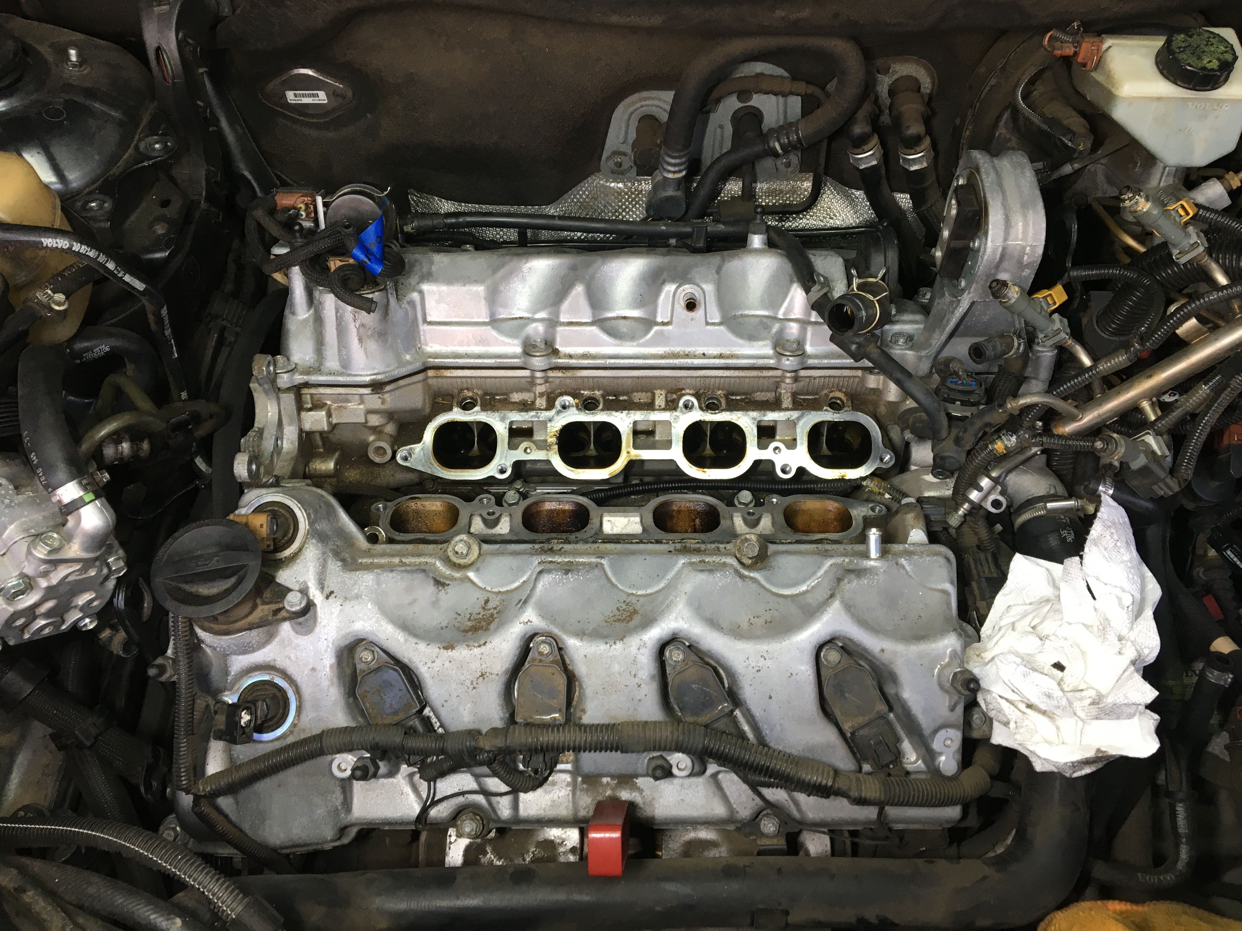

Started tearing down the XC today to reseal the timing cover. All that's left is to pull the valve covers, pulleys, crank pulley, and passenger side engine mount. Hopefully things continue to go smoothly. It's really not a bad job, just time consuming!

I worked in one of these with shockwave. It’s thirsty but a beautiful motor.

Thirsty indeed... it averages around 18 MPG. Hopefully a little more once this is done since I'll be replacing the plugs while I'm in here. I didn't want to do it sooner because the valve covers were leaking into them, and these plugs aren't cheap!
They look original at 164k miles.
It's incredible how small they are though... 60 degrees is tight for a V8. Still no room to work on it, but it's better with the intake manifold off!
Eh... I guess 18 isn't too bad. I average 19 in my R.

Got the timing cover gasket on today, just need to finish reassembly tomorrow. The job really isn't nearly as hard as people would make it out to be, but it seems I continue to make this discovery every time I hear that... usually the people saying it haven't done the job themselves!
It is, however, VERY time consuming... these V8s don't have much room to work around. But it's a good trade off... they're fantastic engines!
I will make a write up for this job in the next week or so, as I haven't been able to find one aside from those grim warnings from older Swedespeed threads. It will focus on the core of the work, I won't detail information on removing the power steering pump, pulleys, and whatnot as there are already good threads on that. Plus, it's self explanatory if you do this stuff regularly.
Fortunately VIDA has the basics in the procedure for timing chain overhaul.
Once that's done, I'll be installing a transmission cooler from a T6 and doing a fluid change. I figure since it's down, I might as well knock out as much work as I can. Plus, the trans cooler will help make it more suited for towing... I don't have any other vehicles to tow home my $300 Volvos so I need to keep this one in good shape

That is an awesome look inside the V8 version. Man, those timing chains!

It's cool to look at, but I can't stand timing chains... belts are so much easier to deal with!
