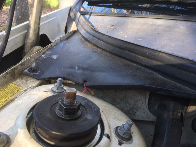

The plastic cowl cover on our '97 850 started to bow a few years ago. I added a little hold down made out of a cable tie, which worked pretty well for a while. But now the plastic is bowing again. Has anybody else observed this problem? What have you done to fix it? Thanks.

What’s under there

I would use a Heat gun to soften it up then reform it. A hair blow dryer should do the trick if you do not have a heat gun.
Wait what am I saying? .... a hair blow dryer is a heat gun.

Is that just bowing under the tension of the zip tie? It looks too tight.
It should take another screw holding it down through the boss up top
If the plastic underneath is broken, build up with JB Weld, still a pilot hole, and replace screw

The other option is to find a better replacement at a junkyard. The plastic is close to 25 years old so likely to suffer from age issues like myself! I think a combo of what Rick and Steve have suggested can work using self threading bolts/screws with large washers, drilling a couple of holes and first heating the plastic before putting the screws in.
If your car is otherwise still in very good condition and you want to keep it that way, then a better used example is the way to go. You may have to find one from a more northerly state where year round temperatures are lower so the plastic may still be more supple.

Argh , you need the -1997 draining channel
9151056 NLA new
Stick a request in the junkyard request sticky in CLASSIFIEDS
1998- on won’t work, different part number,
9127584
that one is still available
9151056 NLA new
9127584

The heat gun idea is a good start, see if you can get it nice and warm and try to flatten it out. Then, use the correct screw in that spot to bolt it down. Looks like it's broken, so some JB Weld and a washer might be a good way to fix that.
Otherwise if all else fails, that's a good thing to grab at the junkyard. I might even have one somewhere.

Soften it up just a little then clamp a straight edge along the straight edge of the plastic, let it cool in a new form. Might need to heat the rest when the edge is clamped down for tension relief .

Excellent addition, wish I had thought of that, and the further suggestion of a little more heat once clamped to reduce the natural plastic will to bend is also excellent.
