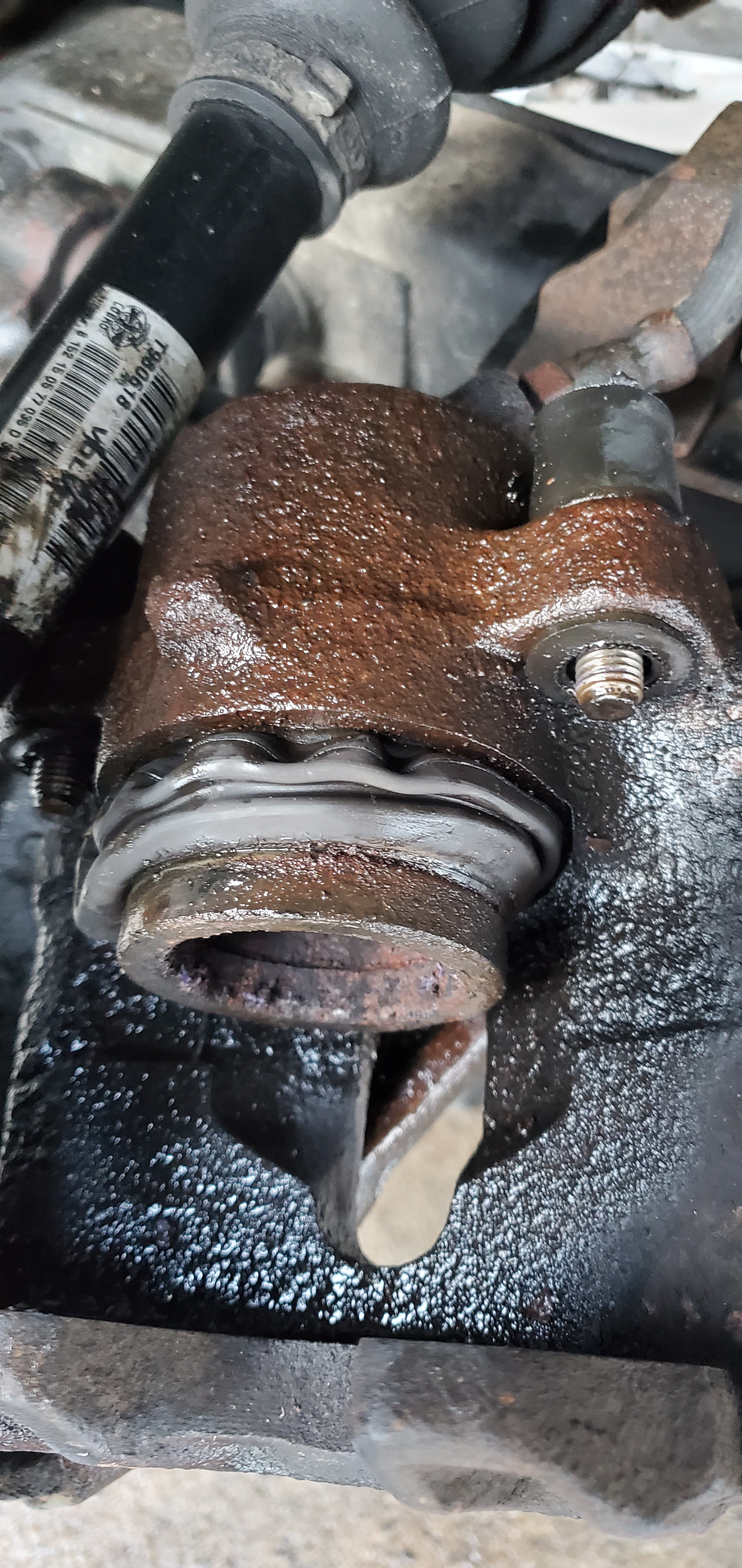

I’ve got a set of T shirts of that mistake
Clean them up, get the piston back into the cylinder and reseat the seal and they will be fine
Nitrile gloves, brake fluid is bad for you.

Hard to tell where the fluid is coming from. The piston looks like it may have over extended as the dust seal looks like it has come out. Did you press the brake peddle by accident?
Pipe does not look wet so don't think the pipe is the issue.
