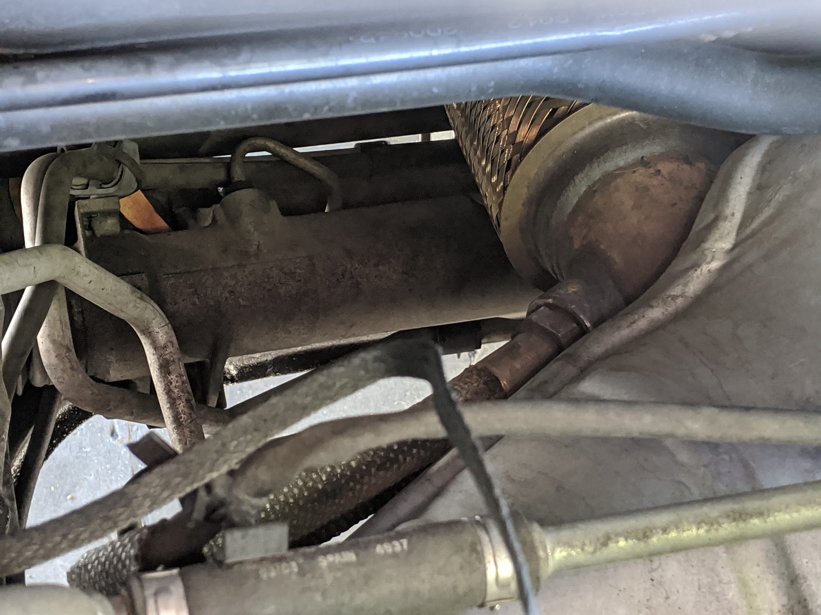

Noob here :oops: Can someone please confirm if this is sensor1 bank1? Taking picture from top, passenger side
I traced down the wire with my hand and it goes all the way to driver side, underneath the air intake and fuse box. It's so hard to get to it, I can't even see it. Any thoughts on best way to reach out to the electrical connector of the sensor so I can unplug it?

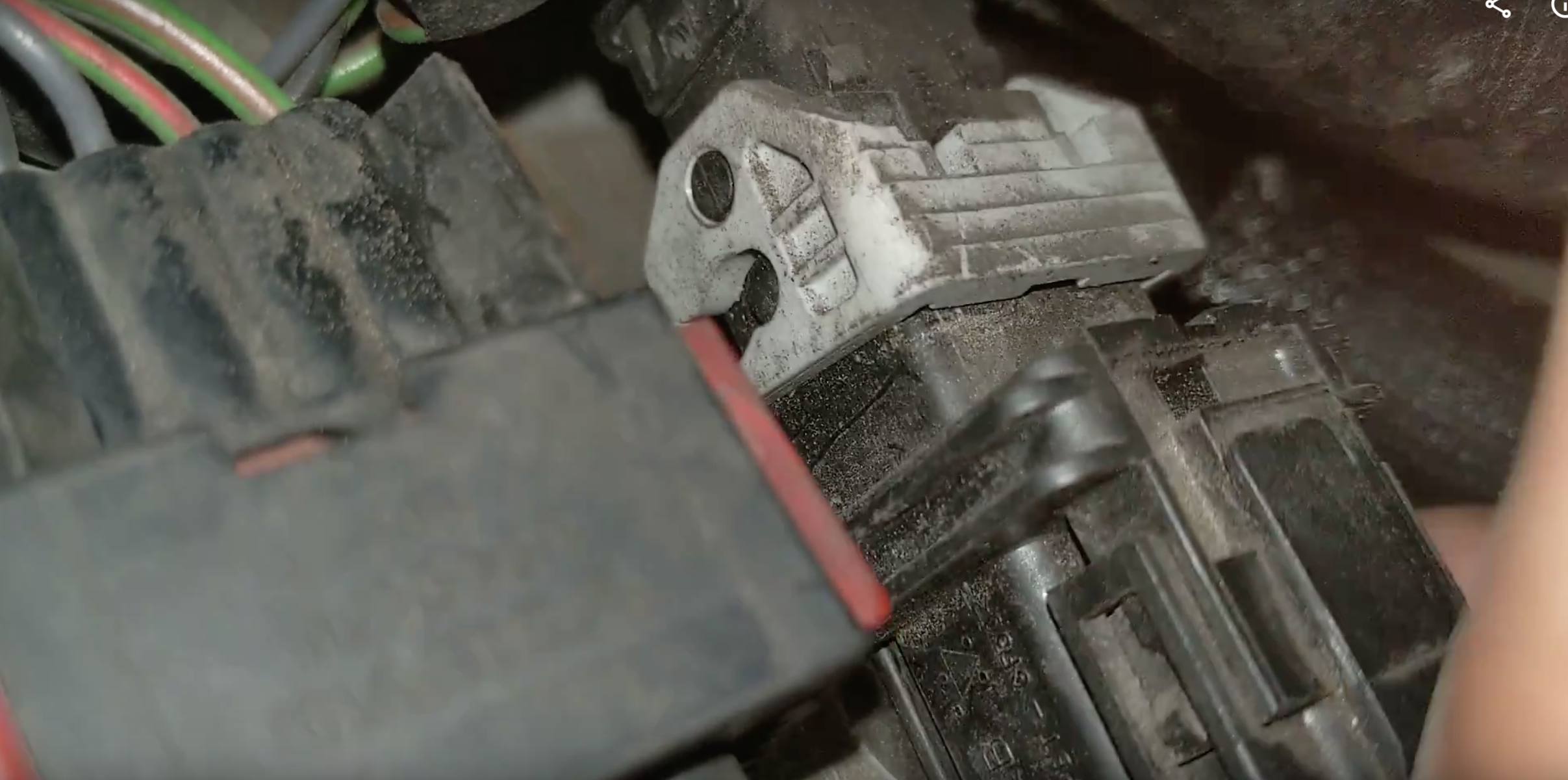

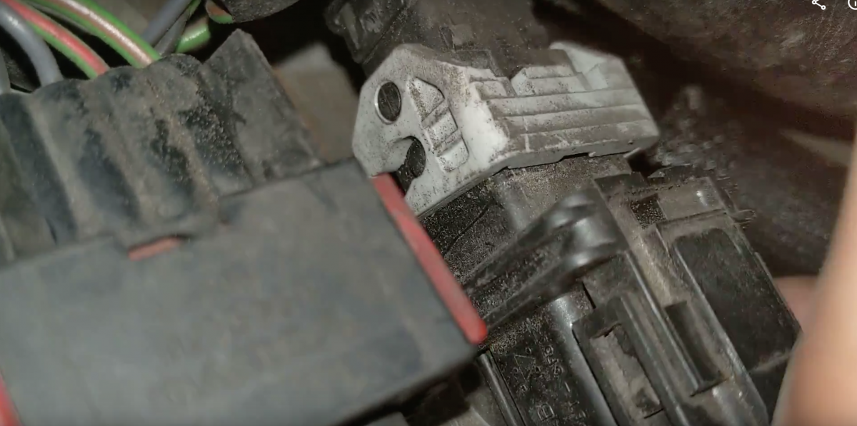

Update: I snuck in my phone to see how the electrical plug of the sensor looks like. Any idea how to unplug it? I tried many times but couldn't (again, I can't see anything, so just using my fingers). Didn't want to use force so it doesn't break. Please help this new noob here :P

You have the right sensor. We only have one a Bank of cylinders on our Volvo’s so it’s Bank 1
The first sensor before the cat is sensor 1.

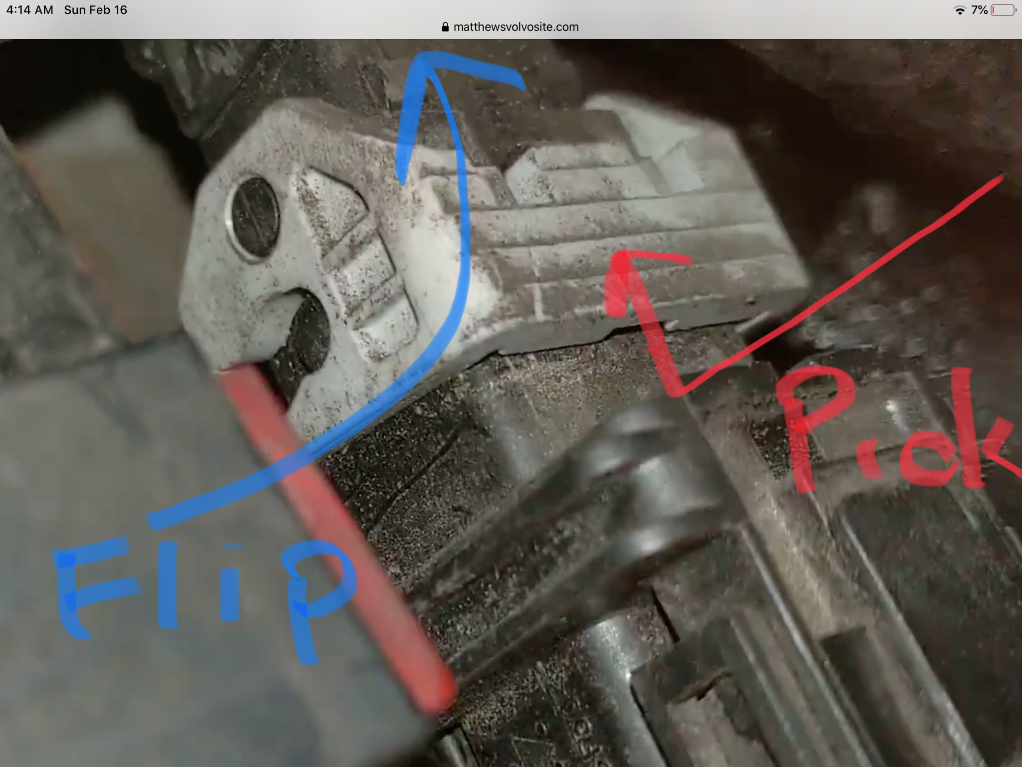

You need a small right angle pick. Get that into the hole in the grey release tab and flip that up 90 to release the connector.

Thanks a lot for the pick tip, didn't notice that hole! Will give it a shot and see!
