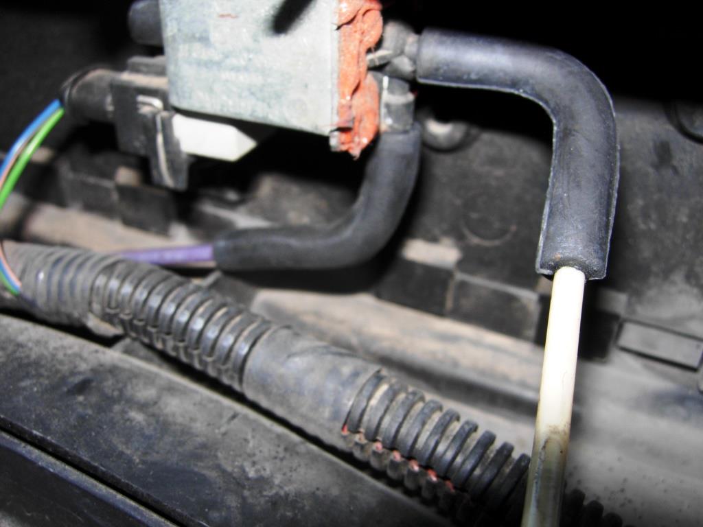

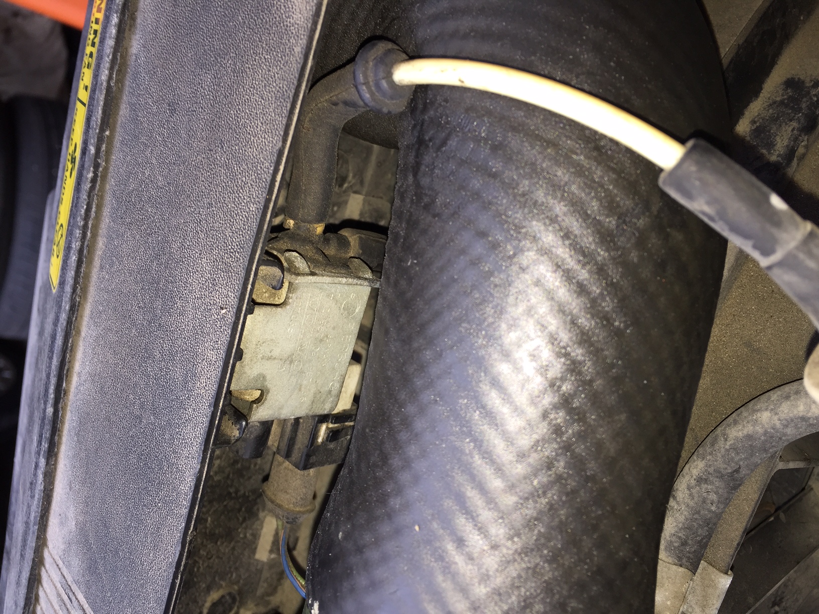

Just to follow up for others who may come upon this thread down the road: The "mystery" part looks like it is just a standard SAS solenoid.
If the car has SAS, then the purple line runs to the SAS valve, one port should be capped off, and the other port runs to the vacuum tree through a check valve. Like these, the white line is going to the vacuum tree: The nipple on the SAS solenoid toward the battery side, is just capped off.
To my knowledge that solenoid has no business being in a 94 like the OP stated he has, that year had EGR but never SAS. EGR and SAS are never together in the same car. So the car has some Frankenstein to it, but a lot of them do ...
