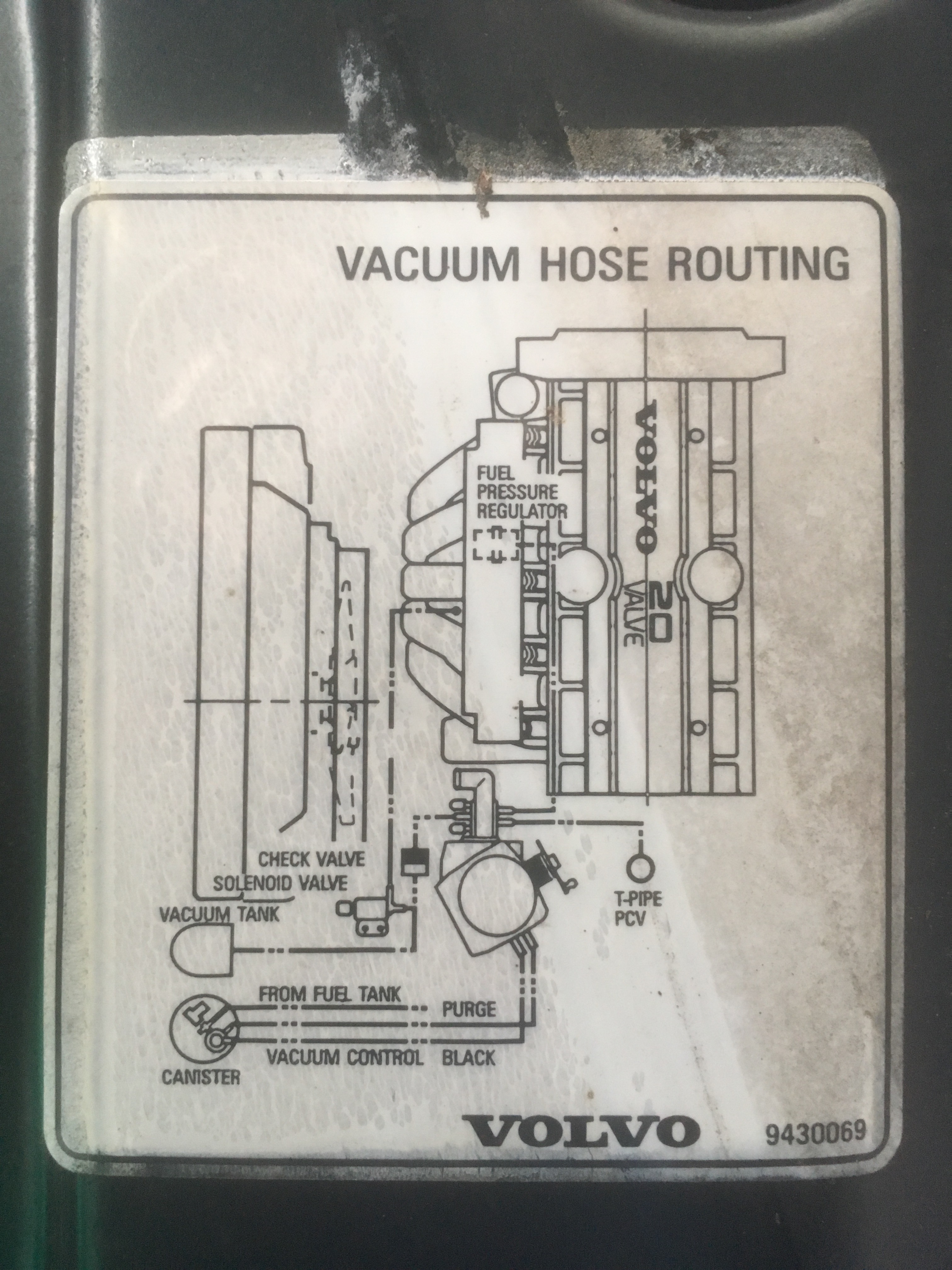

Hi.
Im new to this forum and need some help.
I have read through all the post and threads about vacuum lines and routings. However, my vehicle is not one of the ones listed.
I have positive crank case pressure after doing the pcv system myself.
It’s out of order and I’m not sure where to start.
I don’t know what the vacuum tank looks like first off, and I’m not sure the pcv box is suppose to be hooked up to the flame trap like I have it.
I will post pictures, including what the diagram looks like on the hood of my car.
Hopefully it’s the hood that came with the car!Image

No! Sorry! This is the thread I have already opened and read through carefully. I have a different vacuum hose diagram on my car that includes a “vacuum tank” just above the the shape in the bottom left hand corner, and below the the lines “ “solenoid valve“ and “check valve”
Thanks for your quick reply 🙂

Okay here comes the photo of the diagram, more to come.
Im liking the good news! I really like this car, and although i don't know too much about it, I've been gotten in deep on the pcv system.
I replaced every line myself including the breather box, and failed to pay attention to the routing as it was before i started. I am starting to see where thing are wrong; i have a whole side of my tree plugged up and that's not right.
This is a non turbo 1995 850 glt. Ive done extensive searches into confirming this, as different oil shops and dealerships have told my misleading information about my car. Its a stock, manual transmission, of which group I'm not sure.
Ive been underneath the car and begun to understand the charcoal canister and the vacuum reservoir/ the picture in the bottom left corner, now i just need to find the vacuum tank!
Thanks for the help so far!

I got a chance to take a look today and a couple questions came to mind.
The first thing i noticed is some sort of vacuum object underneath my battery plate. I'll include a picture of it. It seems to be missing a line entirely.
The second thing I noticed is an electrical component attached to my airbox on the side. This is the only place where vacuum lines could go in and out of the airbox.
Lastly i noticed a lack of a second line that comes out of my intake. Is that the part from the pcv box? not sure. but there is one for the fuel pressure regulator and another coming from the center in the diagram that leads to something im not sure of.
Lastly and probably most importantly before i start changing things. I noticed the diagram you sent me and the one on my hood are different. For example/ two of the left sides of my tree are suppose to be used in the diagram you sent me, but only one in the diagram on my hood.the t pipe is routed on opposite sides ect. How can i confirm what sort of diagram to trust? Do i have VVIS?
