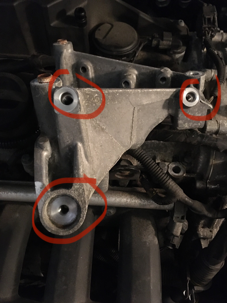

This picture I should help
I marked it with red sharpie to make sure that it was still align upon reassembly
You need to remove the bolts where the red sharpie marks are
The bolt head is about an inch to the left of the sharpie mark in the picture
Thanks
Paul
Thanks
Paul

Thank you! I already have those two loose, so I guess it just needs a good hit to come loose.
On a YouTube video a guy said for the earlier models like this one, a special tool is needed to re-align the bracket with the engine and other pulleys?

Remove the belt tensioner
I see from your picture that you didn’t
I can’t remember if the tensioner is in th way for removing the bracket
But I did remove the tensioner first
Good luck
Paul
Good luck
Paul
