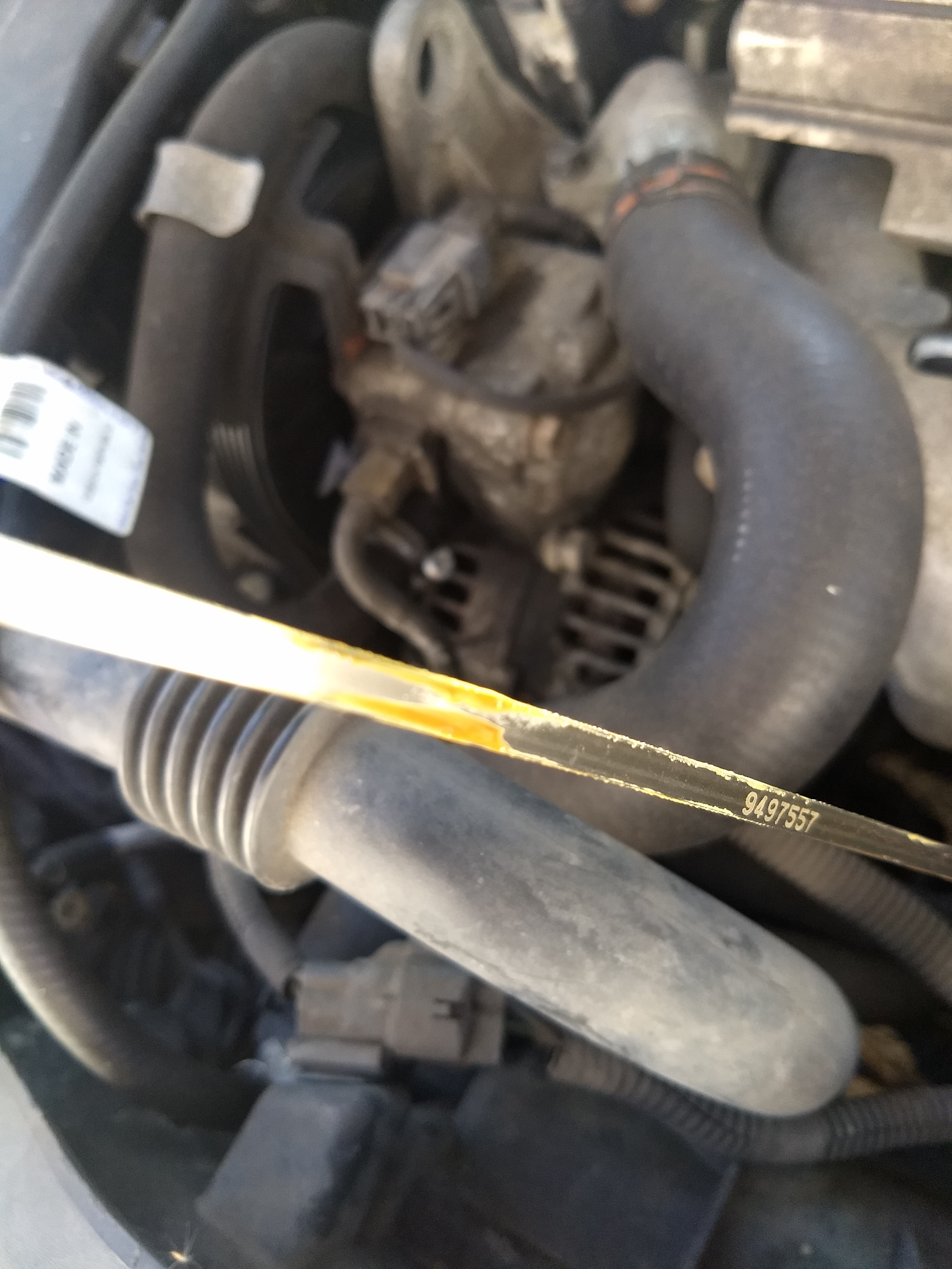

Discovered that the coolant level in the Silver Bullet ('00 V70 MT) was low, went to check the oil and found some troubling evidence.

Could be trouble or just slow speed kid hauling in cold weather. Get it out onto Death Race I287, get it up to 90 mph for 30 minutes (stay in slow lane so you don't impede traffic) then come back and show us your dipstick again, staying at least 500 meters from schools.

Yeah, that could be trouble if you do that too close to a school...abscate wrote: ↑10 Mar 2020, 06:47 Could be trouble or just slow speed kid hauling in cold weather. Get it out onto Death Race I287, get it up to 90 mph for 30 minutes (stay in slow lane so you don't impede traffic) then come back and show us your dipstick again, staying at least 500 meters from schools.
