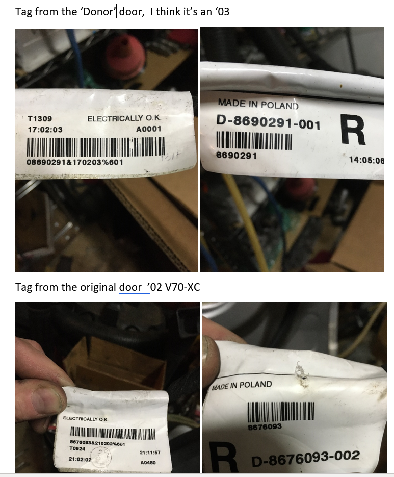

Well as it turned out is was the the wiring harness. Here's the photos with the tags :
everything plugged up...but as Abscate pointed out, there must be subtle differences in the harness pin positions.
