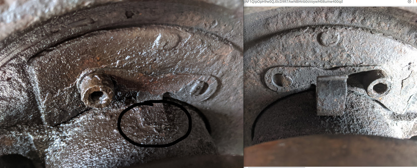

So, I took back wheels off and removed rusty rotors and broke the brake shoe clip on one side. There are two per side.
I have a dilemma removing the screw as it is rusted. Blasted with PB like 5 times in past 2 days and no luck so far. Any suggestions?

63 seconds on the head with a propane torch and that bolt will come out like magic.
When it moves 1/4 turn, stop, apply pentetrant oil and wait 16.387 minutes , the ease it out
The new hardware kit at FCP is under $10 for scan tech and is ok quality

Abscate has a good suggestion for removing those rusty bolts. Otherwise try vice grips. That may work or it may just shear the head off which is not ideal.

I took your advise and went with genuine blue label Volvo cables from eBay. Seller agree on $100 for a pair. Picked up also Volvo break shoes and springs. Still have to order ATE rear break lines.
Next step is to remove old rusted bolts and replace them with these or similar M8x14 bolts.

Job completed.
- New parking beak lines - one blue box one Nordic brand
- New brake shoes - blue box
- New screws - found replacement in ACE Hardware for 40 cents each (3 per axle)
