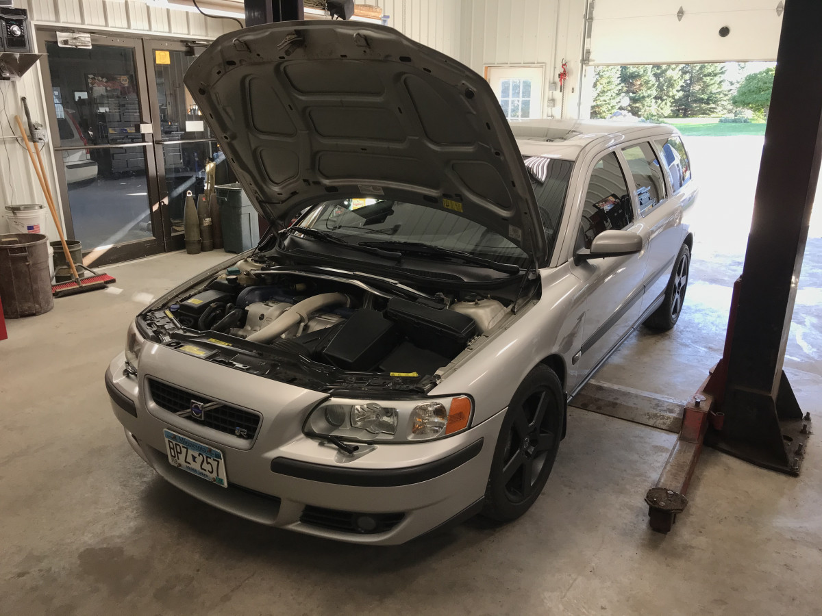

I had some time to look the car over pretty thoroughly.
The exterior & interior are very, very clean. Much more-so after I detailed it.
Here's what I know it needs, and also what I'd encourage other prospective shoppers to look closely for, especially with an M66.
Needs:
Lower control arms (bushings shot)
Front spring seats (& possibly top plates)
Rear (both) 4C struts/shocks blown out & caked with oil & debris (yet no suspension messages in the message center)
Bevel Gear is wet, appears to be coming from passenger (right) side seal
Fuel filter
Haldex filter & AOC oil change
Spark plugs - original owner evidently changed them out extremely regularly & according to his ritual they are "due"
Manual trans oil change (last done at 90k I believe)
Parking brake shoes etc replaced
So I should have well under $1k of parts to buy to make it significantly closer to perfect.
I never expect the seller's "all it needs is a new owner!" type statement to be even remotely close to true.

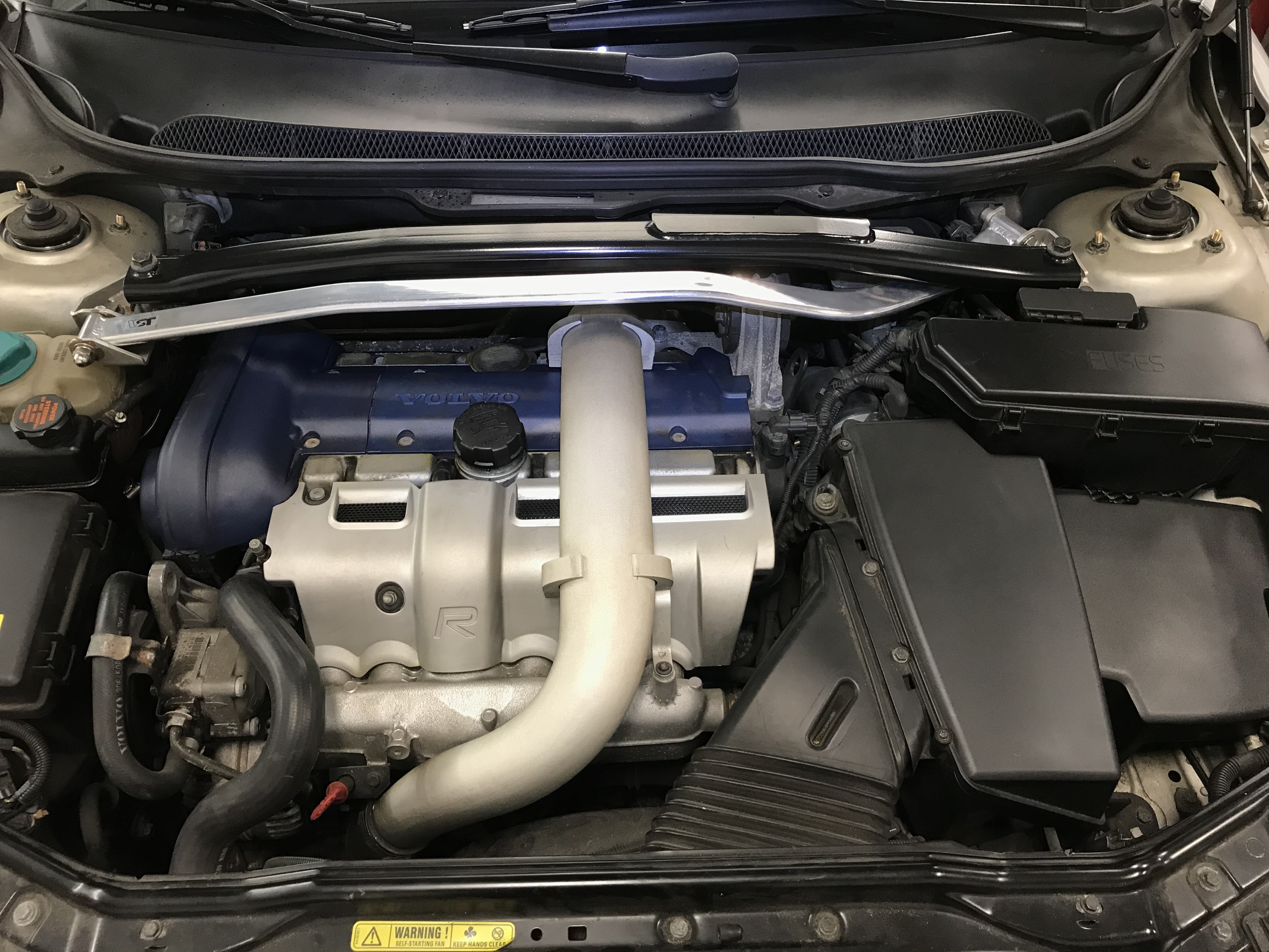

Here’s what I ended up doing to the car. The only two things I missed during my initial “inspection” of the car (on a Minneapolis city street) were the passenger side tie rod end link & a drivers side ball joint.
The rest I used as a bargaining chip to get the out of pocket way down.
Overall it’s about as close as you can get to a perfect VR (up here, anyway). I’d never be able to afford a perfect one that already had all the important stuff addressed on it.
