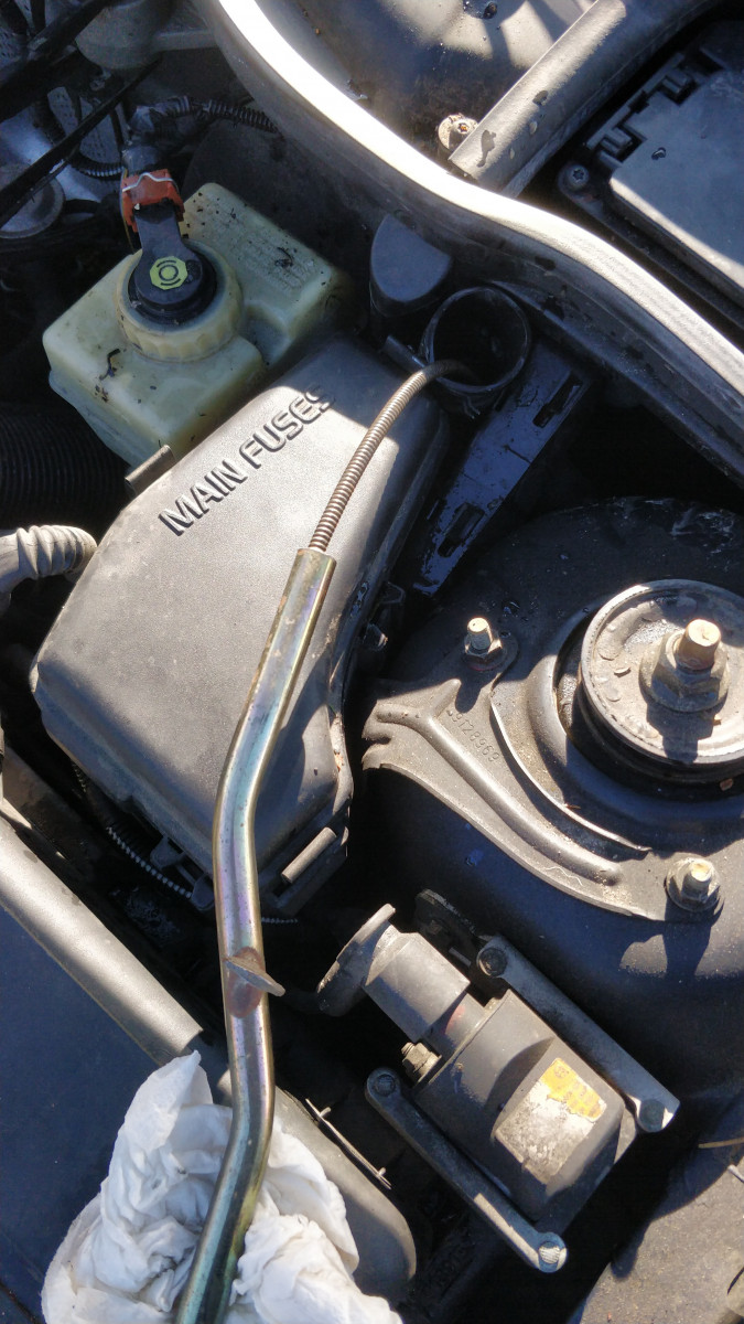

Hi all. I have a 98 V70 GLT. I've been experiencing water in the foot well on the driver's side. No leaks from the sunroof, so I thought I'd dive into drains in the outside of the firewall near the wiper mounts. Passenger side I just pulled out and cleaned and replaced. It was VERY clogged with general detritus. The problem is with the driver's side drain. I can't get anything to get through it. I've tried high pressure water, a plumbing snake, coat hanger.... The issue is the bend in the tube as it goes around the brake system and the fact that I can't get under the car to get to the tube from the bottom... Any recommendations on how to clear it? Drano? I could remove it, but I can't get my hands in there too be able to put it back (probably). So I'm avoiding doing that. Might just put a new drain tube in, zip tie in place, and call it a day. But I'll take suggestions. I've got some time with the Covid lockdown. Thanks!

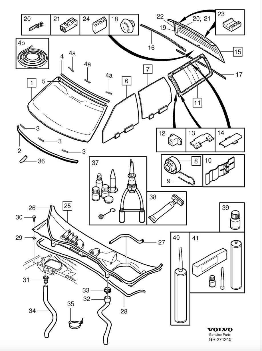

Never would have found this without your earlier post on bowed plastic channel, or 'Draining channel' in VolvoSpeak

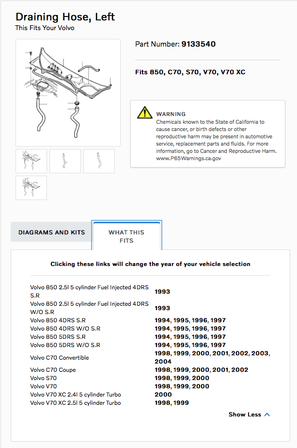

Drain tubes are different left/right but fit any P80, so it appears.
They install upside down in AUS markets, of course

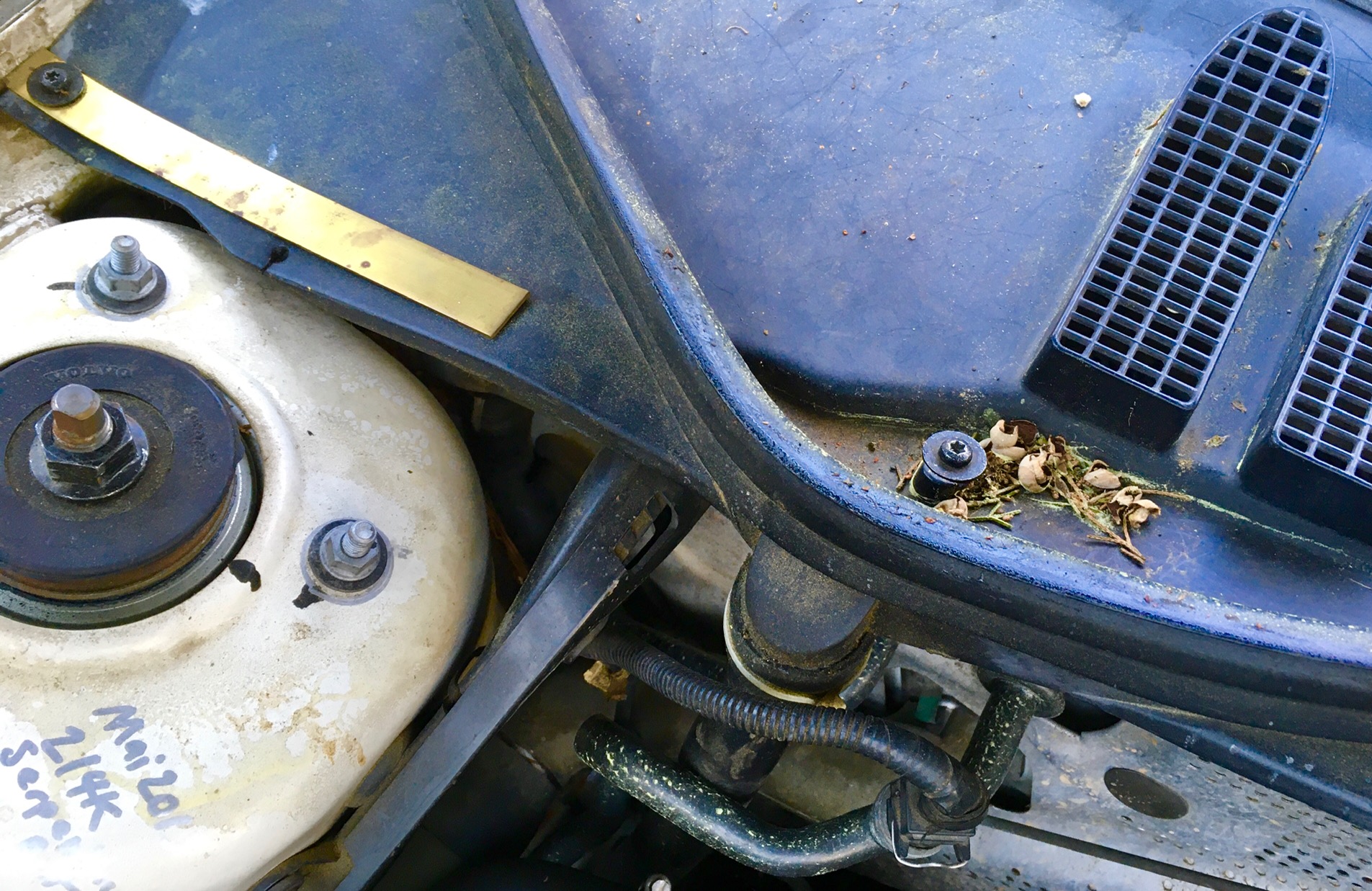

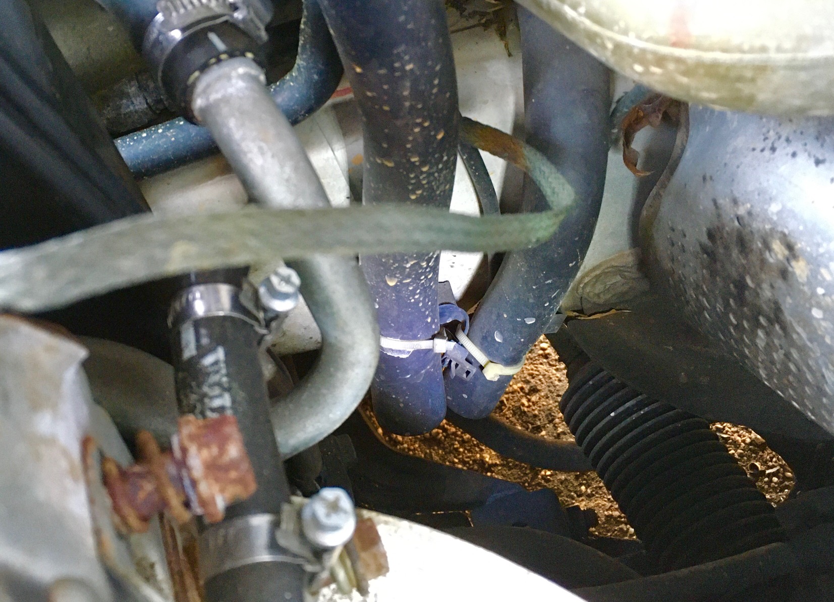

This image shows the left hand drain line... standard connection up at the cowl. Th image below shows two of the drain lines on the left hand side, down by the steering rack. The black zip tie in the middle is the original Volvo tie that went thru the two hoses. The problem with that arrangement (in my experience here in NC where we get a lot of tree pieces raining down as shown in the first image above) is that the zip tie causes blockage because it creates a spot in the middle of the hose that catches and holds debris rather than letting it fall all the way down and out onto the ground. I wrapped the white zip ties around the outside of the hoses and around the original black zip tie to hold them in place. It has been working well so far for a few years.

Ultimately I took it out of the car. It was so full of crap it took a good swing to get it all out... Then the glorious process of threading it back through, and getting the zip tie back through the holes. I did it all one handed and blind... What a crappy job.
