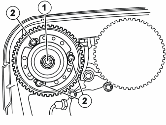

Installing the variable valve timing unit on the camshaft
Note! Oil the center screw before installation.
Camshaft alignment tool installed on rear of camshafts.
Push on the variable valve timing unit/timing gear pulley on the camshaft.
Install the center screw (1) which secures the variable valve timing unit to the camshaft. Tighten slightly.
Slacken off, but do not remove the screws (2) which secure the timing gear pulley to the variable valve timing unit.
Turn the timing gear pulley until the screws at the oval holes are in the center position. Tighten the screws (2) slightly.
Turn the variable valve timing unit clockwise to its limit position so that the unit is in its end position.
Position the upper timing cover
Undo the center screw and continue turning clockwise until the timing gear pulley marking aligns with the marking on the upper timing cover.
Tighten the center screw (1) in the variable valve timing unit to 120 Nm. Center plug 35 Nm.
Installing the timing belt
Note! Variable valve timing units do not have return springs and are easily thrown out of position when the camshaft belt is installed.
Check that the markings align.
Install the belt in the following order:
- the idler pulley
intake cam
exhaust cam
water pump
tension pulley.
This adjustment is to be made with a cold engine.
A suitable temperature is approximately 20 °C/68 °F.
At a higher temperature, for example with a warm engine or a higher ambient temperature, the needle is further to the right.
The illustration shows the position of the indicator when aligning the timing belt tensioner at approximately 20 °C/68 °F.
Note! There are two different tensioners depending on model year.
Fix the belt tensioner center screw in position and turn the belt tensioner eccentric clockwise until the tensioner indicator passes the marked position and reaches the end position. Then turn the eccentric back so the indicator reaches the marked position illustrated. Tighten the center screw. See Tightening torque:Summary of specific components and tightening torques .
Check that the indicator is in the correct position.
Tightening
Hold the center plug at 25 Nm at the same time tighten the 3 x (2) screws on the camshaft timing gear pulley to 10 Nm.
Final check
Remove:
999 5452 from the rear of the camshafts
Install new plugs with new sealing washers. Tighten.
Checking the markings and belt tension.
Position the upper timing cover.
Turn the crankshaft 2 rotations. Check that the markings on the crankshaft and timing gear pulleys correspond.
Remove the upper timing cover.
