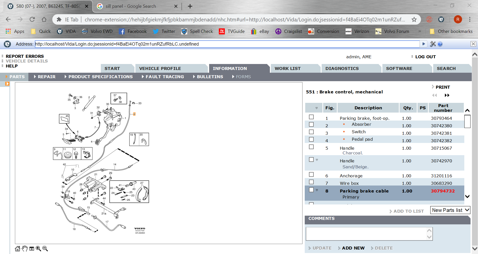

Four! Wonderful. Any idea where the junction of the cable #8 and #14 is? Just wondering how much inside trim I need to take off. Diagram is great. Appreciate it. I need to get Vida!

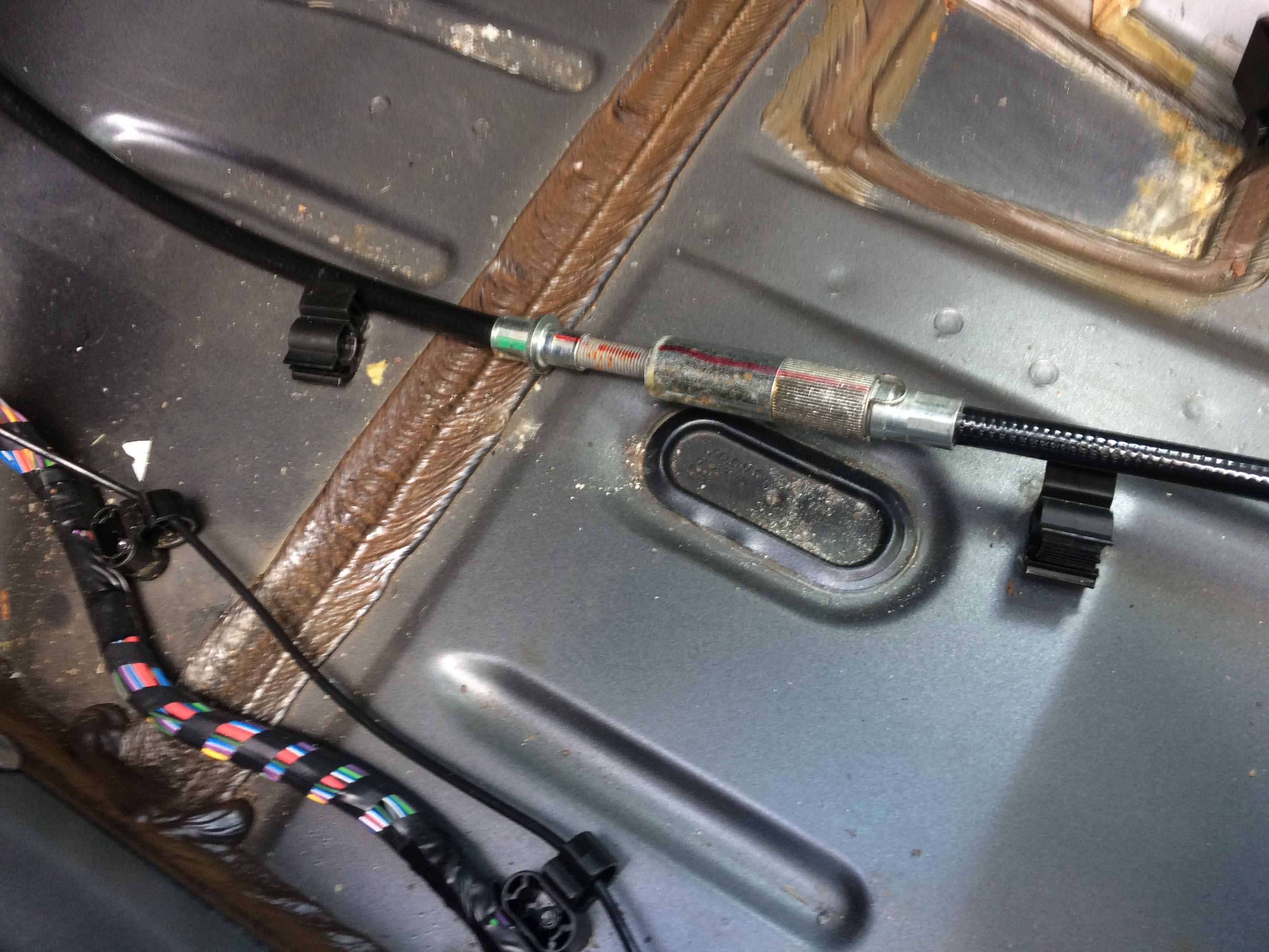

Tried to pull up carpeting in rear seat area. Impossible! It has a very rigid backing that can not be folded. It seems that my parking brake cable does not go under the door sills but heads toward the center console. I am just able to stick my fingers down into the stiff carpeting to feel this bending direction.
Is it possible that the third cable in the diagram posted previously above, connects near the console area to the fourth cable that goes to the pedal? Posting a picture of the failed end of the third cable that joins the left and right cables.

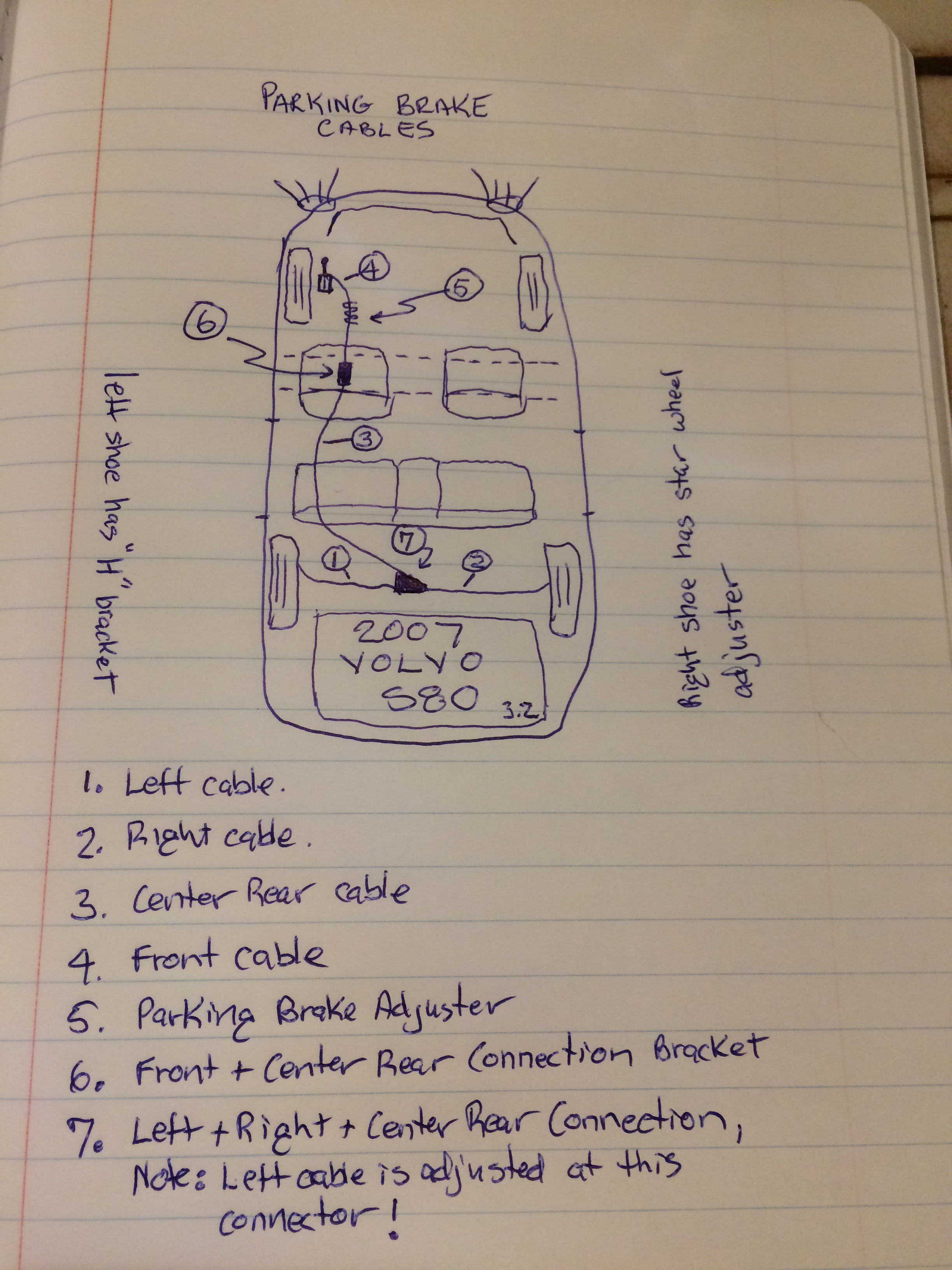

OK, so in preparation for new parking brake cables arriving in mail soon, I started removing stuff in the car to find out where my center rear cable connects (number three of four cables).
Doesn't go under the door sills....doesn't go through the center console...it goes directly from the driver side rear seat, under the driver's seat and connects with the fourth cable (that goes to the pedal) right in the middle of the driver's floor well. Your left foot would probably be sitting right on top of the parking brake adjuster gizmo while driving!

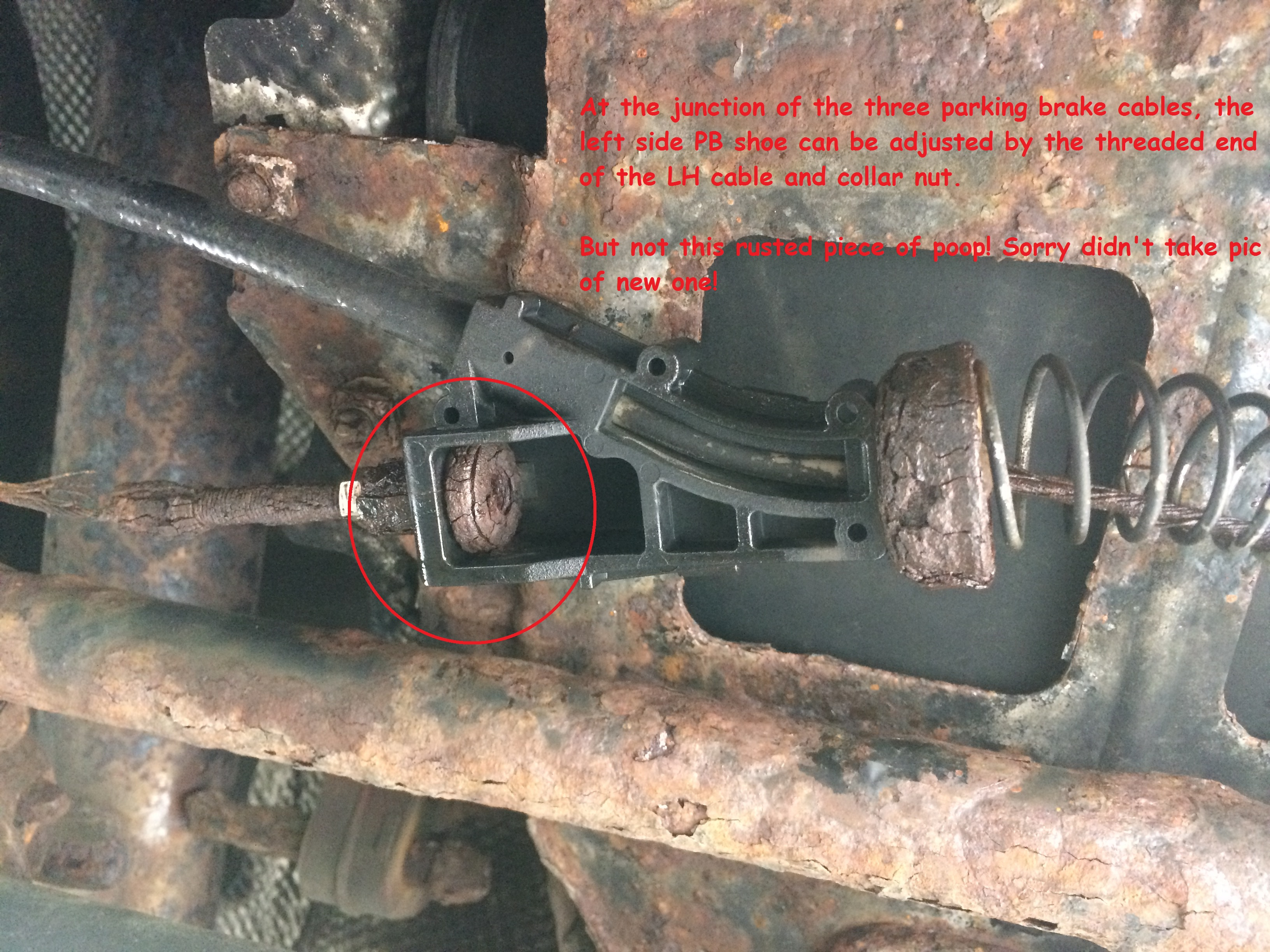

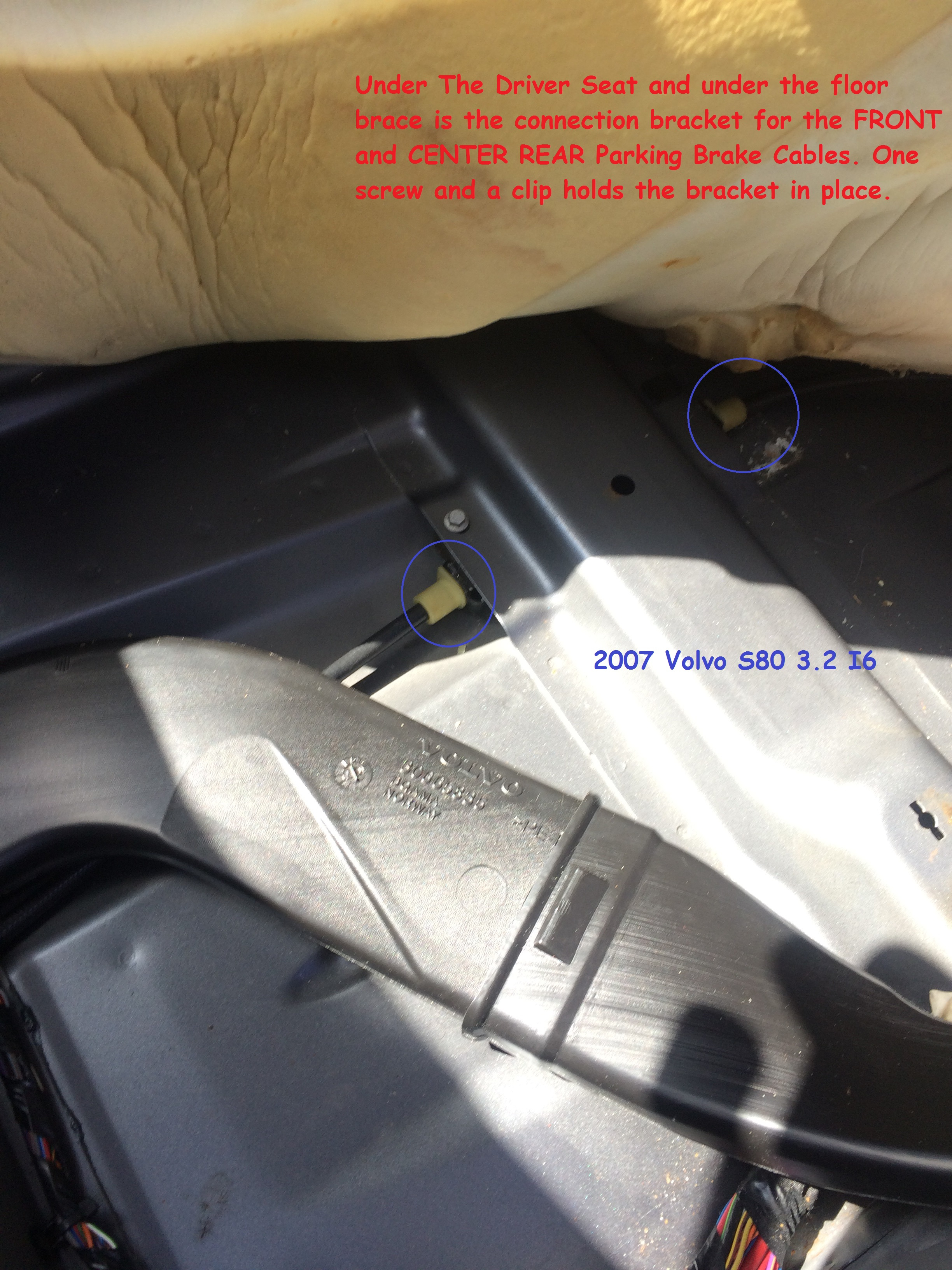

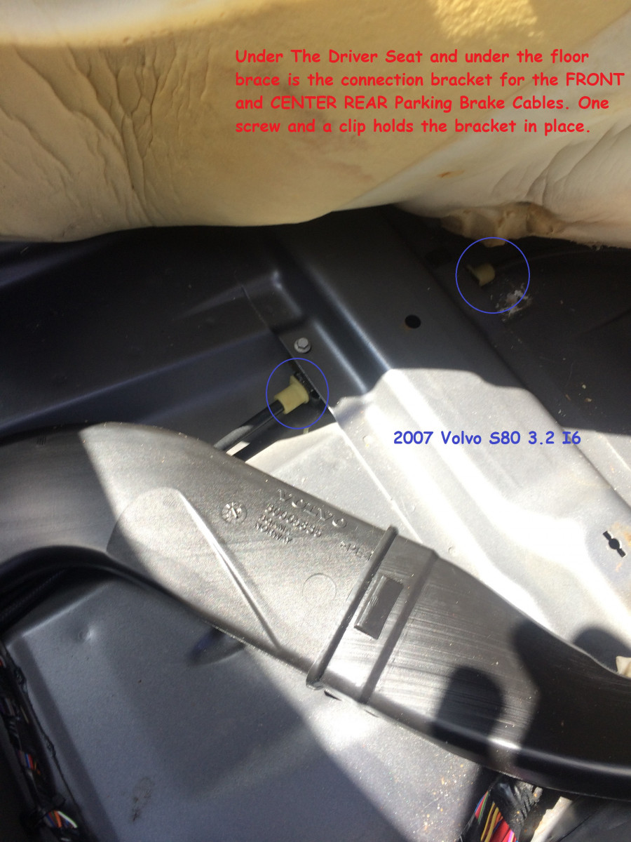

Installed three new parking brake cables; left, right and center rear cable. I was surprised to find out that the junction of the center rear cable and the front cable, which I refer to as the coupler bracket is directly under the driver's seat hidden beneath the floor brace (not in the middle of the driver foot well...that's the PB system adjuster).
One screw and a clip holds the front and center rear coupler bracket in place. Remove the two hold down floor clips for the front cable to allow it to move freely, remove coupler bracket screw and slide the bracket to the rear to detach the clip, slide the bracket forward from under the floor brace to expose the cable coupler. Detach the old center rear cable (which I'm replacing) and attach the new one. In the attached picture you can see two yellow collars, one for each cable. These are fitted to the bracket.
I've included a picture of the parking brake system adjustment socket\barrel gizmo. I played with it a bit but didn't adjust it as I didn't know how the new cables would behave. This adjuster affects the action of both brake shoes and the PB pedal travel.
On my car I had the "H" bracket on the LH parking brake shoe system and a star wheel adjuster on the RH parking brake shoe. I left the RH star adjuster alone, but did adjust the LH brake shoe using the threaded cable end and the collar nut in the plastic cable junction coupler! I didn't take a picture of the new one, but if your's looks like my rusted one then you might need to install a star wheel adjuster on the LH side too!
