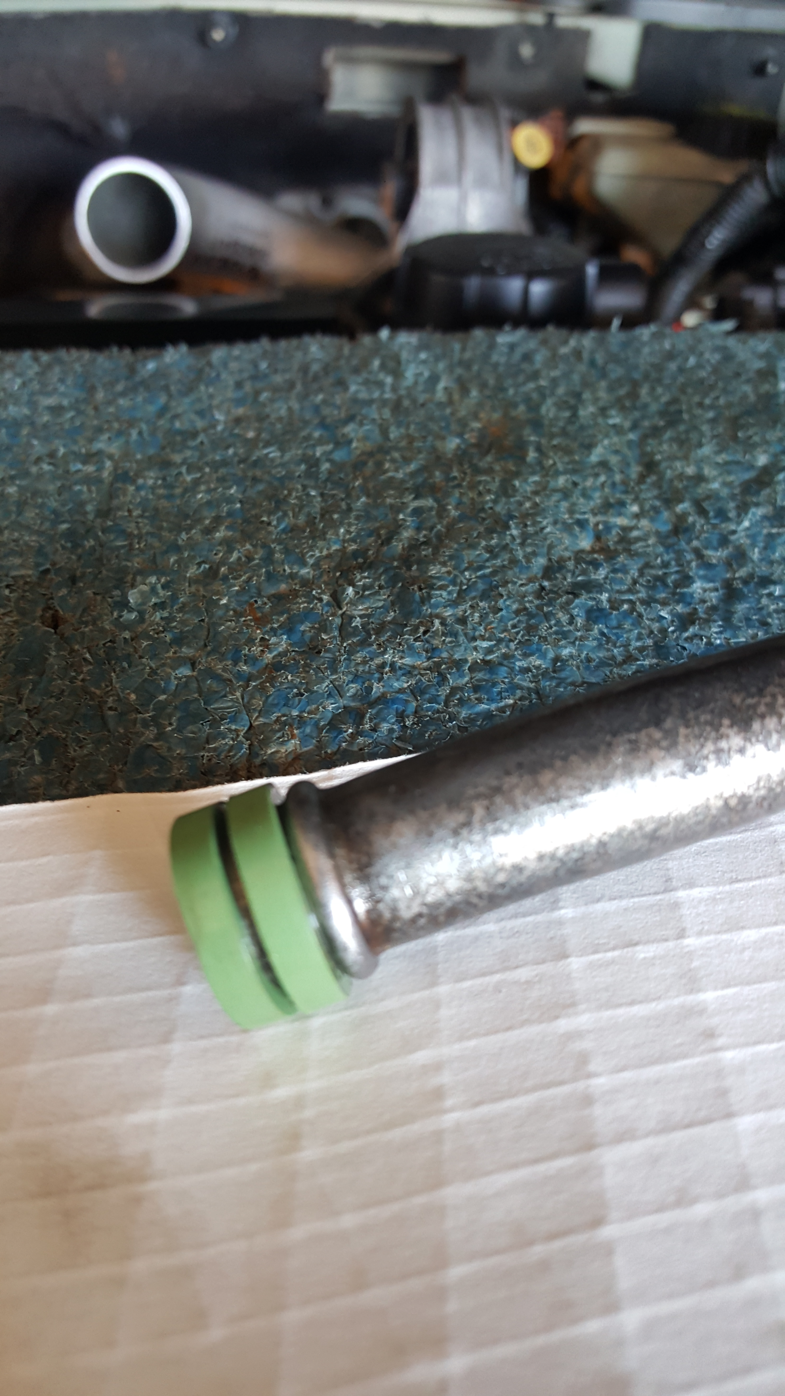

February 28, 2020 I had my mechanic install my complete rebuilt turbos, to include all new provided parts i.e. turbo air hoses and gaskets and a (almost) new OE Volvo Catalylic Converter. Everything imaginable for a mechanic to complete task plus spares parts, extras to complete the job 100% plus some. Unfortunately he didn't do a very good job. He scrapped off my new Volvo Catalytic Converter Gasket - Volvo OE: 30677358 off the turbo housing and claimed the inner flange lip in the turbo housing allows the cat converters pipe to insert and seal without the requirement of a gasket. (U.S. Volvo told me different) As he said it leaked exhaust gases after he fully torqued with the gaskets so he removed them. Then he couldn't find the lower 02 sensors I provided, and couldn't removed the originals from existing cat converter, so he plugged them. Told me I needed to find the 02 sensors and bring the car back. Paided $800 and took my car home losing about a 1.5 quarts of oil [ 3.5 miles] because the left side (driver) tubo oil drain line wasn't properly installed. The gasket was pinched...I removed original lower 02 sensors off the original cat converter myself with a 22m wrench with a slight tap of a rubber mallet. I had spares 02 sensors and turbo oil drain line gaskets thank goodness. I returned to the 3 Stooges repair shop, the bag of 02 sensors I originally provided magically reappears...I informed them of the oil leak. Several days later car was ready. Picked up car paid additional $150 for 02 sensor installation only to discover a makeshift steel exhaust coupler in the Intercooler Plastic Pipe (Volvo 9161701) He told me he had to rotate turbo assembly (left-driver) downward so the oil drain line would fit more snuggly into engine block and seal and it created a gap bewteen the aluminum turbo air discharge pipe and plastic Intercooler Pipe (Volvo part 9161701) so he installed a metal exhaust coupler in between. Round 2, took my car home and found the coupler he wedged wasn't sealed and it cracked the plastic Intercooler Pipe (Volvo part 9161701), plus in their useless efforts to correct the oil leak he didn't re-install the new turbo manifold (3) exhaust gaskets. To pissed to argue with the the 3 Stooges of Dickson Motors & Body Shop of York Pennsylvania 17403 so I took it another shop recommended by a good friend. The owner concurred Dickson's cracked the intercooler pipe in their makeshift assembly, they didn't installed exhaust manifold gaskets (left-driver) and after spraying the block with several cans of brske cleaner they discoverrd the oil drain line from turbo was in fact leaking at the block-like if it was missing the round gasket. He showed me on his cell phone the video footage of performing a smoke machine test, clear as day indicating the intercooler (plastic pipe) and turbo exhaust manifold area discharging the smoke test. The shop that performed the investigation quoted; HE WOULD HAVE TO DROP THE TRANSMISSION @ a cost of $1500 to install lower drain seal and do the manifold gasket. The legal side of this I'll handle in court later, but it's not helping me at the moment.
MY QUESTION? Is there a step by step on how I can accomplish the repair myself? I have the jack stands and floor jack to elevate about 2ft., off the garage floor. All the tools, offsets, claw wrenches, etc.
I've removed a set of the same turbos 6 months ago from a salvage yard and they were a bit challenging, but not impossible.
I've removed and installed a new cat converter a few years ago on this car, so a challenge doesn't frighten me, its the $1500 for dropping a tranny to do the seal I find a hard pill to swallow.
NOTE: With CoronaVirus epidemic most shops in my area won't reopen until after April 30, 2020, but I need it done now like ASAP, Which means I'll need instructions on how to do that right turbo oil drain seal in the block. A "DO-IT-YOURSELF" guide.
Please Help....

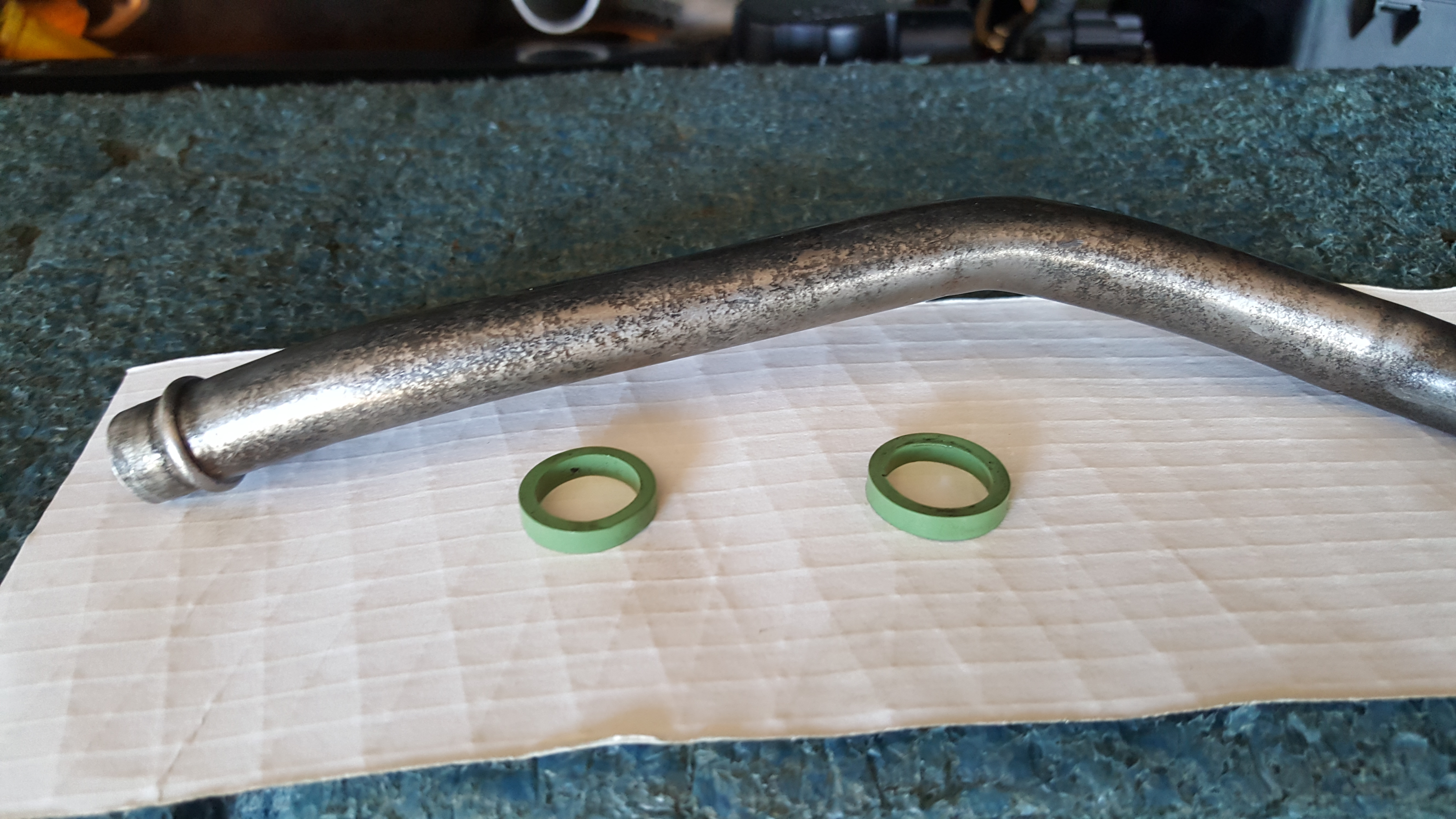

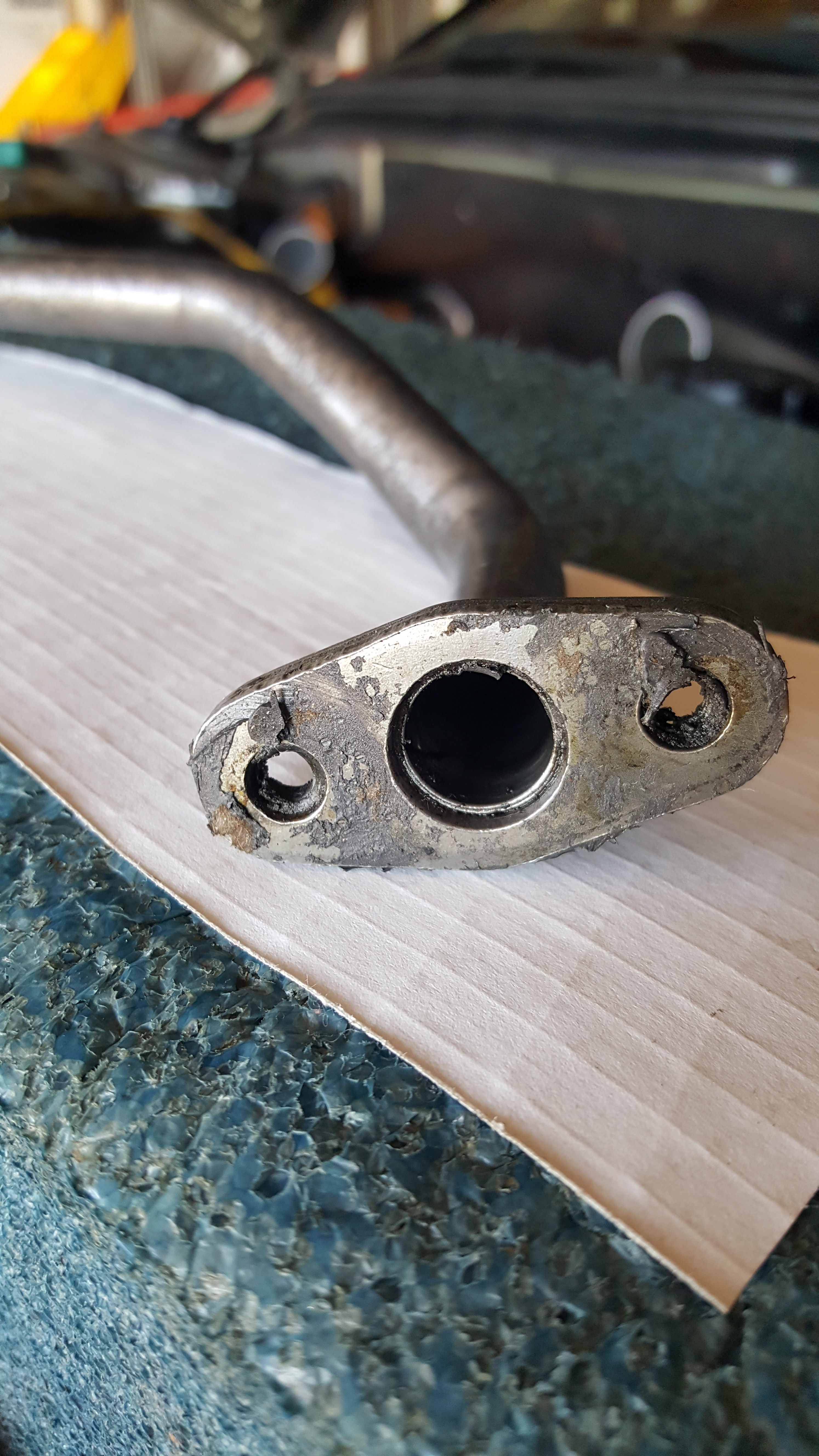

To remove the turbo drain line, which is what it sounds like the part that is leaking, you have two torx or allen head bolts that tie the hard line to the bottom of the turbo. The other end has a thick o-ring that usually gets stuck in the block where the line drains. Stick your finger in there and pull it out (assuming it is there) - your pinky should work. Process is either remove the two torx/allen bolts from the top, or do it from the bottom with an assortment of wobbles and extensions. If you look up videos for the 2.5 family of Volvo motors the process is the same. Just get under the securely jacked up car with a flash light and find the torx/allen bolts. On my XC90 I did them from above. It is frustrating, but with a 1/4 or smaller driver and various extensions they will come off. Remember what you use and repeat on install - for me I had to approach it differently for each side.

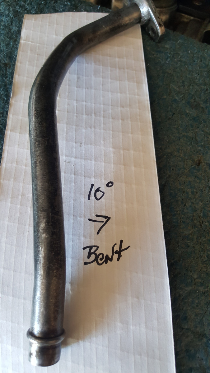

I would wager he bent the drain pipe and that caused the issue. You cannot complete the repair, at least I could not, with the oil return pipe mounted on the turbo. It will come out easy this way, but it cannot be installed this way - at least I could never do it. I think your mechanic tried, bent the pipe to get it to fit - hence your problem. Once the torx/allen bolts are removed one should be able to rotate the drain pipe to create space and then it can be pulled out. Minimal force is needed. The process can be seen in the videos - only access may differ. Upon reinstall put the o-ring on the pipe when you insert it back in the block, then rotate into position. Lining up the gasket holes can be a challenge. You could use a gasket sealant if you want to attach the gasket to the pipe - I have done it both ways - with and without. Pick the side you are most comfortable putting the torx/allen bolt back in and start with that side to line it up. Finger tight, then back off 1/2 a turn until you get the other side in. A trick I used the first time was to use two longer bolts of same thread pitch and size and finger tightened them, then removed the easy side and used the correct bolt and tightened it up. Then remove the longer bolt and your hole will be aligned. The oil drain pipe is not straight it has a bend in it - this bend is what allows you to twist it for clearance and to get it into place.
For the gasket - are you talking about the one between the turbo cartridge? That should be there. There is another gasket, that depending on model year and VIN was not installed. I ordered my parts first, the dealer told me I had a gasket, when I removed my turbo it did not have a gasket. So I left it the way I found it and had no leak issues.

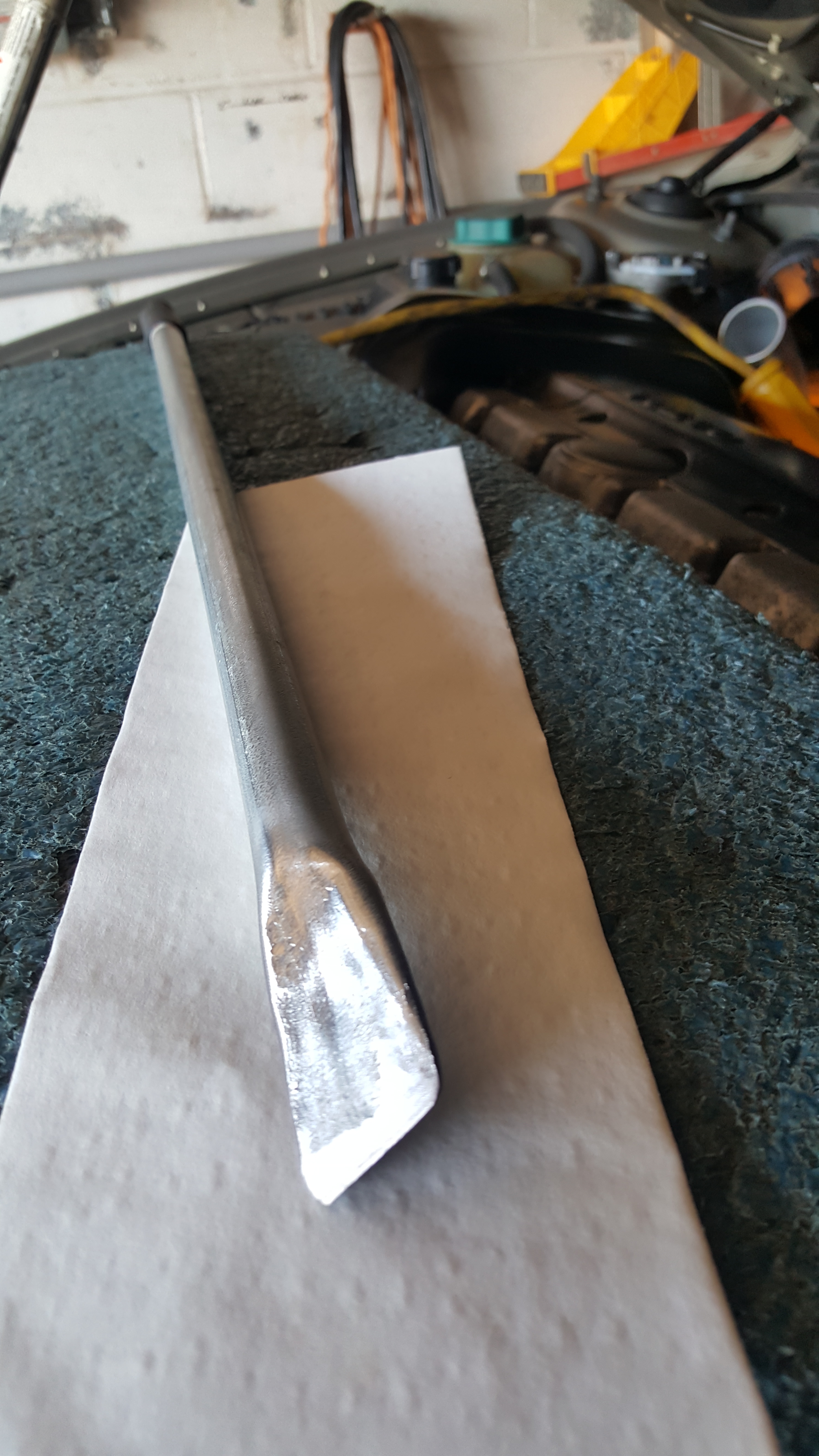

Well after allowing another shop of morons to correct the oil issue, and fail miserable I decided to tackle the project myself (once again doing it the right way the first time) I found it easier using 1/4 drives, extensions and a universal w/torx from underneath the car. I completed the correct repairs that our local latino professionals failed miserably. See images of how two different shops screwed-up, to include double stacking two rubber washers not even rated for oil & temps and their fabulous gasket job of stacking a homemade gasket on top of the old gasket with adhesives, and bending the turbo oil drain line 10 degrees out. Luckily I had several spares. I made a homemade elongated scraper out emt, crushed, grinded to a sharp edge and used it to remove all the old gasket(s) materials. Wired wheeled flange surface area using a drill w/extension. note: a good quailfied mechanic uses proper tools, and doesn't say; "we never touched that" "that not what you said needed done" or simply lies. So therefore those reading this; PLEASE, PLEASE AVIOD THE MECHANICS OF THE CITY OF YORK, PENNSYLVANIA" Their professionals liars with a degree in Ignorance.
