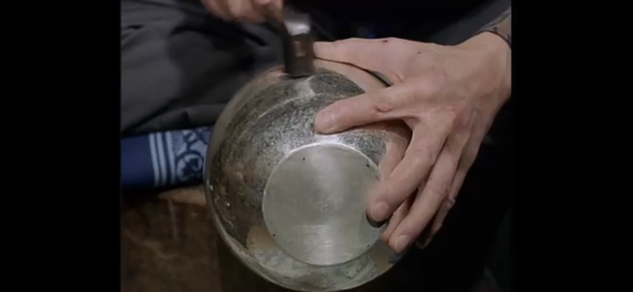

Whenever I start to think I’m talented I see this guy start with an I hit it silver and make this bowl. Allowed tools, a hammer.
