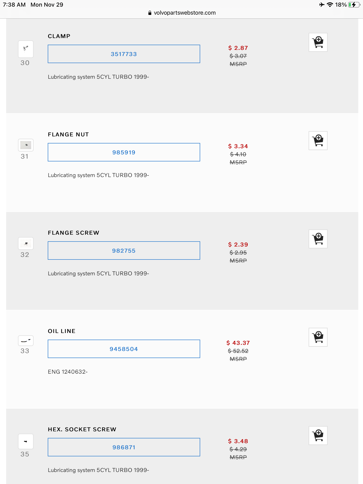

Tabulating part numbers for the 1999 model with biscuit oil cooler, from volvo parts webstore
Note 19b oring is shown as NLA but is the same part as the turbo drain line, which is still available
Posts: 35272
Has thanked: 1497 times
Been thanked: 3810 times
What would complete this thread is someone measuring the
8642559
8642560
Oring dimensions for reference here.
I’ll try look at my stash
