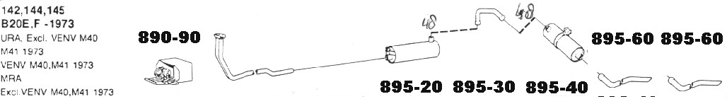

Can the local muffler shop duplicate the stock system? Do they have a pic or details of the original sizes?
Here's an ebay Europe system new -
https://www.ebay.com/itm/Volvo-684198-1 ... 1948156423
https://www.scandcar.com/volvo-140-exhaus/ I see ipd doesn't carry anything but clamps, same with FCP
Scandcar... the funny 90º muffler...
https://classic-volvo.com/exhaust-140-f ... volvo.html
https://classic-volvo.com/exhaust-140-r ... volvo.html
https://classic-volvo.com/exhaust-front ... 80598.html
Yeah, it looks to be those two 90º mufflers and the rest is pipe...
https://classic-volvo.com/exhaust-set-1 ... mount.html

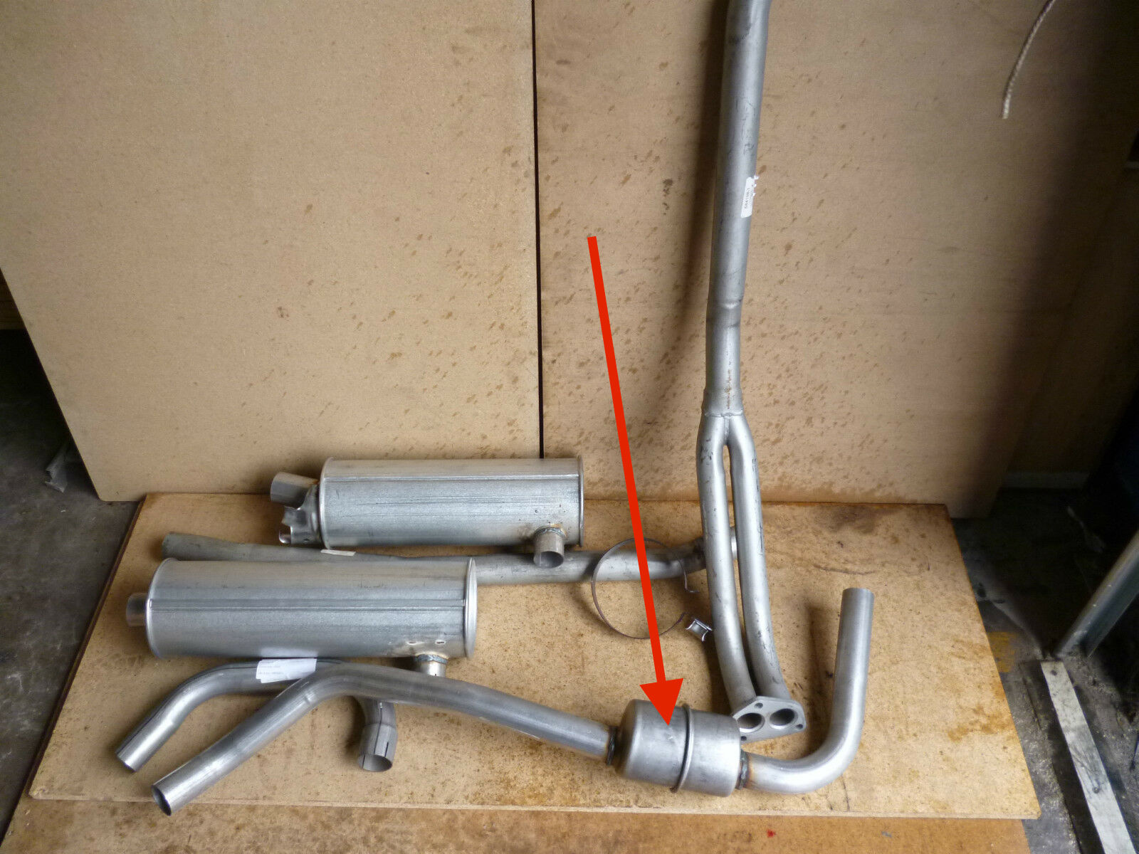

On the ebay system, the only bit I don't get is this little can in what looks like the tailpipe. Is it a tiny resonator? Way back there? In a part of the system where condensation likes to rot things?
- alschnertz
- Posts: 701
- Joined: 29 Apr 2011, 09:25
- Year and Model: 1995 854T
- Location: Connecticut
- Has thanked: 2 times
- Been thanked: 12 times
Correct on all counts.
