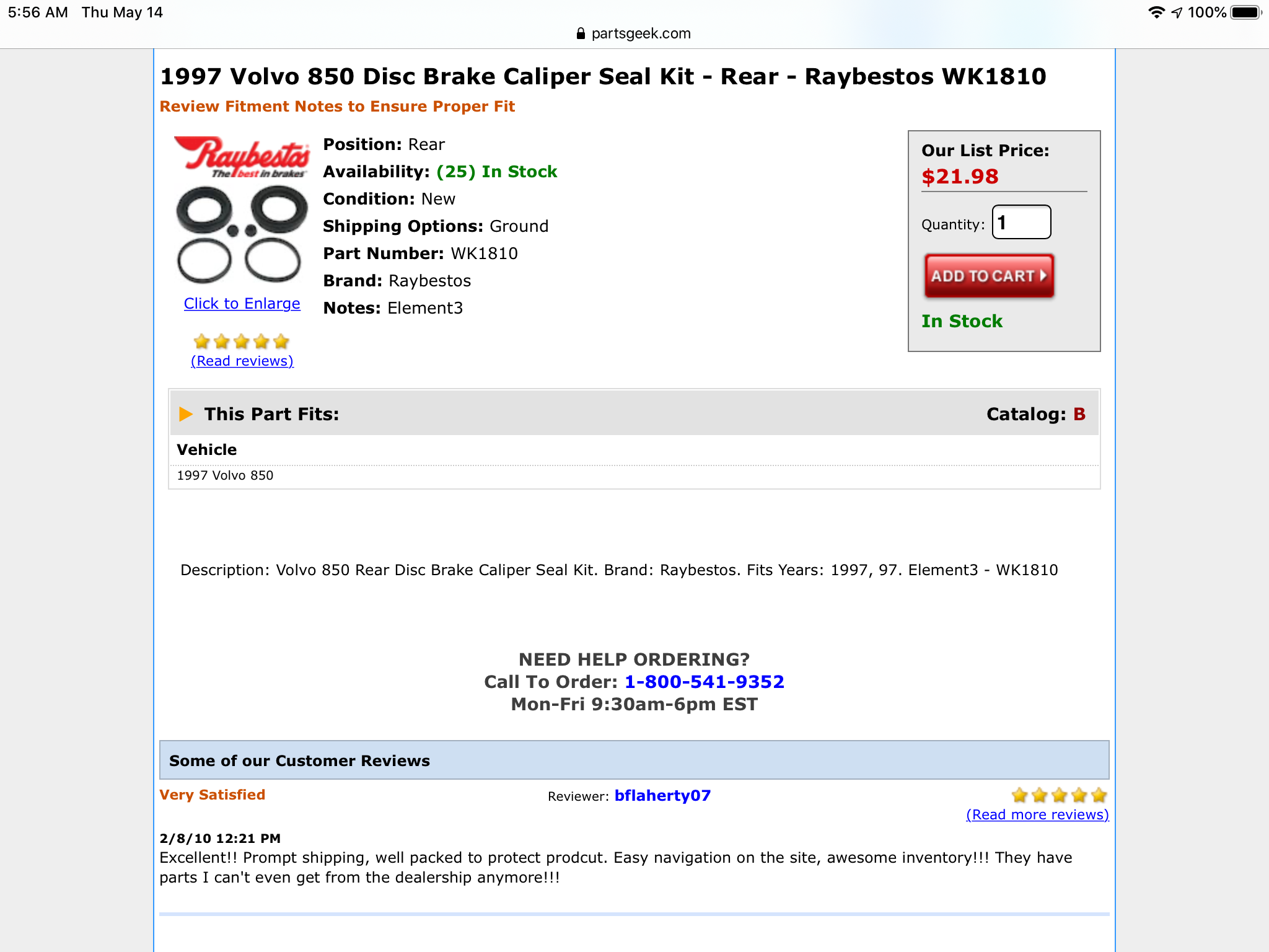

I have a question though,the rear caliper splits in to 2 pieces,where the small holes are so the brake fluid flows from one caliper half to the other and the 2 halves but together is where my leaks were on both sides,should there not be a small o-ring where the small recessed area around each caliper half mounts together?

There are 2 tiny o-rings that fit into the recesses to seal the transfer of fluid between the halves.
You can see them here:
https://www.partsgeek.com/rz2gfry-volvo ... tent=Volvo&

I managed to find 4 small o-rings that fit perfectly in the recessed area where the calipers split,it fixed my leak issue. The image referenced shows the caliper piston seal and piston o-ring seal,the smallest one is the bleeder valve cap.
