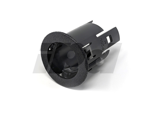

I have done this and remember its difficult, from memory you have to remove the sensor then the ring. I just looked at mine to see if i could jog my memory, first unclip the electrical part then the trim ( picture). i initially tried to pry the unit out whole, the bumper plastic is very soft.
As for the wiring, the loom goes through a hole under the tail light to the module, i dont remember any issues it should be straight forward
