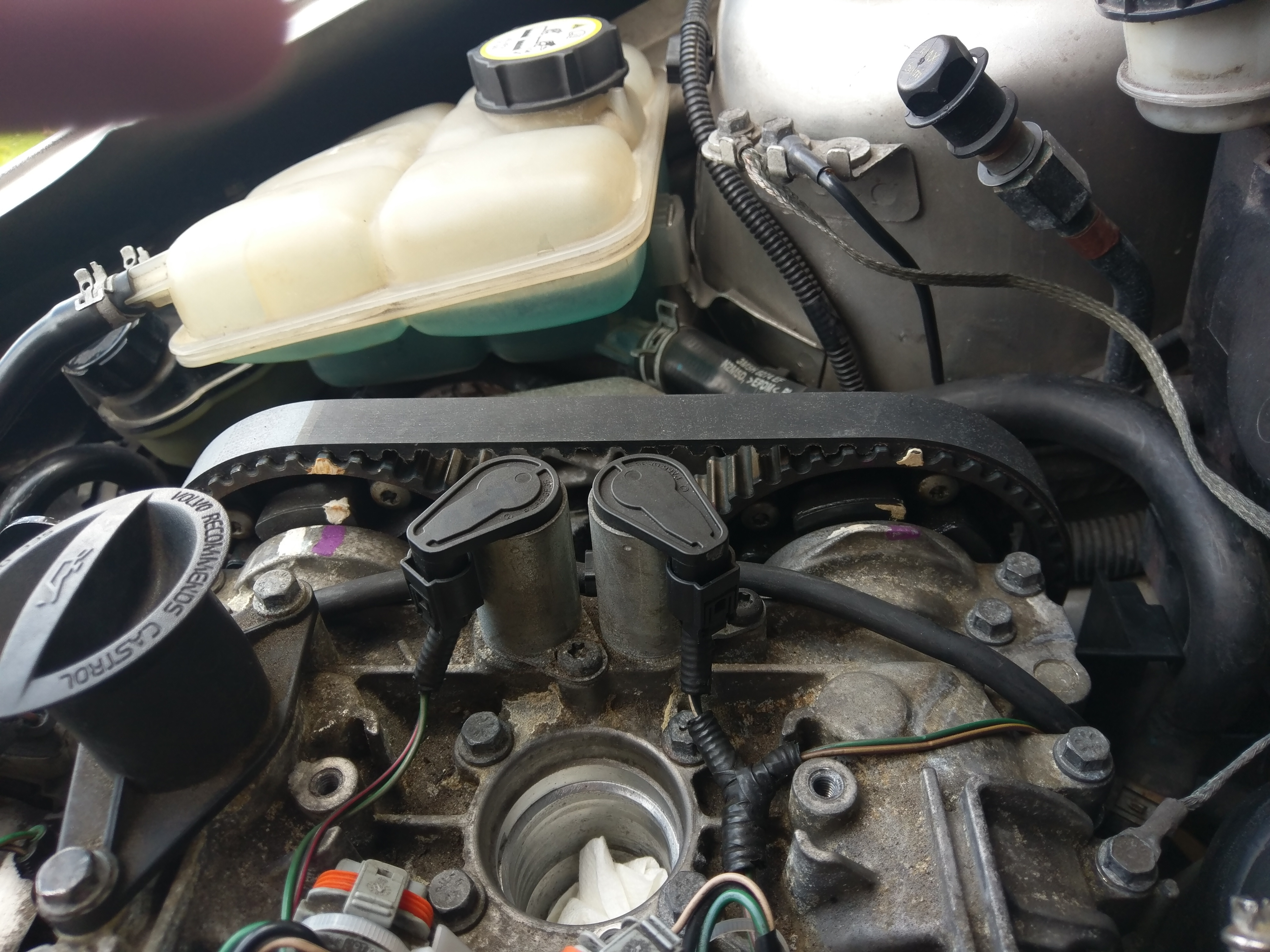

Let’s see a picture of your cams with the cover off

Please see attachment without cover.
Cams
Cams

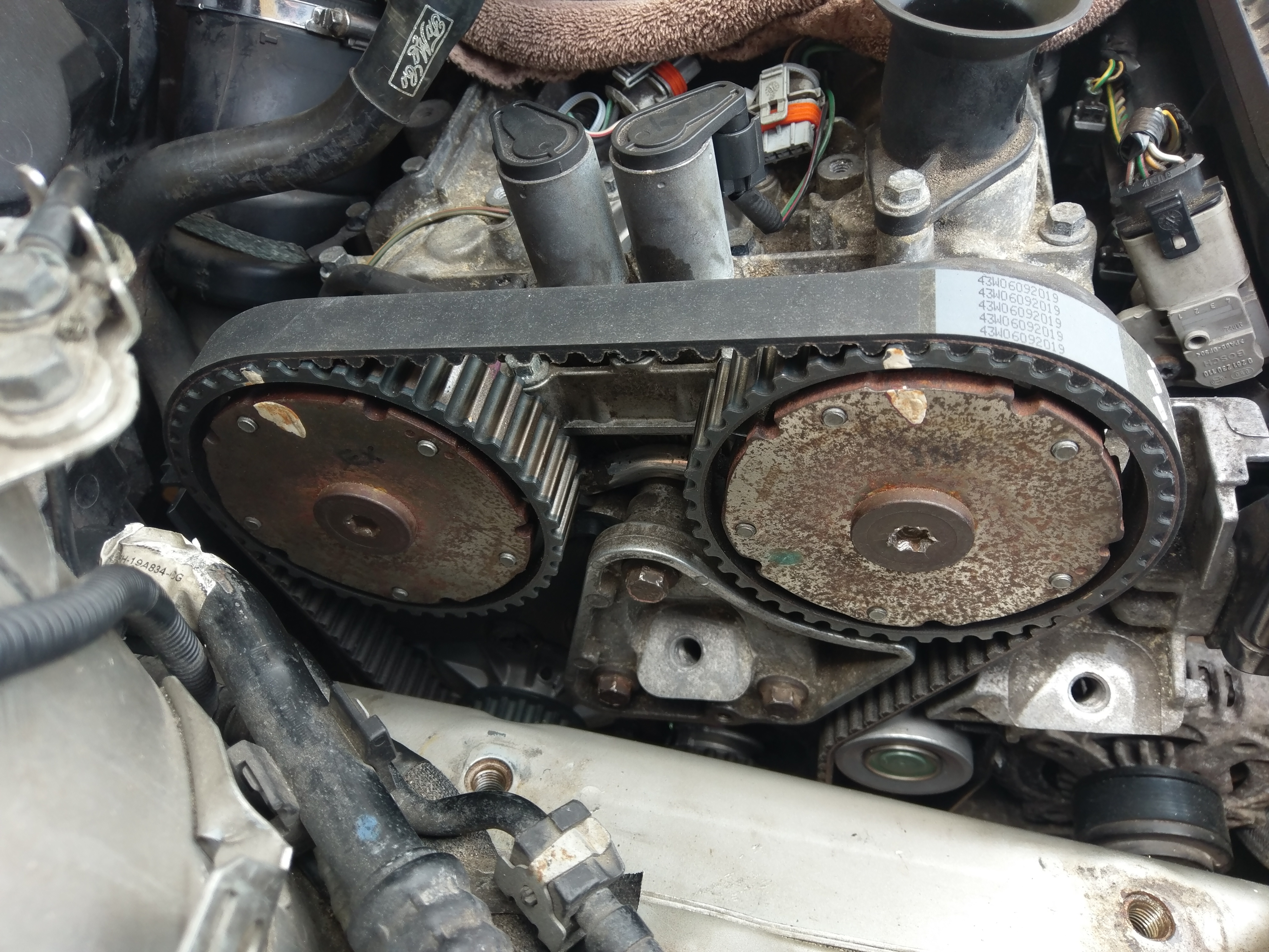

Rotor and back view
Shows rotors from back

You can see the rotors were marked in white and correlate to the pulley teeth which are the manufacturers marks. Because I didn't mess with the vvt. These should remain in correlation. However, the computer says no, lol. The only thing I can think is because the spring is not engaging. I can put the belt on without having to hold the cams at their forward position to the marks.
I assume that's why the motor will fire, rough idle and shut down because the ecm detects it as a fault and thus out of range?
