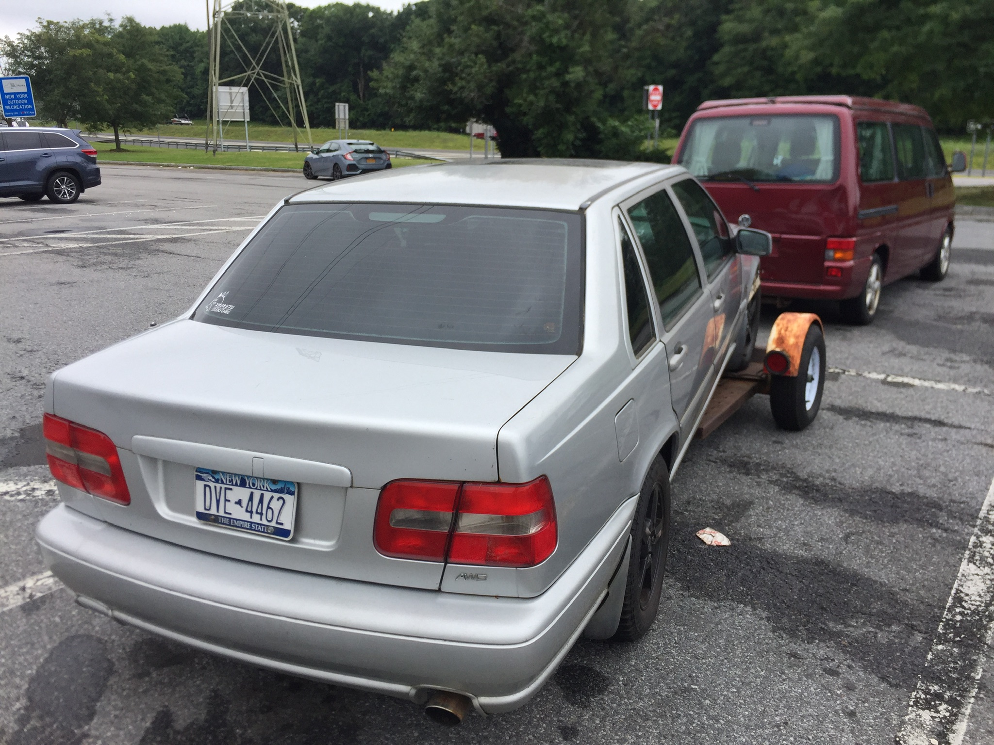

Near blooper.
First rule of dolly towing...check tightness of all the straps.
Second rule of dolly towing..don’t forget to check lugnuts on towed vehicle
Got 5 minutes from the pickup point, and had two Wobblies.
Since I was on a single lane highway in heavy traffic, I zipped them down with my Bosch small impact, drove to parking lot, then mashed then to 125 ft lbs
Luckily I can see both tires in the mirrors
