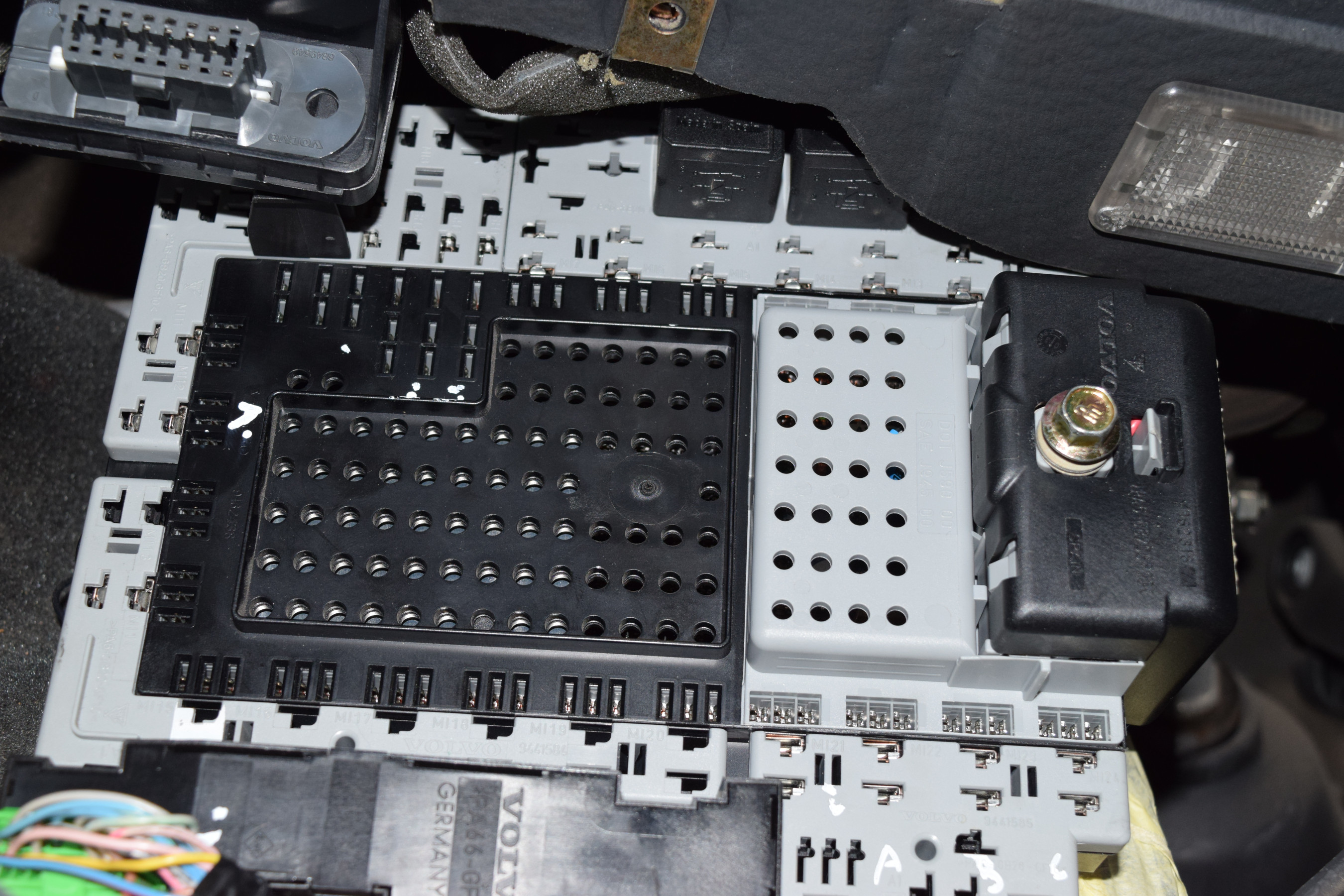

jonesg wrote: 14 Jun 2020, 22:45 Thats the instrument panel, I think Oragex was talking about the module that resides near your knees when you sit behind the wheel.
you are looking for this,
I tried that but I can't unlock the CEM like he does at 3m45s.
Reaching behind it and pushing it forward doesn't work. I've watched the video several times now but either I'm doing it wrong, the mechanism is different, or I'm not pushing hard enough because I fear to break something.

Post by jonesg »
They always make it look easy in the videos, its not real world, they already removed it and put it back before turning on the camera.
In reality it takes a lot of fighting, band aids and cursing.
You disconnected the battery right?
if not, do so.
otherwise, lie on your back with your head on the brake pedal to get a better view.

if not, do so.
I always disconnect the battery when I'm working on electrical parts of the car, shorting things out sometimes damages more than the fuse…
I got it out now, there's an additional clip on the left which the video doesn't show. I found it with an endoscope camera. Seems to be a bit different, also the paneling was different to remove than in the video.

Post by s3bi »
I can't see any traces of water up to this point. I've removed the relays and the shunts.
Should I remove the CEM further from the housing anyway? The connector also doesn't want to come off like in the video after removing the screw…

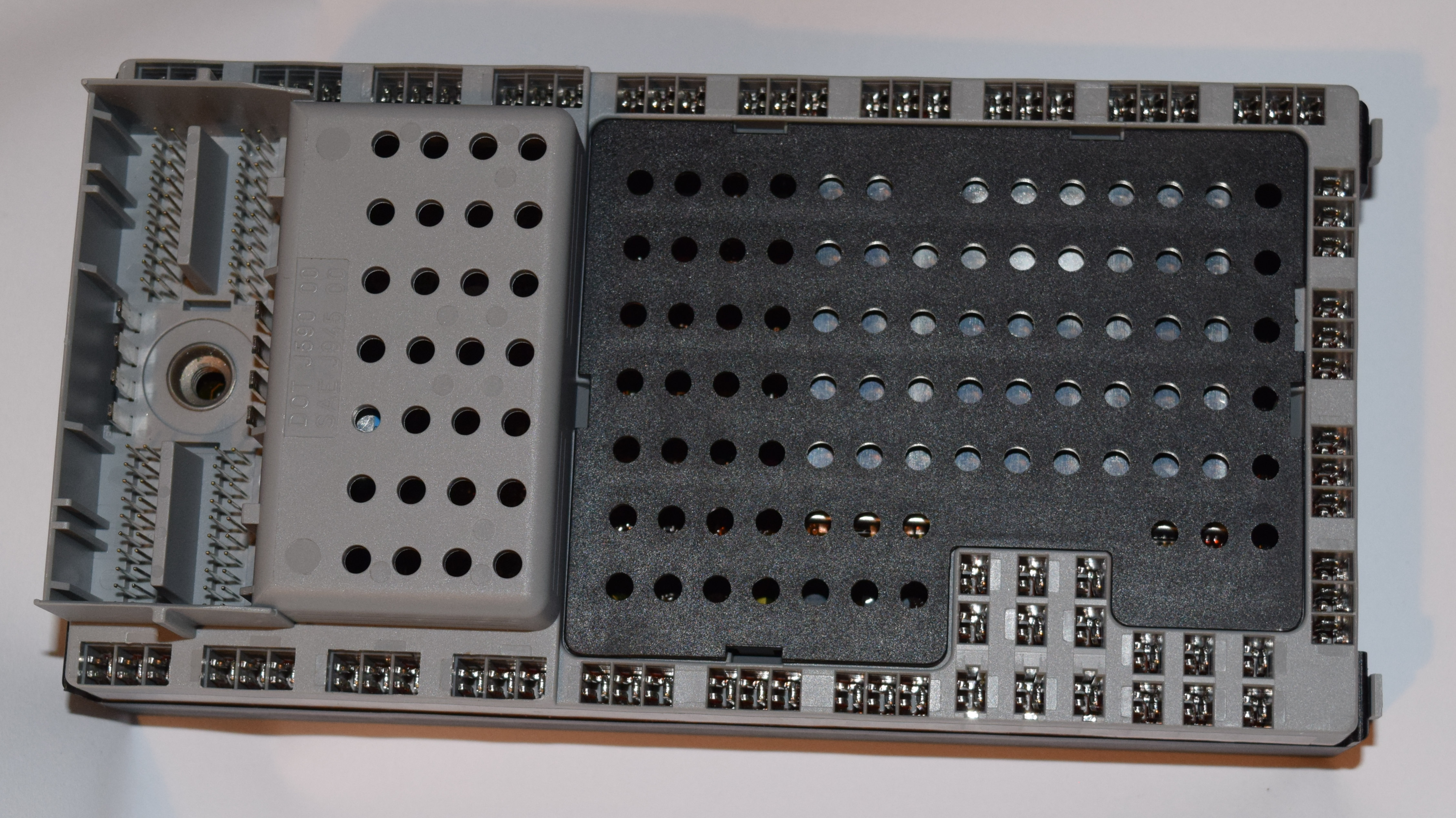

Post by s3bi »
oragex wrote: 21 Jun 2020, 15:12 Don't forget to seal properly under the cowl if you find where the water is leaking
Doesn't look like there was any water leaking at all. No signs of corrosion, I also looked inside the holes with a flashlight and the PCB also doesn't show any signs of something that could be wrong. I think I just reassemble it all now and hope it was a loose connector which makes better contact now after I plugged it back in.
What held me up was the screw of the connector which didn't want to come out like in the video, so I had to carefully slip it over when removing the connector.
