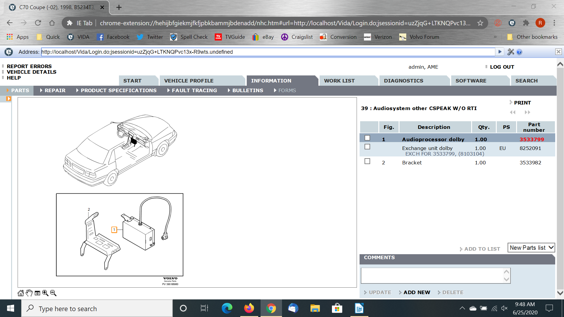

Check and clean the Pro logic decoder connector on the back of the SC-901 head. The decoder is a separate unit. It is not built into the head. While you are at it do the same for the connector to the Amp.

Not the Audio amplifier, the Dolby Pro Logic decoder. Which is under the dash behind the SC-901 head then down on the tunnel. It plugs into the back of the SC-901 head.
Your Dolby is cutting out not the Audio amplifier.

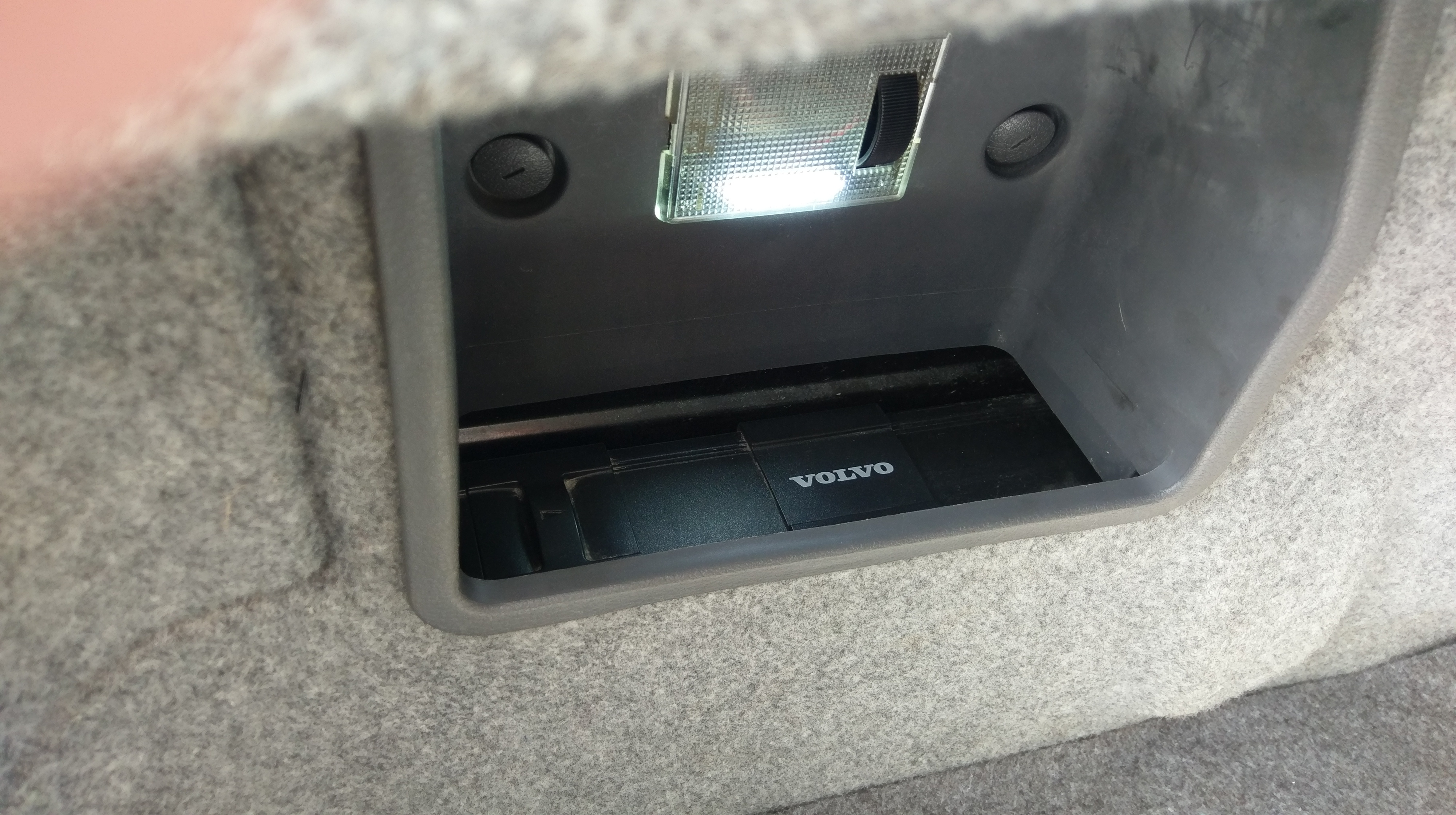

The amp is mounted on the back side of the bracket for the 6 CD changer which is right there where the side pocket is.
You remove the lower half of the side pocket when you install a CD changer in a C70. That is how you get access to change the CDs. The power connector and the DIN cable for the CD changer is there also.
Dolby Pro Logic decoder location.
Audio amplifier and CD Changer location.
