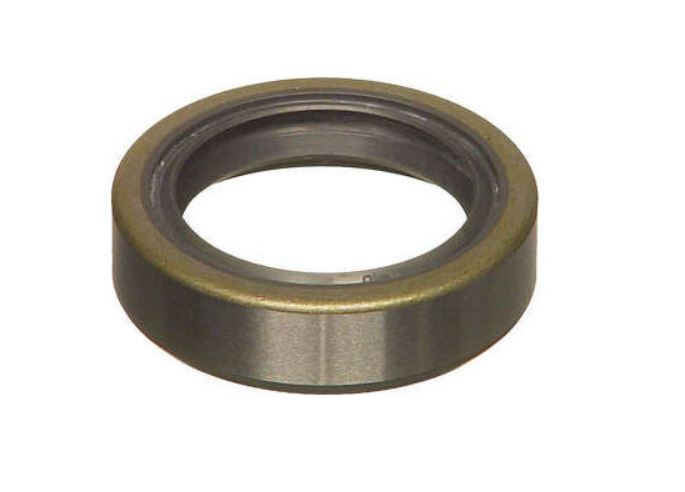

Question: when you say "lip to oil side," do you mean that the surface shown in the attached image will be driven *into* the housing, as opposed to facing outward?

Image below shows the cross section of a typical oil seal. Yours may be different. The round thing in the center is the gaiter spring that holds the oil seal in firm contact to the shaft. This side should go toward the oil (inside of housing). The smaller lip on the left side is the dirt shield. It goes to the dirty side of the housing.
I can't see the cross section clearly, but I think the top side is the dirty side (outside of housing). If installed opposite, it will likely leak.
