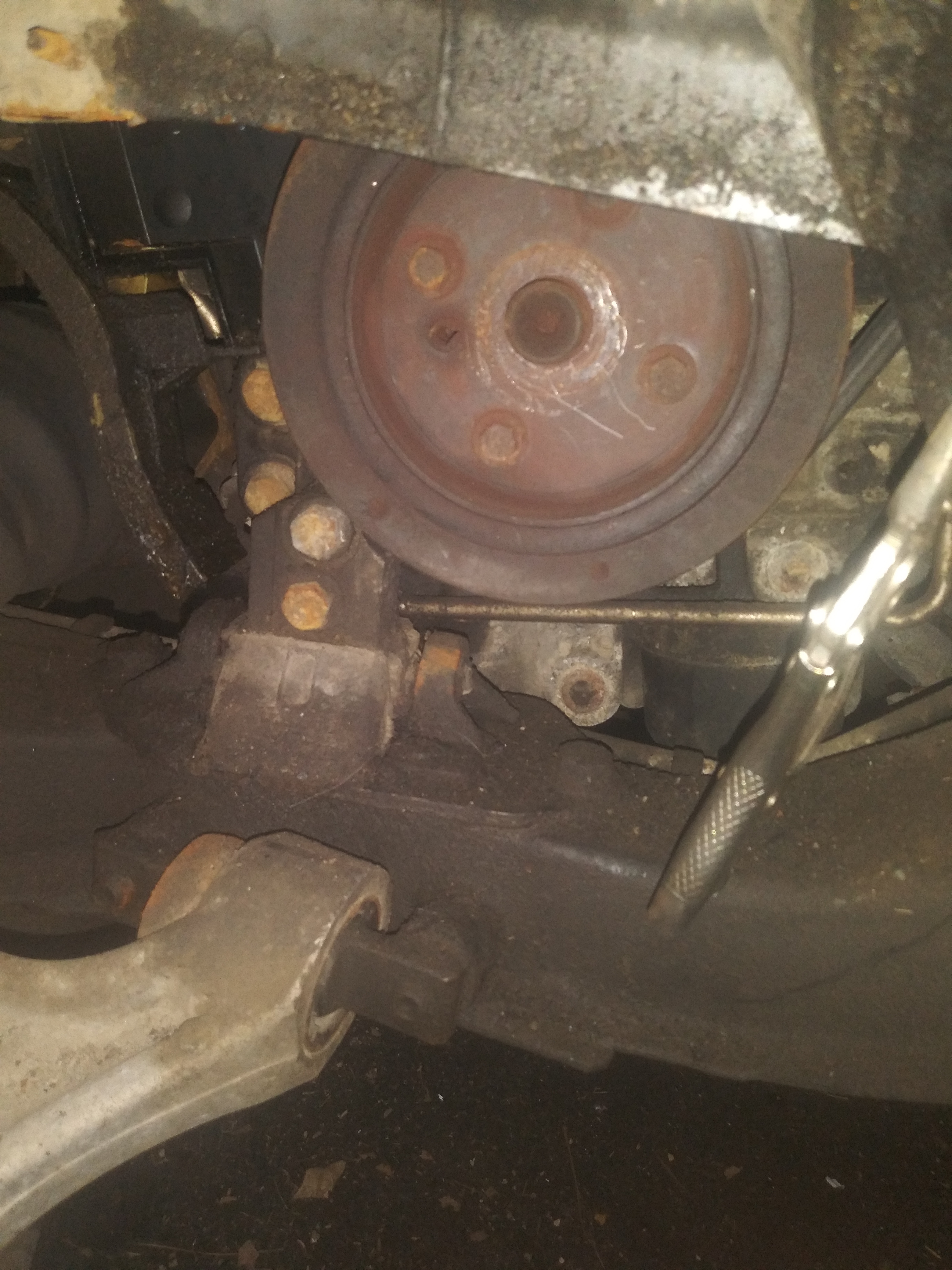

So I thought it a good time to line up my timing marks whilst I'm waiting for the belt tensioner to be delivered.
I grabbed the 30mm socket and went to put in on the crank nut, where is it ?
I know we didn't remove this nut 3 yrs ago when we did the belt and cam seals.
I had a local mechanic do the final timing setup, I wonder if he removed the nut to get better access to the timing mark, supposedly the nut is non reuseable.
If this nut is missing, what exactly holds the crank gear on, the timing belt?
Is this what is causeing the timing belt to wobble, this is crazy.

Your pulley is held on by Rust,faith, hope, and prayer

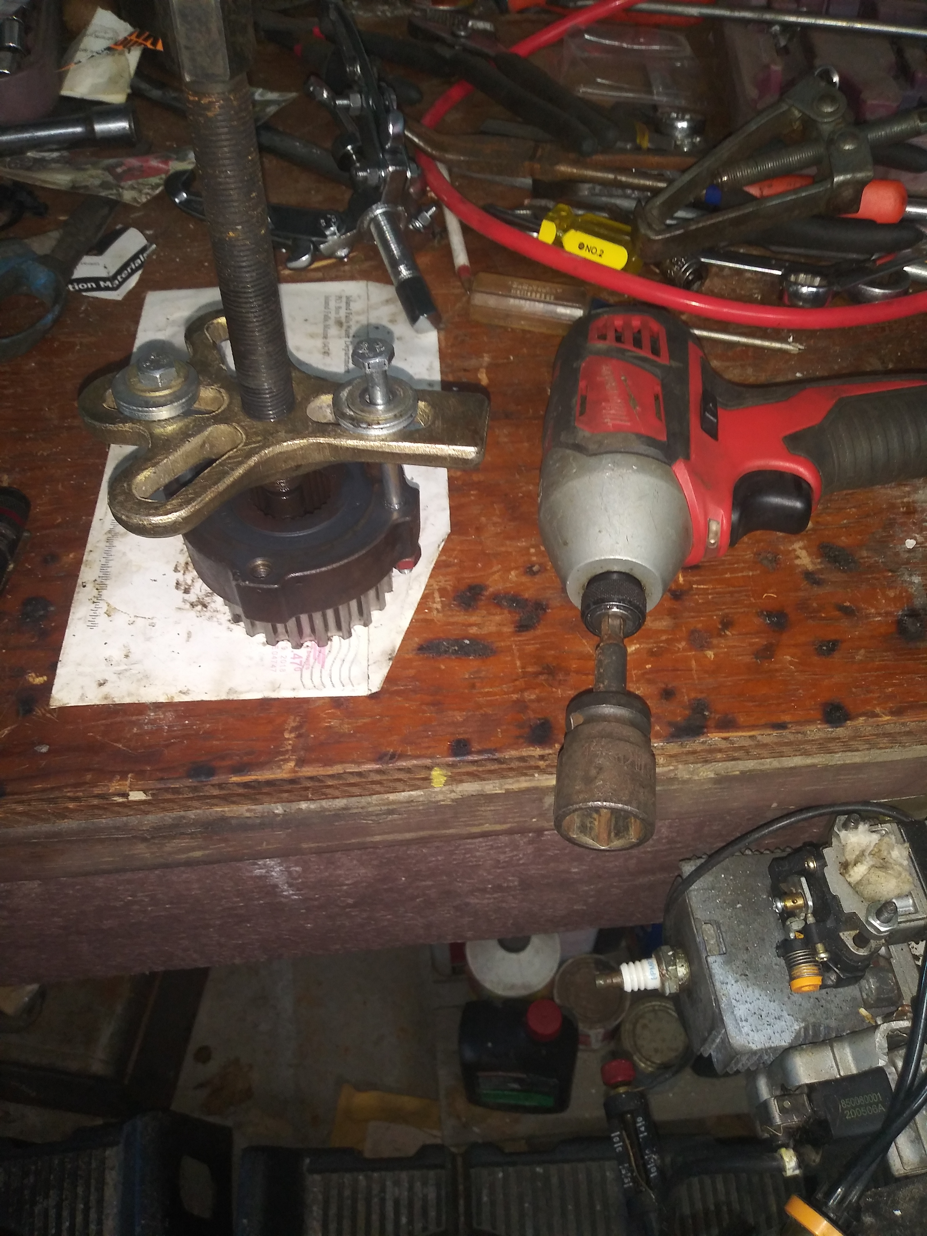

got it,
90 minutes to get the puller positioned, then 5 seconds with the little impact.
Only a short 1/2 inch section of spline closest to block is affected.
wait for parts again.
I think I have a main crank oil seal we didn't install the last time, might as well seeing as I'm in there now.

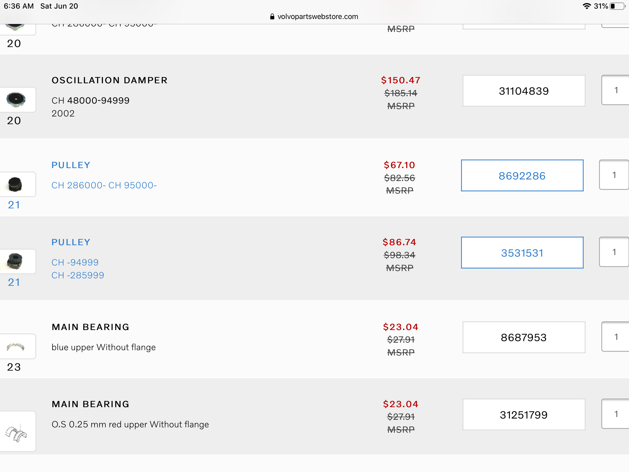

For those playing at home there is a chassis break on the part numbers for the crank pulley hub in 2004

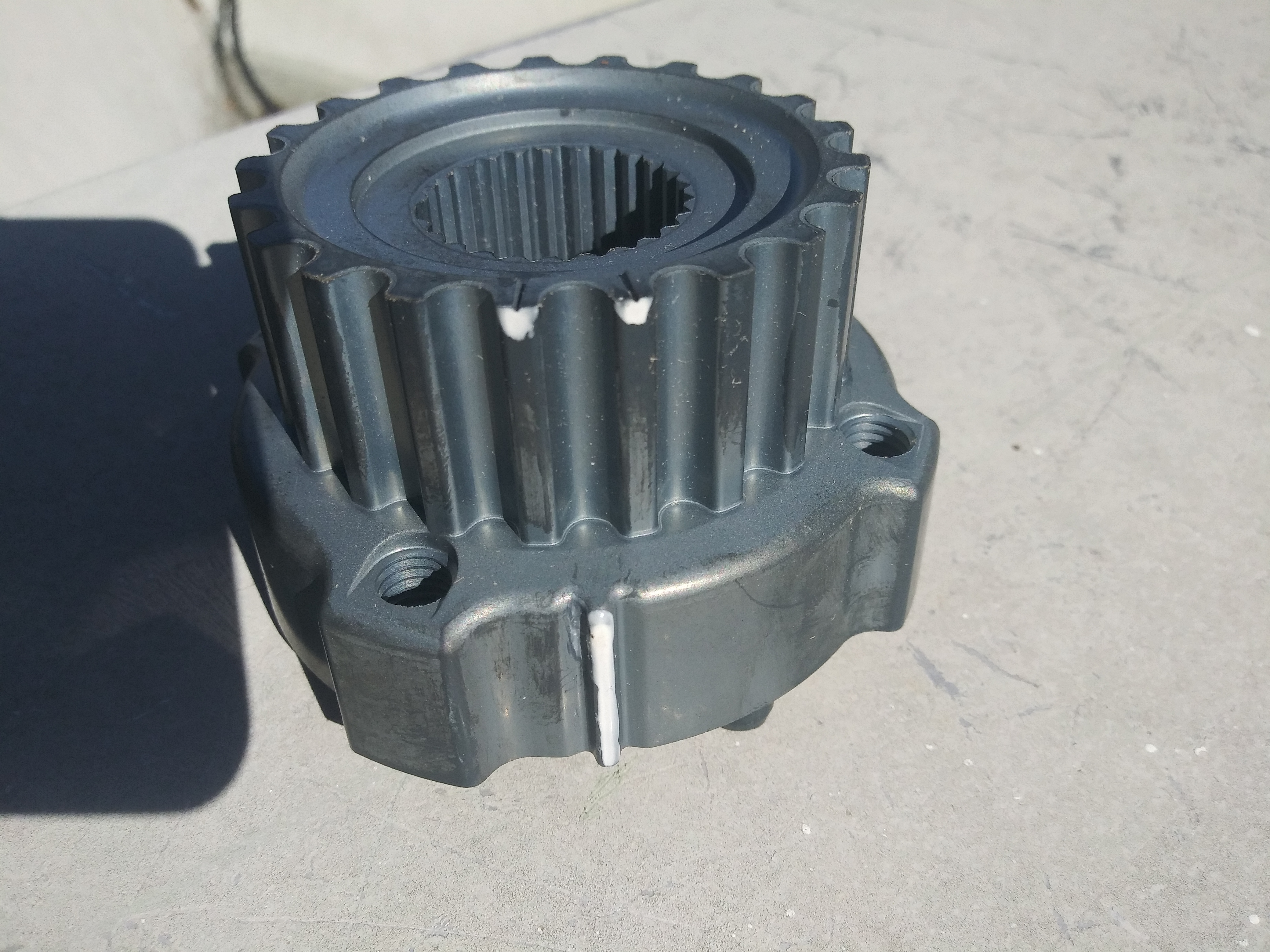

New gear came, I painted the timing marks with touch up paint.
Had to persuade it onto the crankshaft, no slop now.
Blue loctite on the new crank nut.
Idles nicely, no more wandering belt.
I'm considering it solved.
