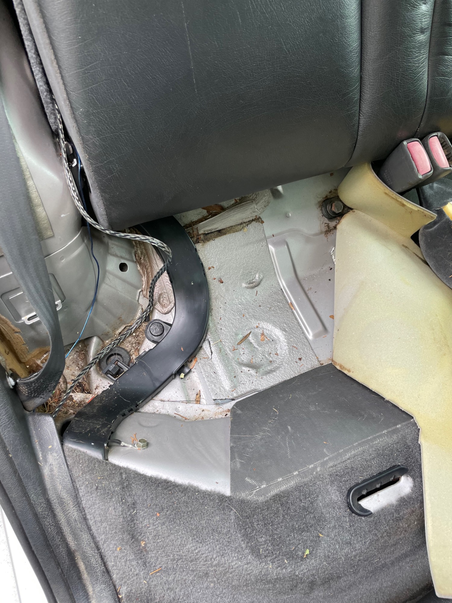

Thread to document where to cut at right rear seat to get to main fuel pump
Robert video link for v70, slightly different
1999 s70 awd Kat fuel pump by hole, no wait, tank drop, no wait , axle drop

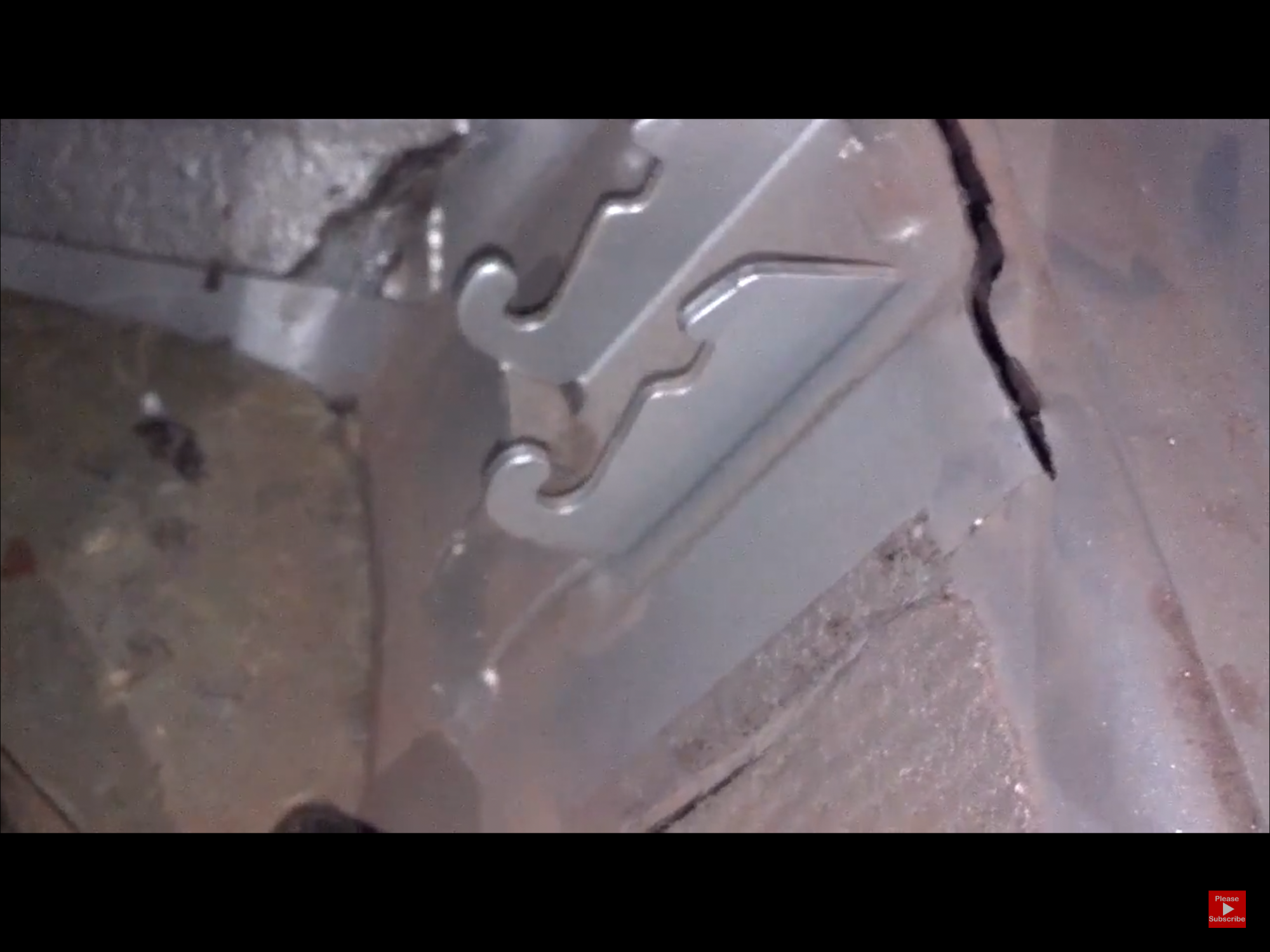

S70 does not have the rear seat catch like the v70

The S70 floor plan is different than the v70 bit lots of good info here , including cross reference to aftermarket pumps!

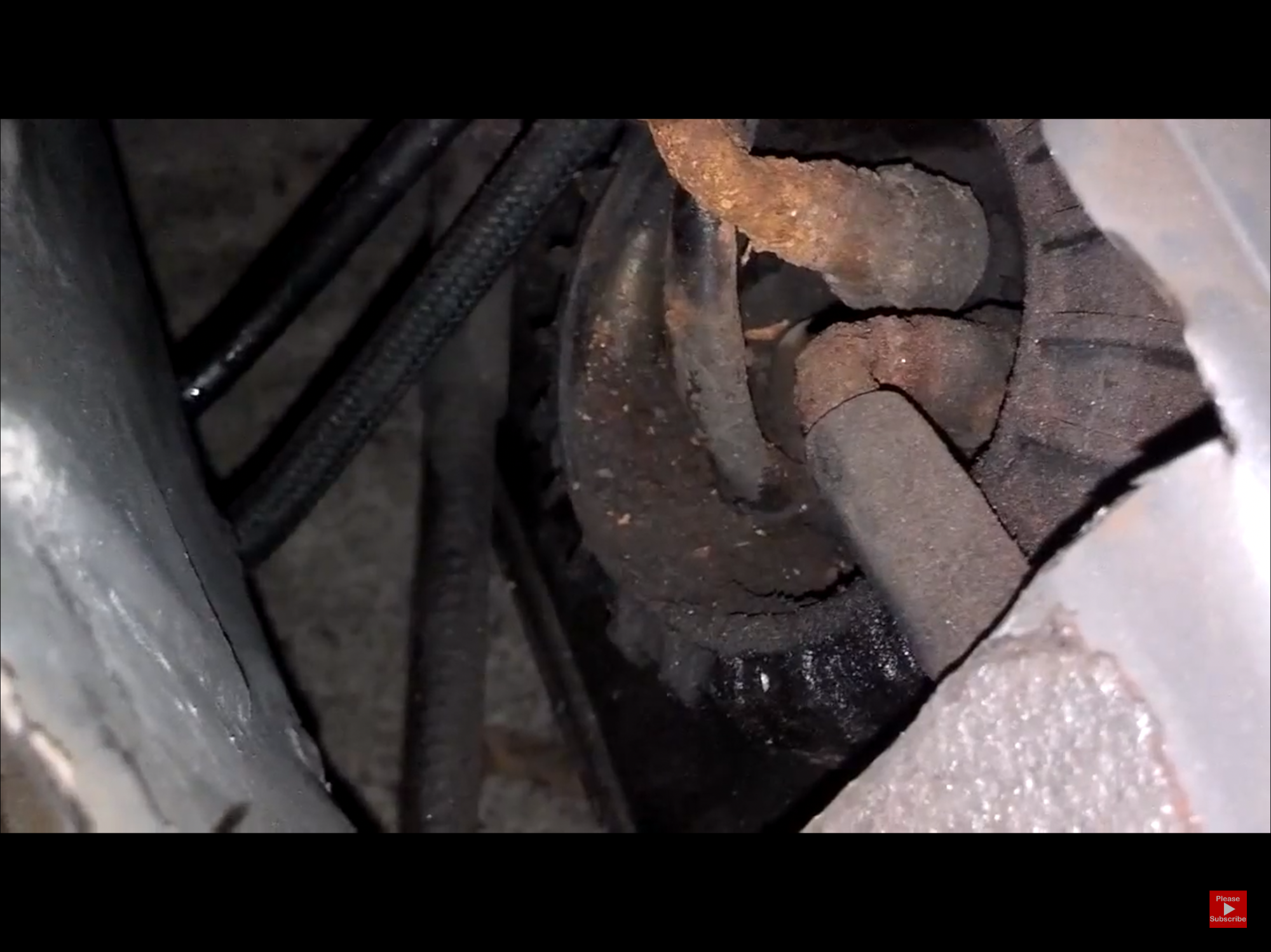

I have replaced 3 tank pumps on Gen 1 XC70's lately and I do a partial drop of tank without lowering suspension.
You remove the RH trailing arm with its forward bracket, disconnect driveshaft from VC, take VC together with its housing off the rear diff (mark the flange so it can be put back where found), remove access cover and undo the connectors, and then take off straps and let RH side of tank down. Oh, take off the exhaust pipe from catalyst to the muffler pipe over LH wheel driveshaft.
No need to cut hole in floor, wire routing is easy, and tank is down far enough for sending unit to go in and out with no trouble.
The VC flange has 6 8mm inhex bolts and the housing is held to diff with four 14mm head bolts.
The hardest part of the whole job is getting the fittings to unlatch on the sender. I used a tool meant to depress the collar on those fittings and bent it to work down in the hole but it still was a pain.

Wow! That is even easier than the video I was trying to find. Other than the removal of the muffler and VC unit that is not too bad. Easier than on a wagon too as you don't have to remove the trunk area flooring panels to get to the cover plate.
When undoing the bolts on the VC unit to the rear diff, I used a long extension rod to get to the bolts both for undoing and torquing them back up.

I’ll be partial tank dropping Monday night. I’ll take pictures on the S70 to documemt
