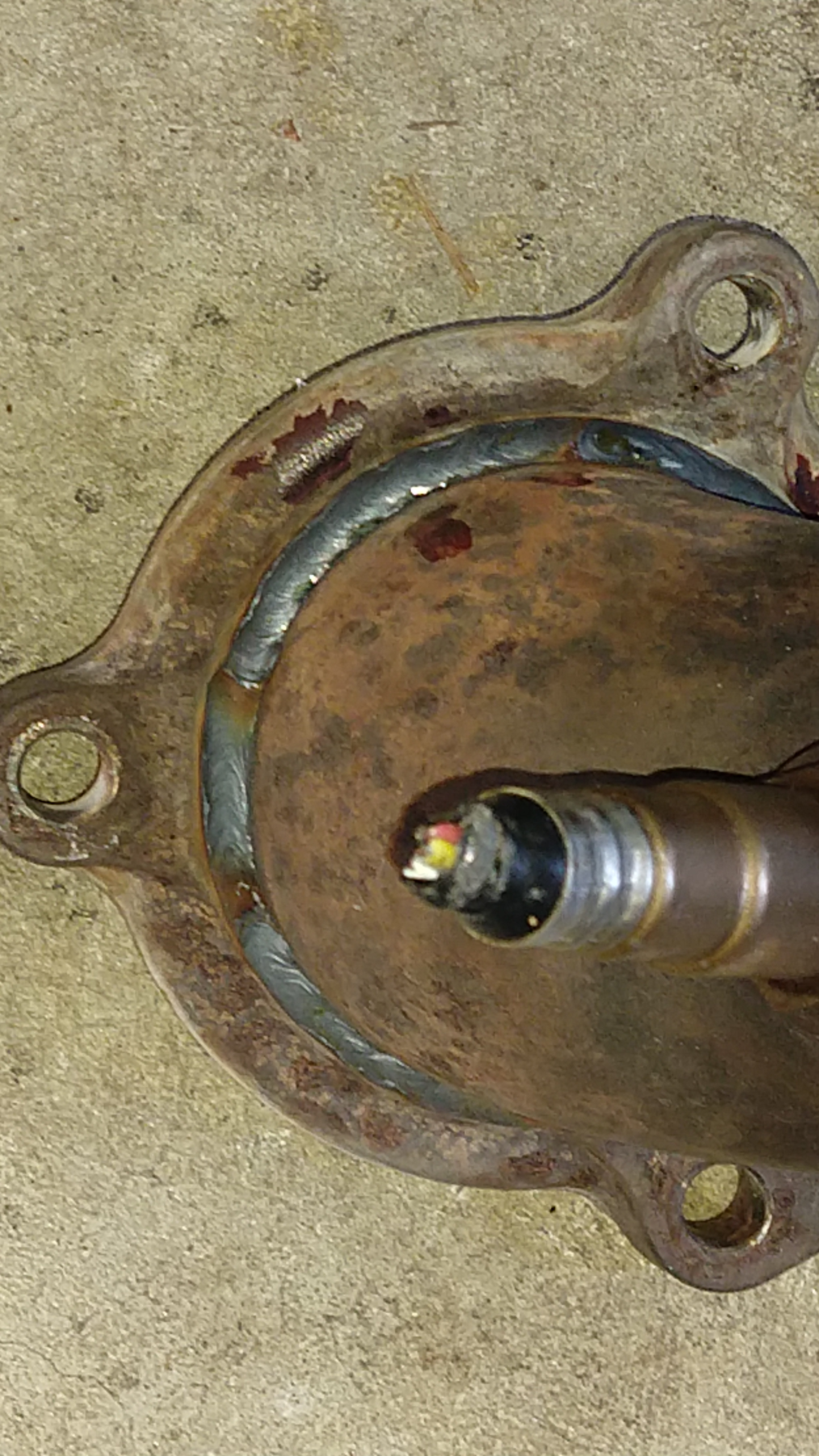

Reviving old Post, but good to know that it CAN be welded, the cat pipe just blew off the flange at the squirrel cage.
Thought I heard a slight rattle, full throttle blast identified the issue!
tombrisk
Posts: 33
Joined: 9 June 2020
Year and Model: 2000 V70XC AWD
Location: WoodyVille Wa USA
Has thanked: 5 times
Been thanked: 1 time
Post by tombrisk »
Muffler King to the rescue! :-)
I indexed them with a touch-up paint brush
Better weld than I could ever do.
$50 weld, new O2 sensors on the way = quiet car back on the road!

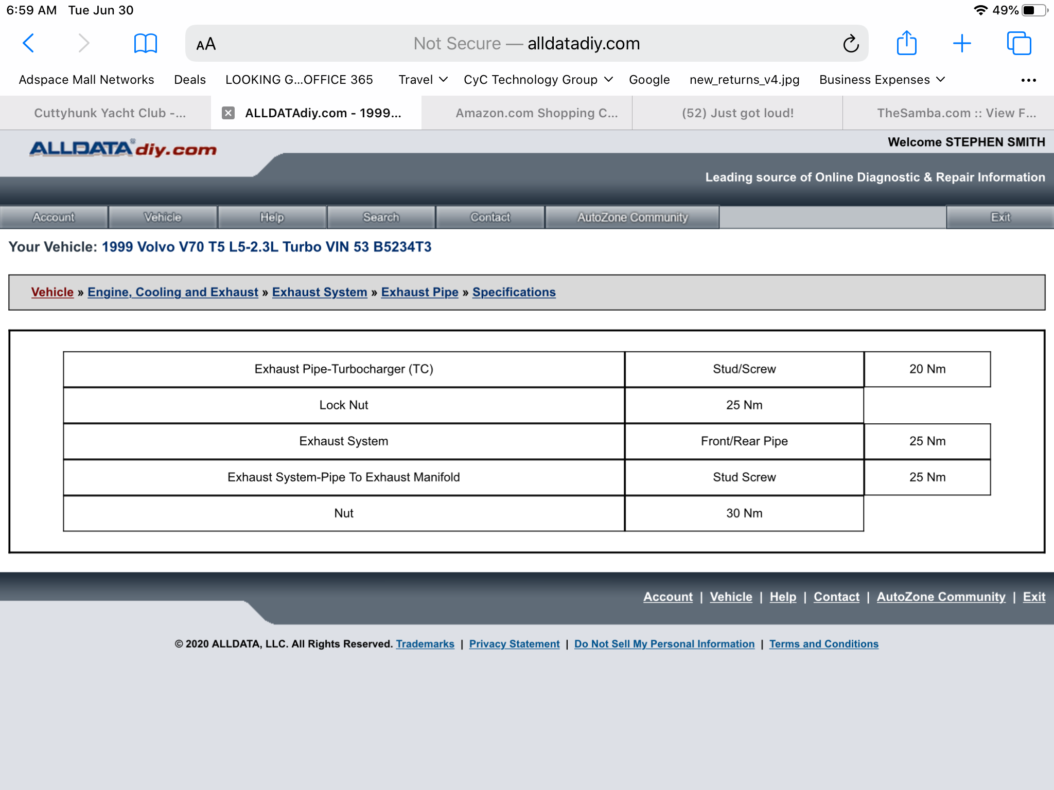

Hoping someone has the torque spec to remount my V70 cat back on to the turbo? The studs are out, I'll thread them back in, but I'd prefer to not have to get back down there
Thanks for tips
tombrisk
Posts: 33
Joined: 9 June 2020
Post by tombrisk »

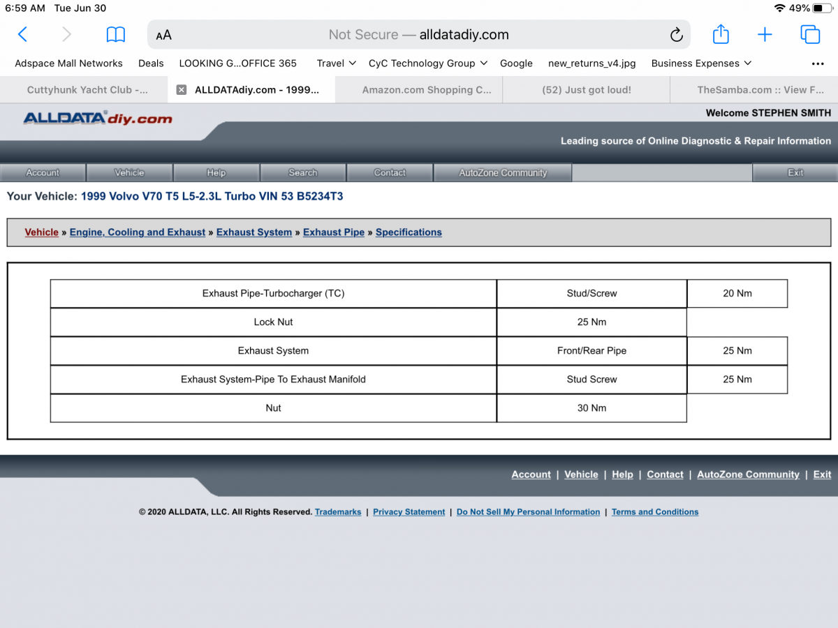

I've ordered book(s), but could one kind board member supply the torque for the turbo to cat flange torque, please?
Guessing between 31-49 per a generic chart
Screenshot
Screenshot
Posts: 35268
Has thanked: 1497 times
Been thanked: 3810 times
A bit less.
20 Nm for the studs, 25 Nm for the nuts
Use new hardware for exhaust please, it’s the classy thing to do for the next gal/ guy.
